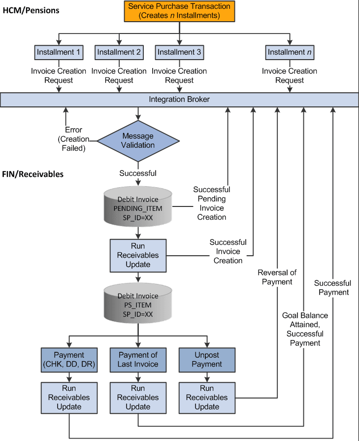

The Pension Administration application first creates a Service Purchase transaction. Each Service Purchase transaction has a unique ID (SP_ID) and a set of installments is created for this transaction. Each installment triggers a message in Integration Broker, which creates a single pending invoice in PeopleSoft Receivables. This means that one Service Purchase transaction consists of a set of Receivables items.

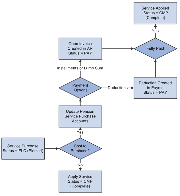

The following diagram illustrates the regular life cycle of a Service Purchase transaction:
Regular Life Cycle of a Service Purchase transaction

The following diagram illustrates the integration flow between Receivables and HCM.
