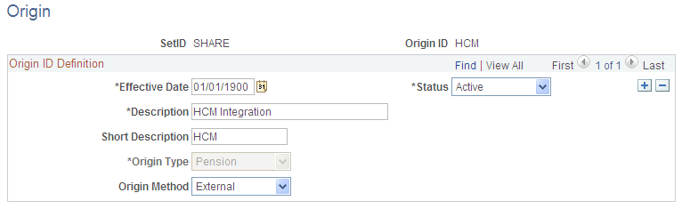

Setting Up an Origin ID for Service Purchase Transactions
Use the Origin page (ORIGIN_TABLE1) to define group origin IDs.
Navigation:
  • Set Up Financials/Supply Chain, and then Product Related, and then Receivables, and then Options, and then Billing Origin Set, and then Origin
  • Set Up Financials/Supply Chain, and then Product Related, and then Billing, and then Setup, and then Establish Billing Origin, and then Origin
See the documentation for the Origin Page.
This example illustrates the fields and controls on the Origin page for integration with HCM.
To create an origin ID to be used for integration with Pension Administration, use the following values:
  • Origin Type = Pension
  • Origin Method = External
