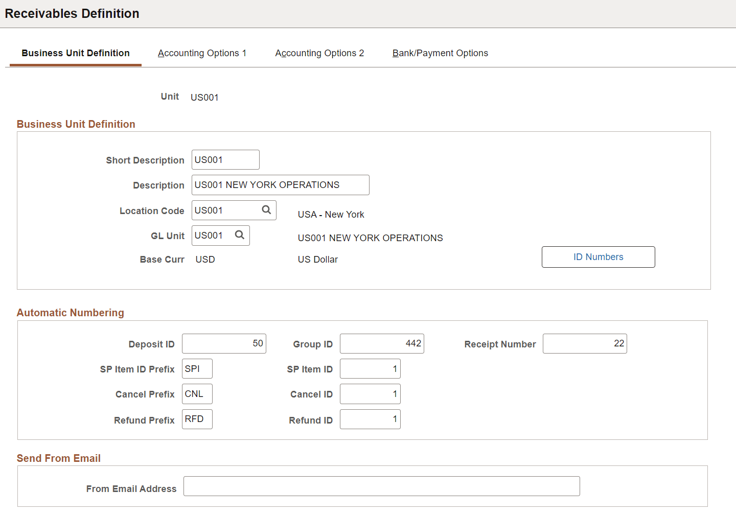

This example illustrates the fields and controls on the Business Unit Definition page.
Receivables Definition - Business Unit Definition page
Field or Control Description
Default SetID
Enter the value of an existing business unit whose SetID you want to copy, or enter a new business unit ID to establish a new generic SetID that has the same name as the business unit that you are adding.
Create BU (create business unit)
Click to create the receivables business unit and SetID.
Automatic Numbering
Deposit ID
Enter a deposit ID.
Group ID
Enter a group ID.
Receipt Number
Enter a receipt number.
SP Item ID Prefix, Cancel Prefix, and Refund Prefix
Enter prefixes for the Service Purchase (SP) invoices created by PeopleSoft Pension Administration. The system uses the following prefixes to identify items when they are displayed in one of the Worksheets:
  • SP Item ID Prefix = SPI
  • Cancel Prefix = CNL
  • Refund Prefix = RFD
SP Item ID, Cancel ID, and Refund ID
Enter 1 for the initial value.
Send From Email
From Email Address
Enter an email address to override the default system address when Override Send From Email is selected at Installation Options Receivables page. See Application Fundamentals: Installation Options - Receivables Page.
When a dunning letter or statement is associated with a single business unit, this email address is used as sender email address. If no email address is specified here, From Email Address specified at the Receivables Option level is used as sender email. If no email address is specified at the Receivables Option level, the default system email address is used as sender email address.
