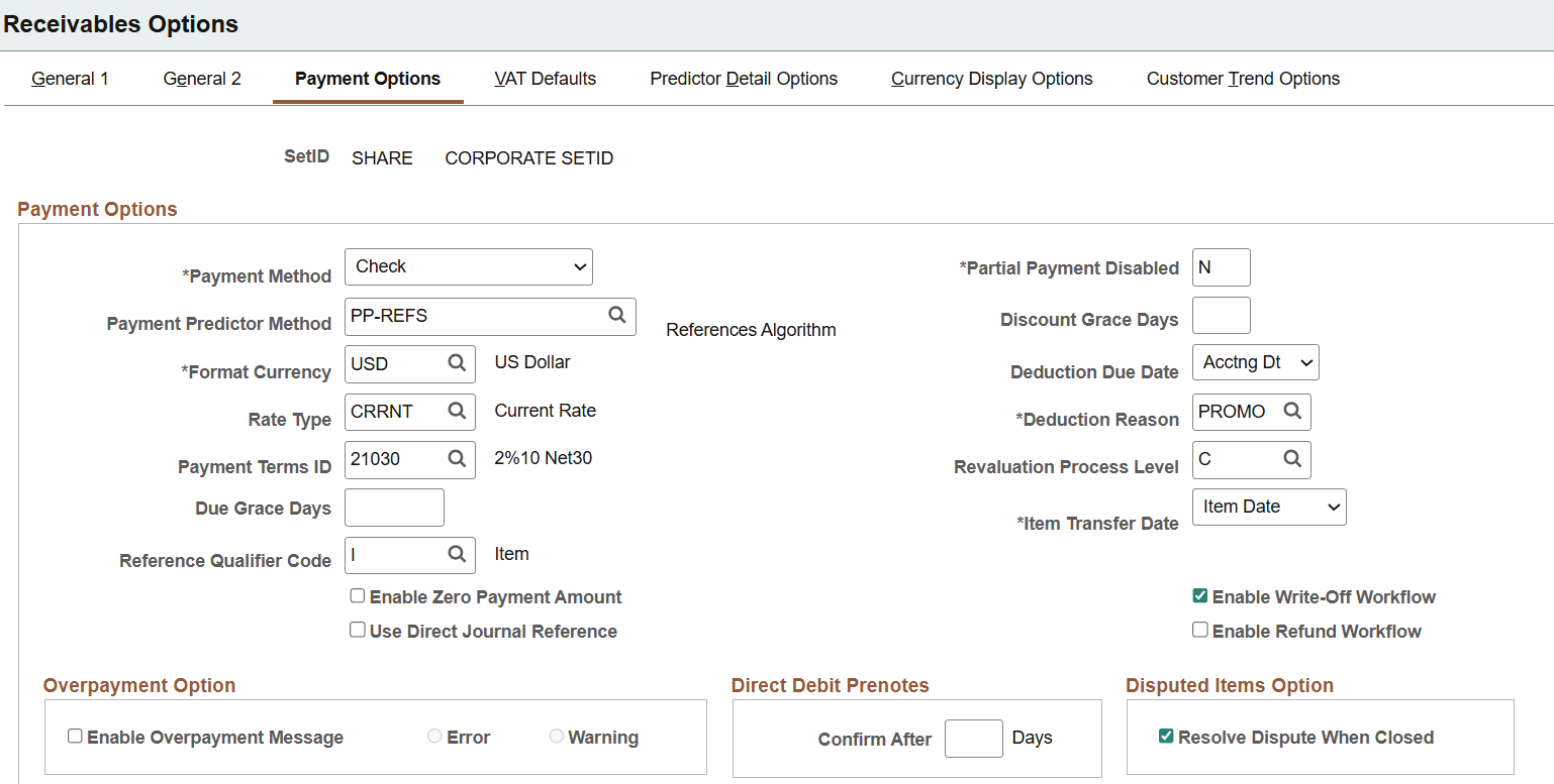

Receivables Options - Payment Options Page
BUS_UNIT_OPT_AR2
Define defaults for payment processing, grace days, deduction dates, revaluation, and worksheets.

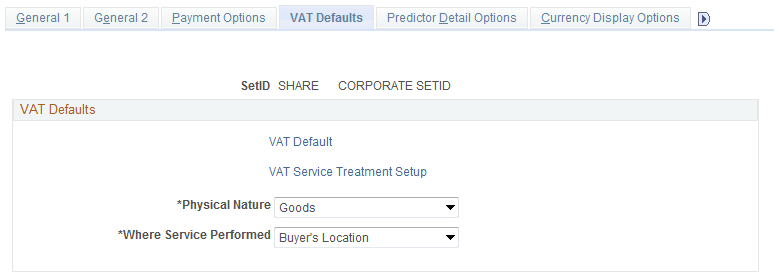

Receivables Options - VAT Defaults Page
BUS_UNIT_OPT_AR5
Define the defaults for VAT processing.

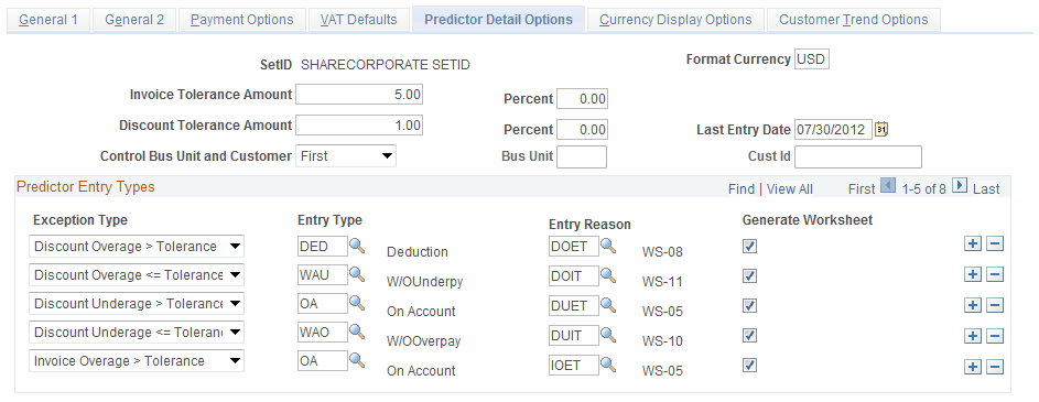

Receivable Options - Predictor Detail Options Page
BUS_UNIT_OPT_AR6
Define the maximum write-off amounts and discount tolerances for the #DTL_TLR algorithm group.
Specify the default entry type and reason that the Payment Predictor process (ARPREDCT) uses to create accounting entries for partial payments and discounts when it executes the algorithm group.

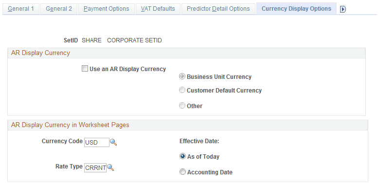

Receivables Options - Currency Display Options Page
BUS_UNIT_OPT_AR7
Specify the default currency that appears on some of the inquiry pages, the maintenance and transfer worksheets, and the run control pages for dunning letters and statements.

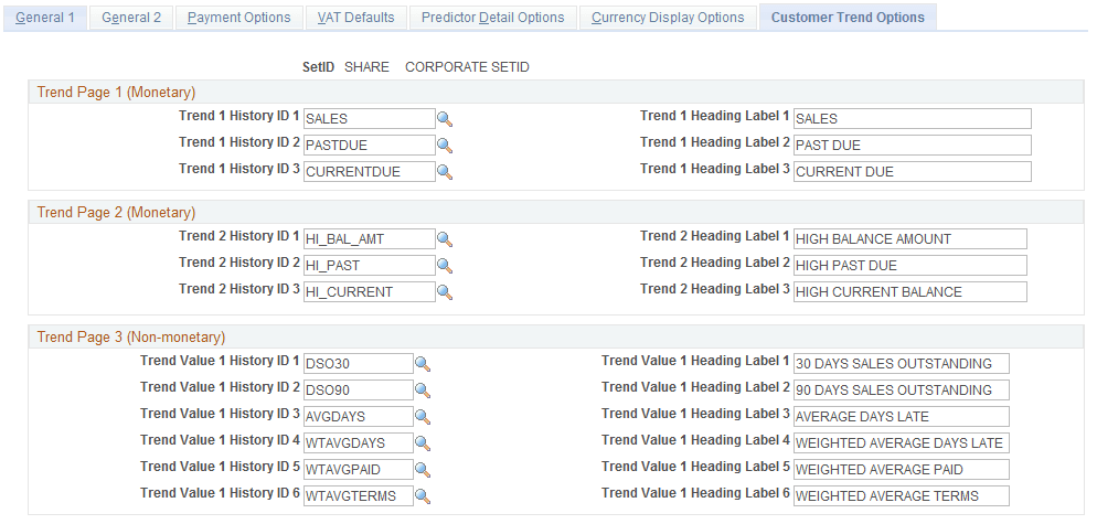

Receivables Options - Customer Trend Options Page
BUS_UNIT_OPT_AR8
Define the historical statistics that you want to appear on the Customer Trend 1 page, Customer Trend 2 page, and Customer Trend 3 page.

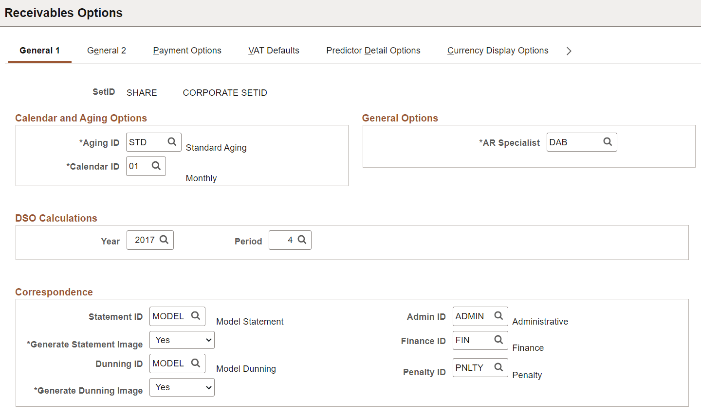

Receivables Options - General 1 Page
Use the Receivables Options - General 1 page (BUS_UNIT_OPT_AR1) to define history options, aging options, correspondence information, Intra-Governmental Payment and Collection (IPAC) Systems information, write-off tolerances for customer account maintenance, and other general information.
Navigation:
Set Up Financials/Supply Chain, and then Business Unit Related, and then Receivables, and then Receivables Options, and then General 1
This example illustrates the fields and controls on the Receivables Options - General 1 page (1 of 2). You can find definitions for the fields and controls later on this page.
This example illustrates the fields and controls on the Receivables Options - General 1 page (2 of 2). You can find definitions for the fields and controls later on this page.
Calendar and Aging Options
Field or Control Description
Aging ID
Select an aging ID that you set up on the Aging page. The Aging Application Engine process (AR_AGING) uses this identifier for the aging rules for all business units associated with the TableSet.
Calendar ID
Select the calendar ID used to perform history calculations. You define the calendars on the Calendar Periods page.

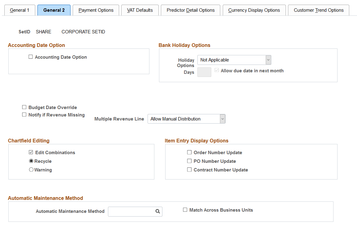

Receivables Options - General 2 Page
Use the Receivables Options - General 2 page (BUS_UNIT_OPT_AR3) to enter options for payment interfaces, commitment control accounting, and ChartField combination editing.
Navigation:
Set Up Financials/Supply Chain, and then Business Unit Related, and then Receivables, and then Receivables Options, and then General 2
This example illustrates the fields and controls on the Receivables Options - General 2 page. You can find definitions for the fields and controls later on this page.
Edit Combinations
Select to enable ChartField combination editing for business units with this SetID and select one of two methods for handling errors.
Recycle
Select to display an error message for accounting entries that you create online. You can save the accounting entries, but you cannot post them until you correct the errors or fix the combination edit rule on the Rule Definition page. The system changes the posting action for the group to Do Not Post and sets the edit status to Error. If you generate accounting entries by running the Receivables Update process, the process creates an entry in the message log. You must use the error correction pages to correct the errors before you can post them.
Warning
Select to display a warning message for accounting entries that you create online. You can choose whether to correct the accounting entries or to post them without correction. The Receivables Update process adds a warning message to the message log for batch accounting entries and posts the group.
See Application Fundamentals: Understanding ChartField Combination Editing.
Item Entry Display Options
Order Number Update, PO Number Update (purchase order number update), and Contract Number Update
Select to enable users to update the Order Number, Purchase Order, and Contract Number fields on the View/Update Item Details - Detail 2 page.
Note:You can update these fields only if you are working with Item Entry Type transactions that are typically interfaced from external billing systems. You cannot update these fields for other transactions.
Automatic Maintenance Method
Select the automatic maintenance method containing the rules that you want to use by default to match items when you run the Automatic Maintenance Application Engine process (AR_AUTOMNT). You can override the method for individual run controls if needed.
Match Across Business Units
Select the check box if you want the Automatic Maintenance Application Engine process (AR_AUTOMNT) to match items across multiple business units entered on the Automatic Maintenance run control page (Accounts Receivable, Receivables Maintenance, Automatic Maintenance, Request Automatic Maintenance). The Match Across Business Units check box is deselected by default. If the check box is deselected, the process matches items within each of the business units entered on the run control page.

Use the Receivables Options - Payment Options page (BUS_UNIT_OPT_AR2) to define defaults for payment processing, grace days, deduction dates, revaluation, and worksheets.
Navigation:
Set Up Financials/Supply Chain, and then Business Unit Related, and then Receivables, and then Receivables Options, and then Payment Options
This example illustrates the fields and controls on the Receivables Options - Payment Options (1 of 2) page. You can find definitions for the fields and controls later on this page.
This example illustrates the fields and controls on the Receivables Options - Payment Options (2 of 2) page. You can find definitions for the fields and controls later on this page.
Payment Method
Select the default payment method for items. Options are: Check, Credit Card, Direct Debit, Draft, Electronic Funds Transfer, or Giro - EFT.
Override the value for individual customers, items or payments.
Note: If you receive payments using a payment interface, such as an electronic data interchange (EDI), lockbox, or bank statement, select Check or Electronic Funds Transfer. If you receive electronic payments for acceptgiro attachments, select Giro - EFT.
Payment Predictor Method
Select the method that the Payment Predictor process uses if you do not specify a method at the customer level. The payment predictor method defines the rules that the process uses to apply payments and to make adjustments such as write-off items.
See Defining Payment Predictor Methods.
If you want to use Payment Predictor to apply all payments from a particular bank account, select the Payment Predictor check box on the External Accounts - Account Information page. Override this default, and select or deselect Payment Predictor for individual payments, using the deposit entry pages.
Format Currency
Select the default currency that the system uses for receivables processing.
Rate Type
Select the exchange rate type that the system uses to perform currency conversion. Override the default at the customer level or when you enter pending items, enter deposits, create maintenance worksheets, or create customer-initiated drafts.
Payment Terms ID
Select the default payment terms for the business unit. Override the default at the customer level or when you enter pending items. Define payment terms on the Payment Terms page. The payment terms determine the item due date and discount information.
Due Grace Days
Enter the number of days beyond the due date that a customer can pay without the payment being considered late. The Overdue Charges Application Engine process (AR_OVRDUE) uses due grace days to determine whether an item is overdue. If the item's due date is May 1, 2003 and you run the process on May 2, 2003, the process does not create an overdue charge if you enter 5 for the due grace days. However, after the grace days pass, the system calculates overdue charges from the item's due date. The Aging process uses grace days to determine in which aging category to place an item. For example, you enter 5 days and an item is 22 days old. You have aging categories for 10, 20, and 30 days. The item would be in the aging category for 10 days, because the system subtracts five days from the age.
Item Transfer Date
Select the option that the system uses to determine the accounting date for transfer activities when you transfer items from one customer to another. Options are:
  • Item Date: The accounting date of the original item.
  • System: The current system date.
Reference Qualifier Code
Select the type of remittance information generally provided by customers, such as document, item, or bill of lading. This is the default value for identifying items to include in the payment, draft, maintenance, and transfer worksheets. You can override the value at the customer level.
Enable Zero Payment Amount
Select this option to allow deposits with zero payment amounts. This option is deselected by default.
You can only save the deposit with zero amount payments if this option is selected, otherwise the system returns an error message indicating that payments with zero amounts are not allowed.
Use Direct Journal Reference
Select this option to allow users to enter document reference information for a directly journaled payment on the Regular Deposit - Payments page.
See: Regular Deposit - Payments Page
Partial Payment Disabled
Enter a value that determines whether you can modify the amount on the payment worksheet to create a partial payment. The default is N, which enables users to create partial payments. Enter Y if you do not want users to create partial payments.
Discount Grace Days
Enter the number of days beyond the discount date that a customer is still eligible for an earned discount. Payment worksheets, express deposits, and the Payment Predictor process use discount grace days to calculate discounts.
Override the due grace days and discount grace days for a customer on the Bill To Options page and for individual items during pending item entry or item maintenance.
Deduction Due Date
Select the type of date that the system uses to determine the due date of the new item created for a referenced deduction. Select Acctng Dt (accounting date) if the due date is to be the accounting date of the payment. Select Item Dt (item date) to carry over the original item due date.
Deduction Reason
Select the default deduction reason to assign to new deductions that the Payment Predictor process or payment and draft worksheet create. Users can override the reason when they create the deduction on the payment worksheet or on the View/Update Item Details - Detail 1 page. Use a generic reason as the default reason and override it as needed.
Note: You can also create unique deduction reasons for each entry reason for the Deduction entry type. If you do this, the system assigns the appropriate deduction reasons for deductions that you create on the payment or draft worksheet.
See Understanding Exception Reasons and Collection Codes.

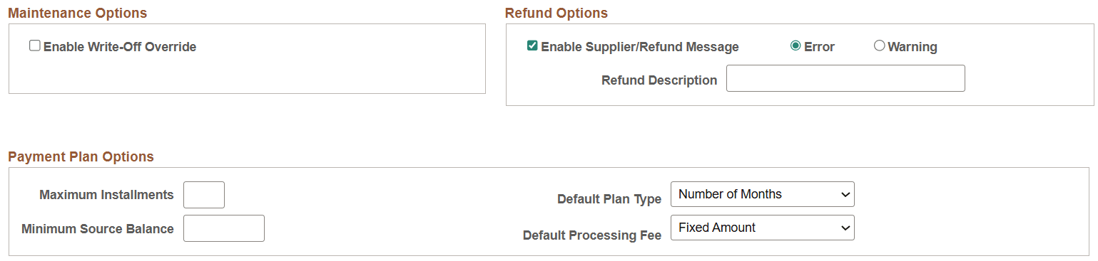

Enable Supplier/ Refund Message
Select to display a message for missing supplier/AP integration setup.
You can chose the message to be an Error or a Warning. If Error is selected, an error will be issued on the worksheet and you cannot proceed with the refund transaction. If Warning is selected, you can proceed with the refund after viewing the warning message.
Note: If single payment supplier is enabled on the AR business unit definition, no message is displayed for missing supplier information.
Refund Description
Enter a description that can be populated as the default voucher description in Payables vouchers. The refund description can indicate why the voucher was created (for example, a refund in Receivables).
Maximum Installments
Enter the maximum number of payment plan installments allowed for the business unit.
See:
PeopleSoft Order to Cash Common Information: Creating Payment Plans
PeopleSoft Order to Cash Common Information: Payment Plan Page
Default Plan Type
Select a default payment plan type for the business unit.
Values are:
  • Custom - Creates a custom payment plan based on flexible user-defined installment amounts or a percentage of the total amount due.
  • Fixed Monthly Amounts - Creates a payment plan based on a fixed monthly amount.
  • Number of Months - Creates a payment plan based on a set number of months.
Minimum Source Balance
Enter the minimum source balance required to create a payment plan.
Default Processing Fee
Select a default processing fee for the business unit. Values are Fixed Amount or Percentage of Plan Balance.
Use the Receivables Options - VAT Defaults page (BUS_UNIT_OPT_AR5) to define the defaults for VAT (value-added tax) processing.
Navigation:
Set Up Financials/Supply Chain, and then Business Unit Related, and then Receivables, and then Receivables Options, and then VAT Defaults
This example illustrates the fields and controls on the Receivables Options - VAT Defaults page. You can find definitions for the fields and controls later on this page.
VAT Default
Click this link to access the VAT Defaults Setup page.
The VAT Defaults Setup page is a common page used to set up VAT defaulting for all PeopleSoft applications processing VAT transactions. On this page you can define PeopleSoft Receivables VAT business unit defaults as applicable.
Use the VAT Defaults Setup page to identify this PeopleSoft Receivables business unit as subject to the domestic reverse charge provision by selecting Yes in the Domestic Reverse Charge field. In addition, use the Domestic Reverse Charge Sales field to enter a VAT Transaction Type code and enter a value in the VAT Driver field. The domestic reverse charge fields are displayed on various receivable transactions for pending item entry, draft entry, and payment entry.
See Domestic Reverse Charge Goods VAT.
VAT Service Treatment Setup
Click to access the Services VAT Treatment Defaults Setup page.
The Services VAT Treatment Defaults Setup page is a common page used to set up VAT services treatment defaults for all PeopleSoft applications processing VAT transactions. If you are required to implement special handling for services, you can specify PeopleSoft Receivables VAT service treatment defaults on this page as applicable.
When defining service VAT treatment defaults for a specific service, you specify the defaults applicable to that service. When defining defaults for a driver higher in the hierarchy, such as a supplier, customer, or business unit, you specify the defaults that apply to the services most often supplied by or for that driver.
The VAT Defaults Setup and Services VAT Treatment Defaults Setup pages are described in detail in the PeopleSoft Global Options and Reportsdocumentation.
Physical Nature
Select the default physical nature for transactions. Options are: Physical Goods or Intangible/Services.
Where Service Performed
Select the default location for where a service is most often physically performed. Options are: Buyer's Location, Ship From Location, Ship To Location, or Supplier's Location.

Use the Receivable Options - Predictor Detail Options page (BUS_UNIT_OPT_AR6) to define the maximum write-off amounts and discount tolerances for the #DTL_TLR algorithm group.
Navigation:
Set Up Financials/Supply Chain, and then Business Unit Related, and then Receivables, and then Receivables Options, and then Predictor Detail Options
This example illustrates the fields and controls on the Receivables Options - Predictor Detail Options page. You can find definitions for the fields and controls later on this page.
The Payment Predictor process uses the tolerances that you specify to write off or adjust an underpayment or overpayment or to adjust the discount amount when you run a payment predictor method that executes the #DTL_TLR or #DTL_TPM algorithm groups. The system uses these tolerances for underpayments to determine whether to write off or adjust the balance, or make a partial payment if the Partial Payment Switch check box on the Bill To Options page for the customer is selected. If you deselect the Partial Payment Switch check box, it only uses the tolerances to determine whether to write off or adjust the balance. The tolerances apply to individual items not to all invoices paid by the payment.
Invoice Tolerance Amount
Enter the maximum amount of an underpayment or overpayment that the Payment Predictor process can write off. The Payment Predictor process can write off an amount below the invoice tolerance amount if it does not exceed the percentage of the payment or item.
For example, suppose that you receive a payment of 1,000.00 EUR. You enter 25.00 EUR for the invoice tolerance amount, and you enter .01 in the Percent field. The Payment Predictor process applies the payment to a 1,023.00 EUR item. It does not write off the remaining amount of the item because 23.00 EUR is larger than 1 percent of the 1,023.00 EUR item.
Note: The currency is the format currency that you entered on the Payment Options page.
Percent
Enter the maximum percentage to write off. You can use decimals in the percentage. If you enter .25 this equals .0025. If you enter 1.00 this equals 1 percent.
Discount Tolerance Amount
Enter the maximum amount of an unearned discount that the Payment Predictor process can take.
To take unearned discounts, users must select the Disc field on the Detail Reference Information page for the payment and enter the discount amount.
Note:The currency is the format currency that you enter on the Payment Options page.
Percent
Enter the maximum percentage that the Payment Predictor process can add to the payment terms. You can use decimals in the percentage. If you enter .25 this equals .0025. If you enter 1.00 this equals 1 percent.
Last Entry Date
Displays the date on which the page was last changed.
Control Bus Unit and Customer (control business unit and customer)
Click the down arrow to display these values:
  • First
    Selecting this value creates WS-06 or WS-07 items for the first business unit and customer ID in the list of items being paid, which is ordered by customer ID.
  • Last
    Selecting this value creates WS-06 or WS-07 for the last business unit and customer ID in the list of items being paid, which is ordered by customer ID.
  • Specify
    When you select this value, you must enter or select a value for each of these fields:
    • A specific control business unit.
    • A specific customer ID.
      If all of the items being paid for in a payment apply to the same business unit and customer, then the system creates adjustment items for that business unit and customer. However, if the items apply to multiple business units or multiple customers, then the system creates adjustment items for the business unit and customer that you specify in these two fields.
Assigning Default Entry Types and Reasons
Enter the entry type and entry reason codes that you want to use to override the defaults for the system function. The following table provides a list of conditions that are in the Exception Type field and the default system function that the Payment Predictor process uses for the condition. It also provides other system functions that you can use for the exception type and the entry type and reason to enter if you want the Payment Predictor process to use that system function.
Condition Default System Function PossibleSystem Functions Entry Type and Reason
Invoice amount or percent overage within tolerance
WS-10 (Write-off an Overpayment)
WS-09 (Write-off an Item)
WS-06 (Adjust Remaining Overpayment)
WO and IOIT
AO and IOIT
WAO and IOIT
Invoice amount or percent overage exceeds tolerance
WS-05 (Place Amount on Account)
WS-04 (Prepay an Item)
OA and IOET
PR and IOET
AO and IOET
Invoice amount or percent underage within tolerance
WS-11 (Write-off an Underpayment)
WS-07 (Adjust Remaining Underpayment)
WO and IUIT
AU and IUIT
WAU and IUIT
Invoice amount or percent underage exceeds tolerance
WS-08 (Create a Deduction)
DED and IUET
Discount amount or percent overage within tolerance
WO and DOIT
AU and DOIT
WAU and DOIT
Discount amount or percent overage exceeds tolerance
DED and DOET
Discount amount or percent underage within tolerance
WO and DUIT
AO and DUIT
WAU and DUIT
Discount amount or percent underage exceeds tolerance
OA and DUET
PR and DUET
AO and DUET
Select Generate Worksheet on this page and in payment predictor methods where you use the #DTL_TLR algorithm group to generate a worksheet when the condition occurs. This enables you to review the payment application before you post it.
If VAT is enabled at BU Level, then WS-11 (Write-off an Underpayment) serving as default system function cannot be used. The only possible system functions which can be used if VAT is enabled at the BU level are WS-09 (Write-off an Item) and WS-07(Adjust Remaining Underpayment).
Use the Receivables Options - Currency Display Options page (BUS_UNIT_OPT_AR7) to specify the default currency that appears on the Collections Workbench and some of the inquiry pages, the maintenance and transfer worksheets, and the run control pages for dunning letters and statements.
Navigation:
Set Up Financials/Supply Chain, and then Business Unit Related, and then Receivables, and then Receivables Options, and then Currency Display Options
This example illustrates the fields and controls on the Receivables Options - Currency Display Options page. You can find definitions for the fields and controls later on this page.
AR Display Currency
Use an AR Display Currency
Select to enable the associated currency options. Use these options to determine which currency transaction and balance amounts appear in the PeopleSoft Receivables inquiry pages, and to determine the default currency that appears on the run control pages for statements and dunning letter processes. Options are:
Business Unit Currency: The system displays amounts in the format currency for the business unit that you defined on the Receivables Options - Payment Options page, and the system uses the exchange rate type for the business unit to convert the amount. The business unit currency is usually the same as the base currency.
Customer Default Currency: The system displays amounts in the default currency for the customer and uses the exchange rate type for the customer to convert the amount. You define customer currency defaults on the Miscellaneous General Info page for the customer.
Other: The system displays amounts in the currency that you specify, and the system uses the exchange rate type that you specify to convert the amounts. Only this option enables you to change the display currency for inquiry pages and the dunning letter and statement run control pages when you access them.
AR Display Currency in Worksheet Pages
The values that you enter here determine the default values that display on the Currency Conversion page for maintenance, payment, and transfer worksheets. You can override the values at the worksheet level if needed. The values are used to convert the item amounts to a different currency and they display in the Conversion Amount - Currency field if you use the Currency Conversion page to convert them.
Currency Code
Enter the default currency for converting item amounts.
Rate Type
Specify the exchange rate that the system uses to convert currency amounts on worksheets.
Effective Date
Specify whether the conversion date should be the current date (As of Today), or the Accounting Date for the item.
Use the Receivables Options - Customer Trend Options page (BUS_UNIT_OPT_AR8) to define the historical statistics that you want to appear on the Customer Trend 1 page, Customer Trend 2 page, and Customer Trend 3 page.
Navigation:
Set Up Financials/Supply Chain, and then Business Unit Related, and then Receivables, and then Receivables Options, and then Customer Trend Options
This example illustrates the fields and controls on the Receivables Options - Customer Trend Options page. You can find definitions for the fields and controls later on this page.
Enter the history ID that you want to use to calculate the historical data for each of the trend pages along with the heading label that you want to display for the data on the trend pages. You use the trend pages to compare historical data for different history IDs. Enter either system-defined or user-defined history IDs.
The Customer Trend 1 and Customer Trend 2 pages can display up to three historical statistics for history IDs that track amounts, such as High Balance Amount, and the Customer Trend 3 page can display up to six historical statistics for history IDs that track the number of days, such as average days late.
