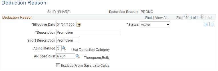

This example illustrates the fields and controls on the Deduction Reason page. You can find definitions for the fields and controls later on this page.
Field or Control Description
Aging Method
The system uses this aging method option only for aging IDs that have the Deduction Aging field set to Vary on the Aging page. This enables you to define aging rules for deductions based on the deduction reason assigned to the item. Options for each deduction reason are:
Age Normally: Select to age items based on the rules assigned to the aging ID.
Use Deduction Category: Select to use the aging category in the Deduction Aging group box on the Aging page for deductions with this deduction reason.
Exclude from Aging: Excludes items with this deduction reason from aging. If you prefer to exclude all deductions from aging regardless of deduction reason, select that option in the Deduction Aging group box on the Aging page.
AR Specialist (receivables specialist)
If you want to assign all deductions with this reason to the same AR specialist, enter the ID for the specialist. If you leave this value blank, the system uses the value for the business unit. If you enter an AR specialist for the customer, that value overrides the value for the deduction reason.
Exclude From Days Late Calcs (exclude from days late calculations)
Select to enable the system to skip items with this deduction reason when it calculates average days late and weighted average days late.
