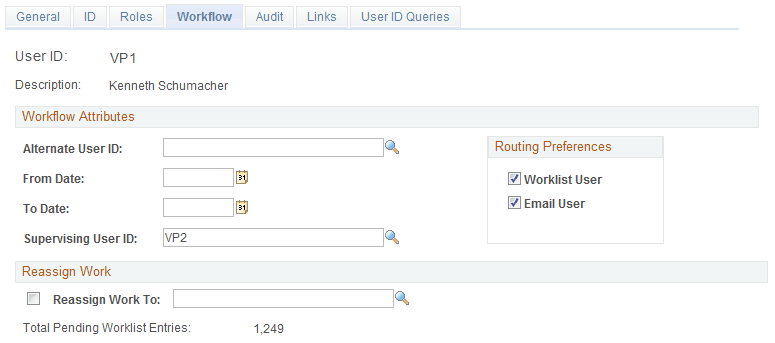

Defining Users Within the Workflow Process
Within the PeopleTools menu, each user is defined with a user ID in the User Profile component. For the approval workflow process, use this component to define the relationship between users entering write-off amounts on a worksheet and the approvers.
For users within PeopleSoft Receivables:
  • Use the User Profiles - Workflow page to define supervisors and worklist users.
  • Use the User Profile-Roles page to enter the roles of the user.
Use the User Profiles - Workflow page (USER_WORKFLOW) to define supervisors and worklist users. Identify the supervisor who should approve the write-off transactions.
Navigation:
PeopleTools, and then Security, and then User Profiles, and then User Profiles, and then Workflow
This example illustrates the fields and controls on the User Profile - Workflow page.
For the requester's user profile, identify the supervisor (Supervising User ID field) who should approve the write-off transactions. The supervisor is important if you are using the SQL definition EOAW_SUPERVISOR_BY_OPRID in the WriteOffApprovers user list. Verify that Worklist User check box and the Email User check box located in the Routing Preferences group box are selected.
For the supervisor's user profile, select both the Worklist User check box and the Email User check box located in the Routing Preferences group box.

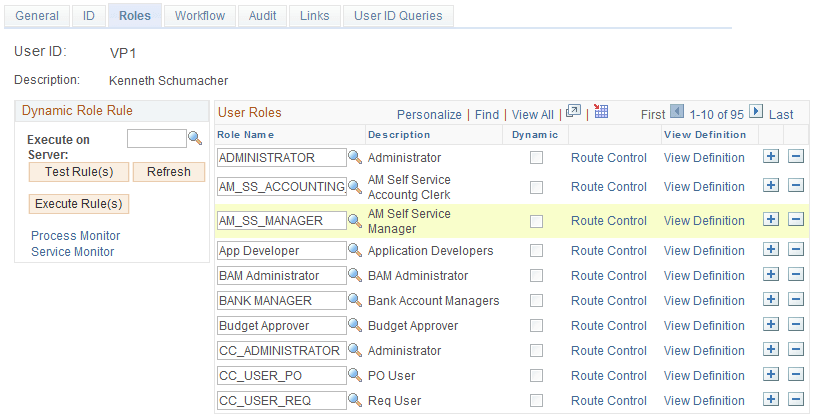

Use the User Profiles - Roles page (USER_ROLES) to attach workflow roles to users. Add the roles with the authority to approve write-off amounts.
Navigation:
PeopleTools, and then Security, and then User Profiles, and then User Profiles, and then Roles
This example illustrates the fields and controls on the User Profile - Roles page.
A role is a class of users who perform the same type of work, such as a collector, credit analysis, AR specialist, or manager. A role describes how people fit into workflow. Roles are defined under PeopleTools, Security, Permissions & Roles, Roles. Roles are important because you define a role on the User List Definition page (Enterprise Components, Approvals, Approvals, User List Setup), and then add the role to each user ID with the authority to approve write-off amounts.

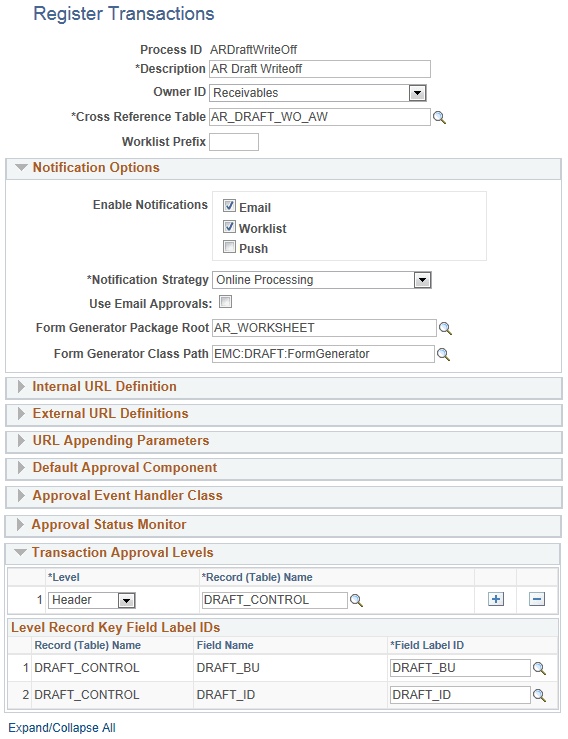

Reviewing the Approval Transaction Registry Within the Approval Framework
Use the Register Transactions page (EOAW_TXN) to register an application with the Approval Framework.
Navigation:
Enterprise Components, and then Approvals, and then Approvals, and then Approval Registry
The Approval Transaction Registry is the interface application used to register an application with the Approval Framework. You use the Register Transactions page to link the components, event handler, records, and classes that you created to the approval process for an application transaction. The main records and components that make up the transaction are registered, along with the approval transaction on which to base the approval process definition. The PeopleSoft Receivables transaction registries are delivered as system data.
Within the transaction registry, the following process IDs have been defined in PeopleSoft system data for AR write-offs:
  • ARDraftWriteOff (AR write-off for the draft worksheet)
    The transaction registry for the process ID ARDraftWriteOff uses the cross-reference table AR_DRAFT_WO_AW and the default approval component of DRAFT_WORKS_IC.
  • ARPaymentWriteOff (AR write-off for the payment worksheet or the credit card worksheet)
    The transaction registry for the process ID ARPaymentWriteOff uses the cross-reference table AR_PAYMENTWO_AW and the default approval component of AR_WF_PAY_WO_XFER.
  • ARMaintWriteOff (AR write-off for the maintenance worksheet)
    The transaction registry for the process ID ARMaintWriteOff uses the cross-reference table AR_MAINT_WO_AW and the default approval component of WS_WORKSHEET_IC.
This example shows the transaction registry for the Receivables draft worksheet write-off process, as defined in PeopleSoft system data:
This example illustrates the fields and controls on the Register Transactions page for Process ID ARDraftWriteOff.
Example of Register Transactions page for AR Draft Write-Off processing
Most of the fields on this page should not to be changed. The exceptions are the following page elements in the notification options that might require modification to fit your notification preferences.
Field or Control Description
Enable Notifications
Determine what type of notifications your company will use. Select at least one channel from these options:
  • Email - Sends an email to the recipients.
  • Worklist - Creates a worklist entry for the recipients. This is the default option if no channels have been selected for the process status.
  • Push - Generates a push notification item in the PeopleSoft Fluid User Interface - Alerts list for the recipient. Push functionality is available as of PeopleTools 8.54.
For information about the push notification framework, see PeopleTools: Fluid User Interface Developer’s Guide, “Working with Push Notification Framework.”
Notification Strategy
Specify whether to allow email to be processed immediately (Online Processing) or offline (Offline Processing) through NEM (Notification and Escalation Manager).
Use Email Approvals
Click to use email approvals with workflow.
See Approval Framework: Setting Up the Transaction Registry.

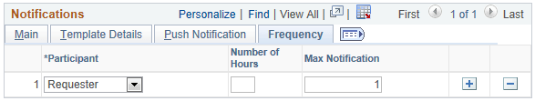

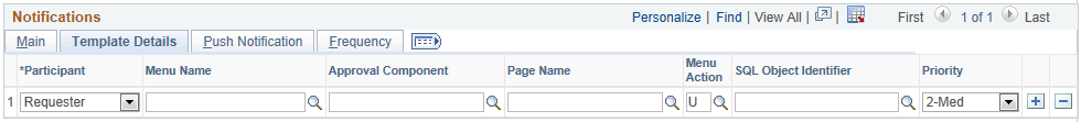

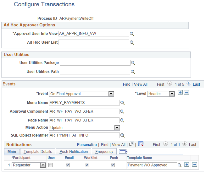

Configuring the Approval Transactions Within the Approval Framework
Use the Configure Transactions page (EOAW_TXN_NOTIFY) to select and define elements that determine what triggers a notification, who receives the notification, and the content of the notification. Notifications are mapped to work with the approval transaction registry and include menus and components and SQL definitions.
The Approval Framework supports email, worklist, and push notifications.
Navigation:
Enterprise Components, and then Approvals, and then Approvals, and then Approval Setup
The Configure Transactions page uses the same process IDs as the Register Transactions page, including the following process IDs for AR write-offs:
  • ARPaymentWriteOff
  • ARDraftWriteOff
  • ARMaintWriteOff
The following example shows the fields and controls on the Configure Transactions page for the ARPaymentWriteOff process ID:
This example illustrates the fields and controls on the Configure Transactions page displaying the Notifications - Main tab, for payment and credit card write-off approvals in Receivables.
Configure Transactions page for write-off approvals (1 of 4)
This example illustrates the fields and controls on the Configure Transactions page displaying the Notifications - Template Details tab, for payment and credit card write-off approvals in Receivables.
Configure Transactions page for write-off approvals (2 of 4)
This example illustrates the fields and controls on the Configure Transactions page displaying the Notifications - Push Notification tab, for payment and credit card write-off approvals in Receivables. Use the Push Notification tab to identify the SQL that retrieves data for display on the push notification alert or approval tab.
Configure Transactions page for write-off approvals (3 of 4)
This example illustrates the fields and controls on the Configure Transactions page displaying the Notifications - Frequency tab, for payment and credit card write-off approvals in Receivables.
Configure Transactions page for write-off approvals (4 of 4)
The table below lists all the delivered Events and Templates tied to each Receivables approval process. A channel value of All indicates email, worklist, and push notifications.
Process ID Event Participant Channel Template
ARPaymentWriteOff
On Final Approval
Requester
All
Payment WO Approved
Push Back
Approvers
All
Payment WO Push Back
On Final Denial
Requester
All
Payment WO Denied
Route for Approval
Approvers
All
Payment WO Approval
Route for Review
Reviewers
All
Payment WO Review
ARDraftWriteOff
On Final Approval
Requester
All
Draft WO Approved
Push Back
Approvers
All
Draft WO Push Back
On Final Denial
Requester
All
Draft WO Denied
Route for Approval
Approvers
All
Draft WO Approval
Route for Review
Reviewers
All
Draft WO Review
ARMaintWriteOff
On Final Approval
Requester
All
Maint WO Approved
Push Back
Approvers
All
Maint WO Push Back
On Final Denial
Requester
All
Maint WO Denied
Route for Approval
Approvers
All
Maint WO Approval
Route for Review
Reviewers
All
Maint WO Review

Perform the following setup steps to enable email approval:
  1. Confirm node properties and connectors of node PSFT_EMC_GETMAIL is correctly setup.
  2. Activate the aforementioned service operations (PeopleTools, Integration Broker, Integration Setup, Service Operations). Confirm that Service Operation Security (link on Service Operation page) is tied to a Permission List with Full Access.
  3. Set the Integration Broker queues to Run (PeopleTools, Integration Broker, Integration Setup, Queues).
  4. Select the Use Email Approvals check box on the Register Transactions page.
  5. Provide the Email Approval User List on the Configure Transaction page. PeopleSoft Receivables delivers email approval user list ARWriteOffApprovers. This user list is tied to the new delivered Role Receivables Writeoff Approvers. You add this new role to the users who will approve write-off transactions directly on the email.
  6. Schedule the PeopleSoft Application Engine program EOAWEMC to read and process email approvals.
