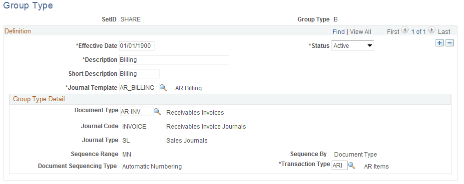

Group Type Page
Use the Group Type page (GROUP_TYPE_TABLE) to set up new group types.
Assign each group type a journal template to create journal entries and a document type if you use document sequencing.
Navigation:
Set Up Financials/Supply Chain, and then Product Related, and then Receivables, and then Options, and then Group Type, and then Group Type
This example illustrates the fields and controls on the Group Type page. You can find definitions for the fields and controls later on this page.
Group Type page
Field or Control Description
Journal Template
Select the journal template to use to create journals for your general ledger. Templates summarize your receivables accounting entries and determine the journal header, date options, and other characteristics. If you plan to generate only one format of journal entry from PeopleSoft Receivables, you can set up a single journal template and associate it with each group type. You can have a different journal format for each group type.
Document Type
Select a document type if you are using document sequencing.
Transaction Type
You can vary the opening and closing period for a receivables business unit for specific types of transactions from the periods for the general ledger business unit that is associated with the receivables business unit. Select the transaction type to associate with items created for the group type. Values are:
ARD (AR direct journals): Use for direct journal payments.
ARI (AR items): Use for overdue charge and billing groups.
ARM (AR maintenance): Use for maintenance and transfer groups.
ARP (AR payments): Use for payment, draft, and direct debit groups.
ARU (AR unpost): Use for unpost groups.
DEF (default): Use when you want to use the default opening and closing periods for the business units and do not want unique periods for the group type.

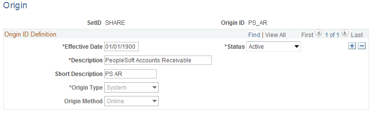

Origin Page
Use the Origin page (ORIGIN_TABLE1) to define group origin IDs.
Navigation:
  • Set Up Financials/Supply Chain, and then Product Related, and then Receivables, and then Options, and then Billing Origin Set, and then Origin
  • Set Up Financials/Supply Chain, and then Product Related, and then Billing, and then Setup, and then Establish Billing Origin, and then Origin
This example illustrates the fields and controls on the Origin page. You can find definitions for the fields and controls later on this page.
Origin page
Origin Type
Select an origin type. Values are:
Billing - When you enter a billing group, the origin represents the source of the group, such as a particular billing system. Billing groups can be brought into the system online or through an external interface. If you plan to enter billing information online, as well as bring it into the system through an interface, you must establish a minimum of two billing origins. Also, use Billing for item interfaces from PeopleSoft Purchasing and PeopleSoft Order Management.
Pension - Use Pension for integration with PeopleSoft Pension Administration.
System: System groups are created in the background during processing. They include Payment, Maintenance, Transfer, Overdue Charge, Drafts, and Unpost. The system assigns an origin ID of PS_AR to such groups. You must establish this origin ID, and it must be named PS_AR.
Origin Method
Indicates whether you enter the group online or receive it from an external source, such as items coming from a billing, purchasing, or order management interface.
For integration with HCM and PeopleSoft Pension Administration, select External.
Important:
You cannot change an origin type after you save it.
