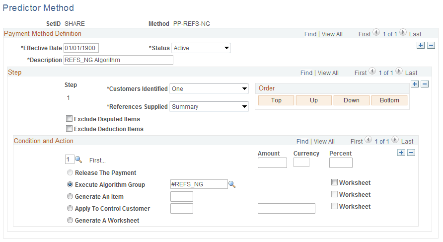

Predictor Method Page
Use the Predictor Method page (PP_METHODS_TABLE) to define a payment predictor method.
Navigation:
Set Up Financials/Supply Chain, and then Product Related, and then Receivables, and then Payments, and then Predictor Method, and then Predictor Method
This example illustrates the fields and controls on the Predictor Method page. You can find definitions for the fields and controls later on this page.
Step
Each step consists of one or more payment conditions; each condition has an action. The step number determines the order in which the step is processed in the method.
Click the Order buttons to change the order of the steps.
Field or Control Description
Customers Identified
Select if customers must be identified for this step. Values are: None, One, More Than One, and Doesn't Matter.
References Supplied
Select the type of reference information that the payment must have for this step. Values are:
Summary: Use summary references (references such as an invoice number without amounts).
Detail: Use detail references (references such as an item ID with an amount).
No: No reference identification.
Doesn't Matter: Process the step with or without reference information.

Condition and Action
A step must have at least one condition. You can assign up to seven conditions to a step and select one of five actions for each condition. The conditions cannot conflict with each other. The number of the condition determines the order in which it will be processed within the step. Values are:
  1. First...
  2. Any Overpayment
  3. Overpayment Exceeds
  4. Overpayment Is Less Than
  5. Any Underpayment
  6. Underpayment Exceeds
  7. Underpayment Is Less Than
If you use Any Overpayment or Any Underpayment, you cannot use the tolerance choices for overpayments or underpayments that exceed or fall short of a certain amount. The reverse is also true. If you use Overpayment Exceeds, Underpayment Exceeds, or Underpayment Is Less Than, you cannot use Any Overpayment or Any Underpayment. The exceptions are the #DTL_TLR and the #DTL_TPM algorithm group. For the #DTL_TLR and #DTL_TPM algorithm groups, you should not select any of the underpayment or overpayment conditions. The conditions for exceptions for this algorithm group are defined using the Predictor Detail Options page.
