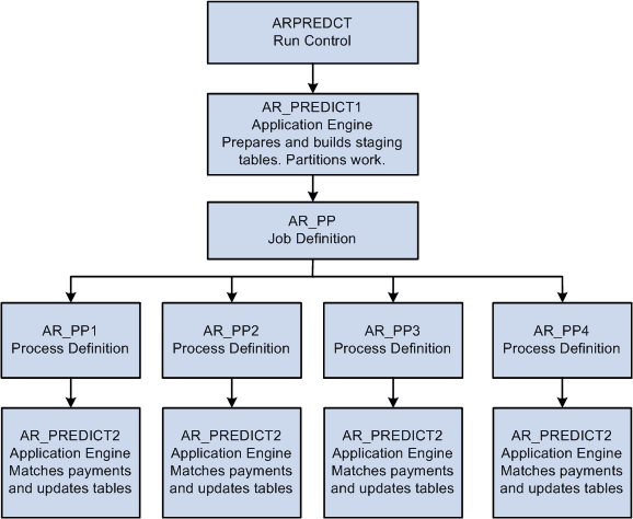

The following diagram illustrates how the Payment Predictor process performs parallel processing on four different AR jobs. The process prepares and builds staging tables and partitions the work into four different jobs, which are run parallel to each other. The Payment Predictor process for each job matches the payments and updates the tables.
Payment Predictor parallel process workflow for four different AR jobs: The process prepares and builds staging tables and partitions the work into four different jobs, which are run parallel to each other. The Payment Predictor process for each job matches the payments and updates the tables

AR_PREDICT1 Process
The AR_PREDICT1 process acts as a preprocessor for the actual payment matching process and also:
  • Gathers all the qualified data for processing.
  • Places the qualified data in temporary tables.
  • Partitions the data between the child processes.
  • Initiates the AR_PP multiprocess job that starts child processes in parallel.
The distribution of the data among the child or parallel processes is based on the composition of the data and the number of parallel processes. The process attempts to spread the data volume evenly among the processors. The staging phase takes a little longer, but the overall processing time is faster because multiple children processes run concurrently. You should balance the decision of using parallel processing or single-thread processing based on the volume of data and the hardware capacity to get the maximum benefit from this feature.
AR_PP Multiprocess Job
The AR_PP multiprocess job contains all the Application Engine process definitions that you use for parallel processing, such as AR_PP1. Each process definition calls the AR_PREDICT2 Application Engine process, which actually matches the payments, updates the application tables, and performs table cleanup before the process ends.
PeopleSoft Receivables delivers eight process definitions—AR_PP1 through AR_PP8. If you want to run more than eight partitions of the Payment Predictor process at once, you must define additional process definitions. Use the AR_PP1 process definition as an example.
The standard setup for the AR_PP multiprocess job is to run a single threaded process, which contains only the AR_PP1 process definition. If you want to use parallel processing, you must assign additional process definitions to the job definition. You must also specify the number of partitions that your organization will use. You might have to experiment with the number of partitions that works for you. Oracle recommends that you assign just a couple of additional partitions and increase the number, if needed.

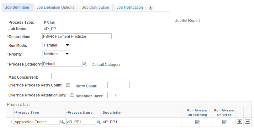

Adding More Parallel Processes to the AR_PP Multiprocess Job
Use the Job Definition page (PRCSJOBDEFN) to add additional Payment Predictor process definitions to run the AR_PP multiprocess job.
Navigation:
PeopleTools, and then Process Scheduler, and then Jobs, and then Job Definition, and then Job Definition
This example illustrates the fields and controls on the Job Definition page.
Job Definition page
Field or Control Description
Run Mode
Always select Parallel.
Process Type and Process Name
Enter Application Engine for the type and select from AR_PP2 to AR_PP8 for each separate partition or process that you want to run. If you define additional process definitions, select the name of the definitions that you added.
Note: You must have the same number of rows in the process list as you enter in the Maximum Partitions field on the AR Parallel Processing Options page.
Run Always on Warning and Run Always on Error
You must select these check boxes.
See the product documentation for PeopleTools: Process Scheduler for more information.
