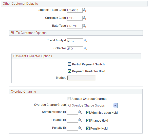

Service Default Values Page
Use the Service Default Values page (SCM_SVC_DFLTS) to change default values for Pension Administration customers.
Navigation:
SCM Integrations, and then Setup, and then Service Default Values, and then Service Default Values
This example illustrates the fields and controls on the Service Default Values page for Pension Administration customers (1 of 2).
This example illustrates the fields and controls on the Service Default Values page for Pension Administration customers (2 of 2).
