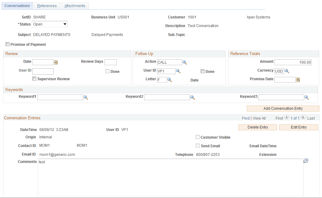

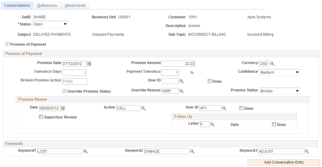

Conversations Page
Use the Conversations page (CONVER_DATA1_SS) to view and update existing conversations and promises in PeopleSoft Receivables.
Navigation:
Accounts Receivable, and then Customer Interactions, and then Conversations, and then View/Update Conversations, and then Conversations
This example illustrates the fields and controls on the Conversations page, including a promise of payment.
Conversations page with promise of payment (1 of 2)
This example illustrates the fields and controls on the Example of a Conversations page with promise of payment (2 of 2).
See PeopleSoft Order to Cash Common Information: Understanding Conversations.
The eBill Payment-generated online actions do not have a corresponding, active Done check box on the Conversations page, as is normally seen in system-generated actions. An eBill customer may have multiple open conversation entries that require separate responses. An AR Specialist can choose to close an individual action but not the conversation.

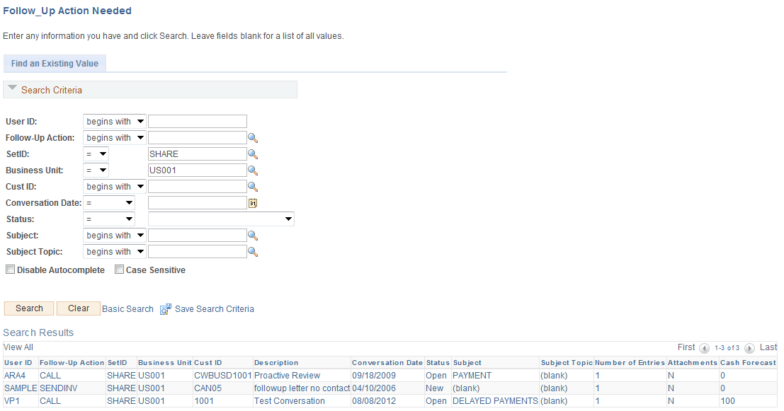

Follow-Up Action Needed Search Page
Use the search page in the Follow-Up Action Needed component (CONVR_QRY_FOLLOW) to search for Conversations with incomplete follow-ups.
Navigation:
Accounts Receivable, and then Customer Interactions, and then Conversations, and then Follow-Up Action Needed
This example illustrates the fields and controls on the Follow-Up Action Needed search page. You can find definitions for the fields and controls later on this page.
Follow-Up Action Needed page
Enter the search criteria to search for regular conversations and promise date conversations that have incomplete follow-up actions. The user assigned to the action has not selected the Done check box in the Follow Up group box on the Conversations page. The system lists these conversations in the search results. Click the appropriate conversation's link to open the Conversations page.
This example illustrates the fields and controls on the Conversations page with follow-up action needed.
The user can then perform the required follow-up action and select the Done check box in the Follow Up group box to indicate that this follow-up action has been completed.

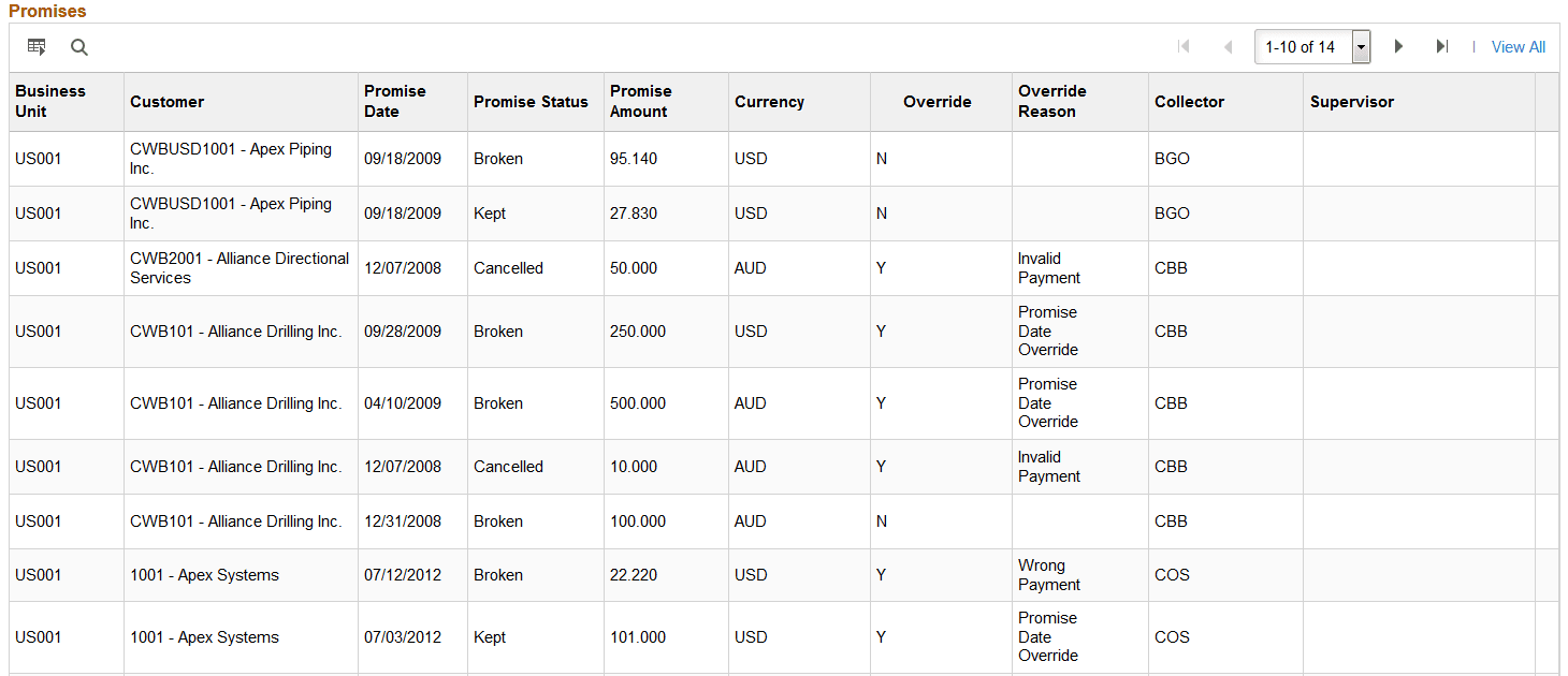

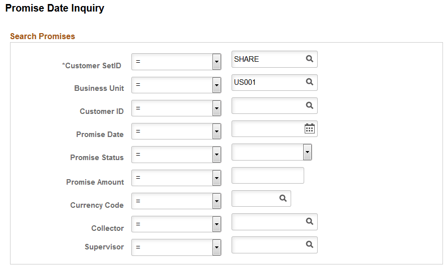

Search Promises
Select criteria in this group box to narrow your search for promise date conversation information.

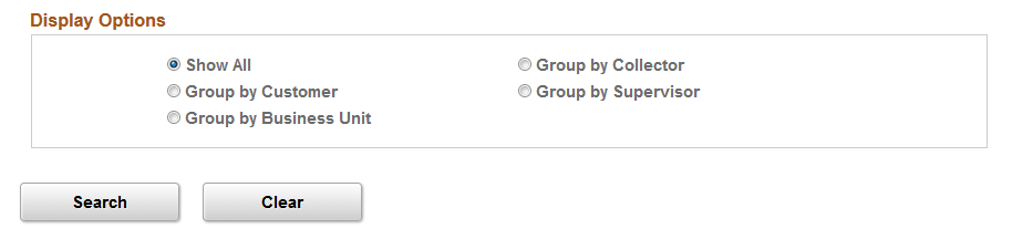

Display Options
Field or Control Description
Show All
Click this option and click the Search button to display information based on the search criteria that you set up in the Search Promises group box for all promises.
These promise information columns appear on the grid:
  • Business Unit
  • Customer
  • Promise Date
  • Promise Status
  • Promised Amount
  • Currency
  • Override (Y/N)
  • Override Reason
  • Collector
  • Supervisor
Group by Customer
Click this option and click the Search button to display promise information based on the search criteria that you set up in the Search Promises group box.
  • Broken Promises
  • Broken Amount
  • Kept Promises
  • Kept Amount
  • Open Promises
  • Open Amount
  • Currency Code
Group by Business Unit
Click this option and click the Search button to display promise information based on the search criteria based on each business unit associated with a customer.
The same columns that are in the Group by Customer grid display grouped by business unit.
Group by Collector
Click this option and click the Search button to display promise information based on the search criteria based on the collector associated with each promise.
The same columns that are in the Group by Customer grid display grouped by collector.
Group by Supervisor
Click this option and click the Search button to display promise information based on the search criteria based on the supervisor who was selected to review each promise.
The same columns that are in the Group by Customer grid display grouped by supervisor.
