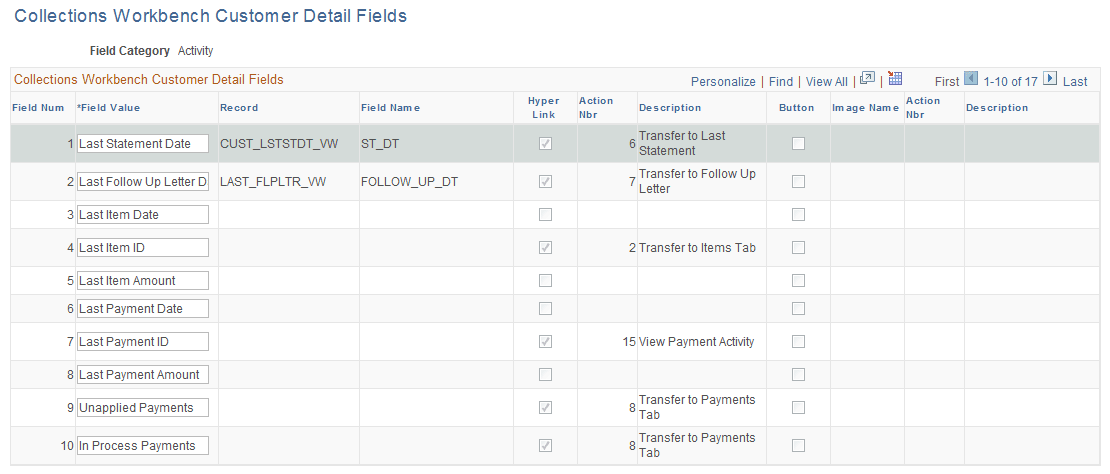

Collections Workbench Customer Detail Fields Page
Use the Collections Workbench Customer Detail Fields page (AR_CWB_CD_FIELDS) to set up Collections Workbench customer detail fields.
Navigation:
Set Up Financials/Supply Chain, and then Product Related, and then Receivables, and then Workbench, and then Customer Detail Fields, and then Collections Workbench Customer Detail Fields
This example illustrates the fields and controls on the Collections Workbench Customer Detail Fields page. You can find definitions for the fields and controls later on this page.
Field or Control Description
Field Category
Before you can access this page, you must select one of these field categories and click the Search button on the Customer Detail Fields page.
  • Activity Field
  • Balances Field
  • General Field
  • Metrics Field
  • User Field
Field Value
Enter a field value for each field based on the way you want the fields to appear on the Collections Workbench. The remaining fields are system defined and read-only.

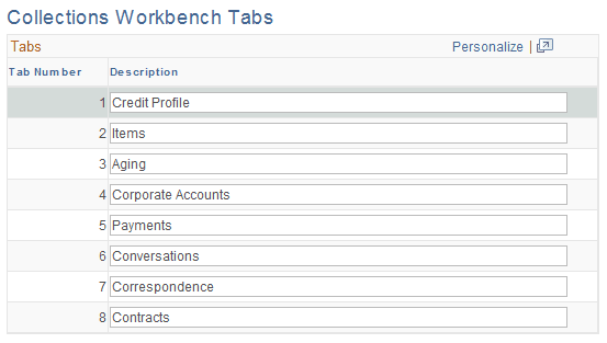

Collections Workbench Tabs Page
Use the Collections Workbench Tabs page (AR_CWB_TABS) to set up Collections Workbench tabs.
Navigation:
Set Up Financials/Supply Chain, and then Product Related, and then Receivables, and then Workbench, and then Tabs, and then Collections Workbench Tabs
This example illustrates the fields and controls on the Collections Workbench Tabs page. You can find definitions for the fields and controls later on this page.
Description
Enter a description for each tab. The tab number field is system defined and read-only.

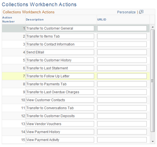

Collections Workbench Actions Page
Use the Collections Workbench Actions page (AR_CWB_ACTIONS) to set up Collections Workbench actions.
Navigation:
Set Up Financials/Supply Chain, and then Product Related, and then Receivables, and then Workbench, and then Actions, and then Collections Workbench Actions
This example illustrates the fields and controls on the Collections Workbench Actions page. You can find definitions for the fields and controls later on this page.
Description
These action descriptions are system-defined. The action numbers are system defined and read-only. These actions only appear on the Customer Details Field setup page. End users will not be able to view these descriptions.
URL (Uniform Resource Locator)
Enter or copy a URL
A URL is the address of a specific website or file on the Internet.
The URL that you enter on this page takes precedence over any code already in place. The URL that you enter is used as a way to customize actions quickly, without making code changes. Also, the existing code that goes with each of the existing actions is not based on a URL. There is PeopleCode logic plus a component transfer in the code for each action.

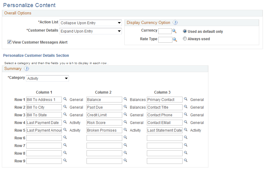

Personalize Content Page
Use the Personalize Content page (AR_CWB_ALL_OPTION) to personalize the content of the Collections Workbench for all users, by role, or by user ID.
Navigation:
  • Select All Users as the Personalization Level on the Maintain Personalization – Personalization Search page.
  • Select By Role as the Personalization Level on the Maintain Personalization – Personalization Search page, click the Search button on this page, and click the link associated with a role ID listed in the Search Results.
  • Select By User as the Personalization Level on the Maintain Personalization – Personalization Search page, click the Search button on this page, and click the link associated with one a User ID listed in the Search Results.
This example illustrates the fields and controls on the Personalize Content setup page (1 of 2). You can find definitions for the fields and controls later on this page.
This example illustrates the fields and controls on the Personalize Content setup page (2 of 2). You can find definitions for the fields and controls later on this page.
There is an order of precedence for the three levels of personalizations. If users have their user ID set up based on personalizations, they will always see these pages based on those personalizations. If the system does not find user ID personalizations, it uses the personalizations that are set up based on a the role of the user. If the system does not find any role-based personalizations set up, it uses the system-wide or All Users personalizations. Personalizations must be set up for All Users in order for the system to work properly, while personalizations for role or by user ID are optional.

Personalize Customer Details Section
Category
Select one of these categories to appear as the default on the Look Up Field page (AR_CWB_FLDLKUP_SEC) for each field. You can override this value on the Look on the Look Up Field page.
  • Activity Field
  • Balances Field
  • General Field
  • Metrics Field
  • User Field
Row "n" and Column "n"
The rows and columns contain the field values that you want to list on the Collections Workbench Customer Details page.
You can click the search icon next to each field value to access the Look Up Field page which contains the fields that belong to the category:
  • Category
    The default category that you selected at the top of this Summary section appears in this field. You can override this category.
    For example, if the category is currently General Field, you can select customer address fields or customer contact fields to appear in the cell of the Customer Details box on the Collections Workbench. If the category is currently Balances, you can select the customer outstanding balance field, or the past due amount field, or other balance amount fields, to appear in the cell of the Customer Details box on the Collections Workbench.
  • Field Value
    If you select a different category for the selected field value cell on the grid, you can select a new field value for the cell that applies to the newly selected category.
    For example, the field value in the cell on the Personalize Content page on Row 1 and Column 1 is currently Bill To Address 1 and it has General as the category to the right of the cell that contains the field value.
    When you click Search icon next to the Bill To Address 1 field cell, the Look Up Field page displays. You change the General Field category to Activity Field. Remove the Bill To Address 1 from the Field Value and click the Lookup button. A list of field values displays for the Activity Field category. For this example, you choose Last Payment Date for the Field Value. The Personalize Content page re-displays with the Field Value Last Payment Date appearing in the Row 1, Column 1 cell with the category Activity displaying to the right of the field.
    The field values defined in the rows and columns appear in the Customer Details box on the Collections Workbench. The Customer Details box can hold up to 27 fields in 9 rows with 3 field values in each row. If you remove all fields in the bottom row, the space on the Collections Workbench page is claimed back, and the Customer Details box shrinks to fit the remaining fields. If you add a field in the bottom row that was previously empty, the Customer Details box expands to list that new field. Personalizations defined for a specific user ID overrides personalizations defined for a role. Personalizations defined for a role override the personalizations defined for all users.
