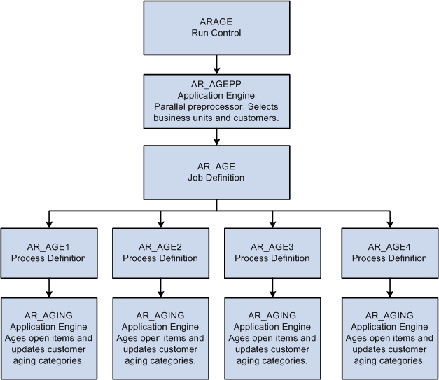

The following diagram illustrates the process flow of the AR Parallel Aging process (AR_AGE) for four separate AR jobs. After setting up the AR_AGE Run Control page, the AR_AGEPP Application Engine parallel preprocessor selects business units and customers, then the AR_AGE runs the job definition for the jobs AR_AGE1, AR_AGE2, AR_AGE3, and AR_AGE4. The AR_AGING Application Engine ages open items and updates customer aging categories for each job.
Process flow of the AR Parallel Aging process (AR_AGE) for four separate AR jobs
Aging parallel multiprocessing workflow for multiple jobs
When you use the Process Monitor to check the status of the process, you view the status of the Aging Parallel Preprocessor process (AR_AGEPP) and each process within the Aging Parallel multiprocess job (AR_AGE). The system does not indicate that the Aging - Parallel multiprocess job (AR_AGE) is successful until each parallel process completes. The Job Message Log Summary page summarizes all the individual parallel process message log messages for the entire AR_AGE job.

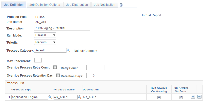

Adding More Parallel Processes to the AR_AGE Multiprocess Job
Use the Job Definition page (PRCSJOBDEFN) to add additional Aging process definitions to run the Aging Parallel multiprocess job (AR_AGE).
Navigation:
PeopleTools, and then Process Scheduler, and then Jobs, and then Job Definition
This example illustrates the fields and controls on the Job Definition page.
Job Definition page
Field or Control Description
Run Mode
Always select Parallel.
Process Type and Process Name
Enter Application Engine for the type and select from AR_AGE2 to AR_AGE8 for each separate partition or process that you want to run. If you define additional process definitions, select the name of the definitions that you added.
Note: You must have the same number of rows in the process list as you enter in the Maximum Partitions field on the AR Parallel Processing Options page.
Run Always On Warning and Run Always On Error
You must select these check boxes.
See the product documentation for PeopleTools: Process Scheduler for more information.
