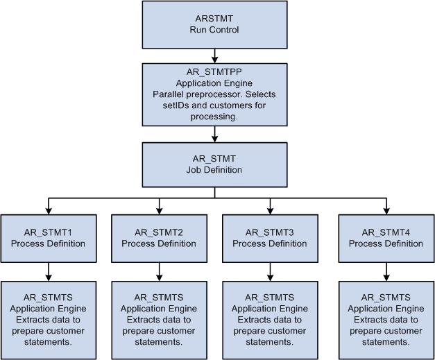

The following diagram illustrates how the Statements Preprocessor Application Engine parallel processor processes four different statement jobs AR_STMT1, AR_STMT2, ARSTMT3, and AR_STMT4 at the same time and extracts data to prepare customer statements for each job.
Illustrates how the Statements Preprocessor Application Engine parallel processor processes four different statement jobs at the same time, and extracts data to prepare customer statements for each job
Statement parallel processing workflow for multiprocess jobs

AR_STMTPP Process
The AR_STMTPP process acts as a preprocessor for the Statements process and also:
  • Selects SetIDs and customers for processing.
  • Places the qualified data in temporary tables.
  • Partitions the data between the child processes.
  • Initiates the AR_STMT multiprocess job that starts child processes in parallel.
The distribution of the data among the child or parallel processes is based on the composition of the data and the number of parallel processes. The process attempts to spread the data volume evenly among the processors. The staging phase takes a little longer, but the overall processing time is faster because multiple children processes run concurrently. You should balance the decision of using parallel processing or single thread processing based on the volume of data and the hardware capacity to get the maximum benefit from this feature.
AR_STMT Multiprocess Job
The AR_STMT multiprocess job contains all of the Application Engine process definitions that you use for parallel processing, such as AR_STMT1. Each process definition calls the AR_STMTS Application Engine process, which actually extracts the data, prepares the statements, and performs table cleanup before the process ends.
PeopleSoft Receivables delivers eight process definitions—AR_STMT1 through AR_STMT8. If you want to run more than eight partitions of the Statements process at once, you must define additional process definitions. Use the AR_STMT1 process definition as an example.

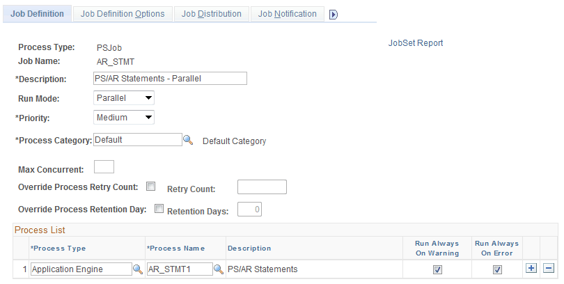

Adding More Parallel Processes to the AR_STMT Multiprocess Job
Use the Job Definition page (PRCSJOBDEFN) to add additional Statements process definitions to run the AR_STMT multiprocess job.
Navigation:
PeopleTools, and then Process Scheduler, and then Jobs, and then Job Definition
This example illustrates the fields and controls on the Job Definition page. You can find definitions for the fields and controls later on this page.
Job Definition page
Field or Control Description
Run Mode
Always select Parallel.
Process Type and Process Name
Enter Application Engine for the type and select from AR_STMT2 to AR_STMT8 for each separate partition or process that you want to run. If you define additional process definitions, select the name of the definitions that you added.
Note: You must have the same number of rows in the process list as you enter in the Maximum Partitions field on the AR Parallel Processing Options page.
Run Always On Warning and Run Always On Error
You must select these check boxes.
