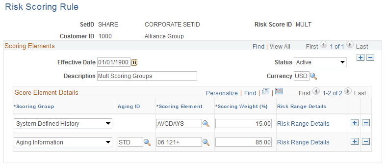

Risk Scoring Rule Page
Use the Risk Scoring Rule page (AR_RISKSCR_TBL) to define risk scoring rules.
Navigation:
Set Up Financials/Supply Chain, and then Product Related, and then Receivables, and then Credit/Collections, and then Risk Scoring Rule
This example illustrates the fields and controls on the Risk Scoring Rules page. You can find definitions for the fields and controls later on this page.
Field or Control Description
Effective Date
Select the date that this risk score element will become effective. You can add risk scoring elements, as well as assign a new effective date if you modify an existing risk scoring element.
Currency
Enter an anchor currency to apply to this risk score ID.
Note: This field is required when you select a Scoring Element that is amount-based, such as SALES.
Scoring Group
Select one of these values:
  • Aging Information
  • Customer Activity
  • Customer Table
  • Item Information
  • System Defined History
  • User Defined History
Aging ID
Select an aging ID value, which is used to populate the scoring element with the correct aging categories.
Note: This field only appears when you select Aging as the Scoring Group.
Amount
Enter a threshold amount in order to select the oldest item greater than this amount.
Note: This field only appears when you select Item Information as the Scoring Group and DTOLDIT (data of the oldest item) as the Scoring Element.
Scoring Element
Select the scoring element that you want to apply to the selected scoring group. This value describes the type of scoring data used to make up a scoring rule based on the Scoring Group you select. For example, you can select Customer Activity as the Scoring Group and BALDUE as the Scoring Element, or System Defined History as the Scoring Group and DSO30 as the Scoring Element.
Scoring Weight (%) scoring weight (percentage)
Enter the percentage of weight that you want to apply to this scoring element which is multiplied by the Range Value that you enter on the Risk Range Details page to obtain a Risk Score for that element row. When the Risk Scoring program runs, it sums up the individual element scores for the overall customer score and updates the PS_CUST_CREDIT table with the customer risk score.
Default value is 100.00 percent.
Note: The total scoring weight percentages for all of the scoring elements must equal 100.00 percent.

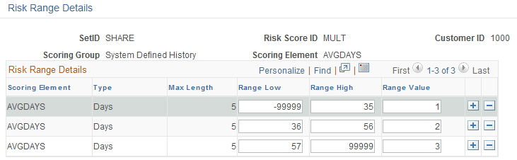

Risk Range Details
Click this link to access the Risk Range Details page.
Risk Range Details Page
Use the Risk Range Details page (AR_RISK_SEC) to enter risk scoring range values.
Navigation:
Click the Risk Range Details link on the Risk Scoring Rule page.
This example illustrates the fields and controls on the Risk Range Details page. You can find definitions for the fields and controls later on this page.
This page displays the risk range details for each scoring group and scoring element.
Type
Indicates the type of field that appears based on the selected scoring element on the Risk Scoring Rule page, such as Char, Amount, percent, days, date or numeric.
Max Length (maximum length)
Displays the maximum length of the data the user can enter in the range low and range high value columns. The length along with the type is displayed to aid users in entering the range values. If the type is days and the length is 5 you can enter whole number range values up to 5 positions in length such as .99999, 40000, and more.
Range Low and Range Highand Range Value
These fields depend on your selection of the type of scoring element, as well as Scoring Group and Scoring Element values on the Risk Scoring Rule page.
For example, if you select the scoring group (Customer Activity) and the scoring element (BALDUE), which is based on an amount, then you enter a low range (-99,999) and high range (5,000).
If you select a Scoring Element value on the Risk Scoring Rule page that has a Yes/No value, such as CRHOLD (the customer on credit hold), then these Range Low and Range High fields are automatically populated with a row for Yes (Y) and a row for No (N).
Range Value: Enter a value for each range between 1 and 100.
See Understanding Risk Scoring Rules.
