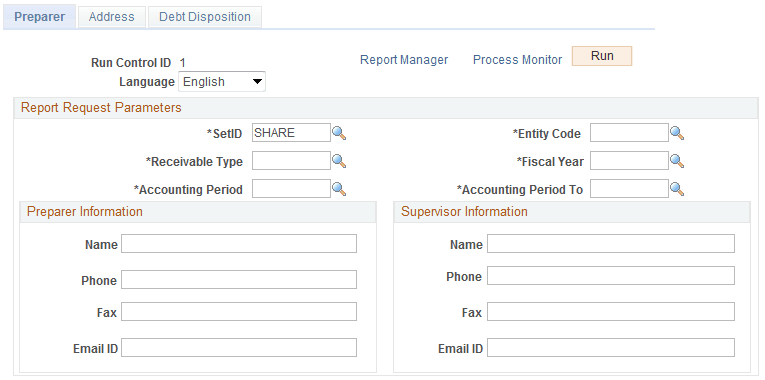

Treasury Report on Receivables - Preparer Page
Use the Treasury Report on Receivables - Preparer page (RUN_SF220_1) to select the range of periods to include in the processing to generate the TROR.
Navigation:
Accounts Receivable, and then Receivables Update, and then Posting Results-Upd Pend Items, and then Treasury Report On Receivables, and then Preparer
This example illustrates the fields and controls on the Treasury Report on Receivables - Preparer page. You can find definitions for the fields and controls later on this page.
Field or Control Description
SetID
Select the SetID that is associated with the entity code selected for this report.
Entity Code
Select the reporting entity code that will be included in this report. The selected entity code contains the TROR template to be used for this report and all business units defined for this entity.
Receivable Type
Select the receivable type to apply to this report. The possible receivable types for this entity are set up on the Reporting Entity Code page.
Fiscal Year
Select the fiscal year to apply to this report. The fiscal year that you select is based on the Calendar ID setup for the selected entity code.
Accounting Period From, Accounting Period To
Enter the accounting period range that you want to include in this report.
Preparer's Information
Enter the name, phone number, fax number, and e-mail address of the preparer depending on the information that is available.
Supervisor Information
Enter the name, phone number, fax number, and e-mail address of the preparer's supervisor depending on the information that is available.

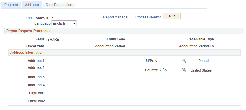

Treasury Report on Receivables - Address page
Use the Treasury Report on Receivables - Address page (RUN_SF220_2) to enter address information for the TROR.
Navigation:
Accounts Receivable, and then Receivables Update, and then Posting Results - Upd Pend Item, and then Treasury Report on Receivables, and then Address
This example illustrates the fields and controls on the Treasury Report on Receivables - Address page. You can find definitions for the fields and controls later on this page.
Enter the Address Information for the entity associated with this report.

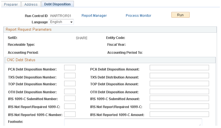

Treasury Report on Receivables - Debt Disposition Page
Use the Treasury Report on Receivables - Debt Disposition page (RUN_SF220_3) to enter debt disposition information for the TROR.
Navigation:
Accounts Receivable, and then Receivables Update, and then Posting Results - Upd Pend Item, and then Treasury Report on Receivables, and then Debt Disposition
This example illustrates the fields and controls on the Treasury Report on Receivables - Debt Disposition page. You can find definitions for the fields and controls later on this page.
PCA Debt Disposition Number, Amount (private collection agency debt disposition number, amount)
Enter the number and amount of written-off delinquent debts that are still being pursued by the U.S. Department of Treasury or a private collection agency.
TXS Debt Disposition Number, Amount (Treasury or debt collection center debt disposition number, amount)
Enter the number and amount of written-off delinquent debts that are still being pursued by the U.S. Department of Treasury or a designated debt collection center.
TOP Debt Disposition Number, Amount (Treasury for offset debt disposition number, amount)
Enter the number and amount of written-off delinquent debts that are still being pursued by the U.S. Department of Treasury for offset.
OTH Debt Disposition Number, Amount (other debt disposition number, amount)
Enter the number and amount of written-off delinquent debts that are still being pursued by means other than those listed.
IRS 1099-C Submitted Number, Amount
Enter the number and amount of written-off delinquent debts that have been reported to the IRS on Form 1099-C.
IRS Not Report/Not Reqd 1099-C Number/Amount
Enter the cumulative number and dollar amount of debts that were closed-out during the previous calendar year, but were not reported to the IRS on Form 1099-C because of the dollar value being less than the IRS requirement for reporting.
IRS Not Reported 1099-C Number/Amount
Enter the cumulative number and dollar amount of debts that were closed out during the previous calendar year, in which collection actions have ceased, but were not reported to the IRS on form 1099-C.
Footnote
This field does not print to the Treasury Report on Receivables.
