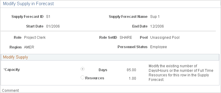

Modify Supply in Forecast Page
RS_FR_SUP_MOD_SUP
Add or subtract the actual supply in the forecast to, for example, model different scenarios for a given calculated resource pool role row.

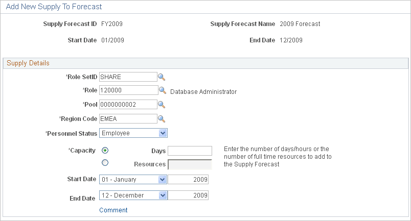

Add New Supply To Forecast Page
RS_FR_SUP_ADD_SUP
Add additional supply to a forecast.
The system validates the dates you enter to ensure that the start date is not greater than the end date and that the date range does not exceed 24 months. When adding a new value, you can manually enter the supply forecast ID or the system can generate it.

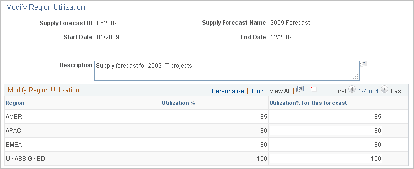

Modify Region Utilization Page
RS_FR_SUP_UTIL
Change the utilization percentage for a forecast.

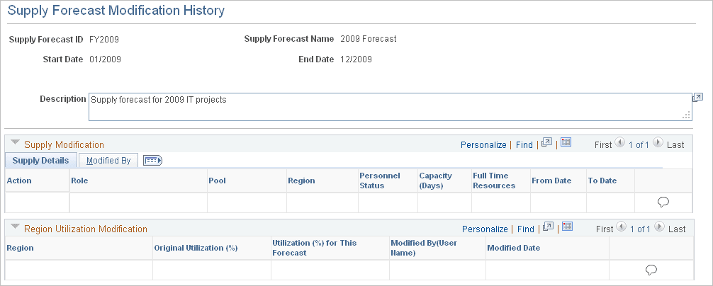

Supply Forecast Modification History Page
RS_FR_SUP_MOD
View details of modifications made to supply forecasts.

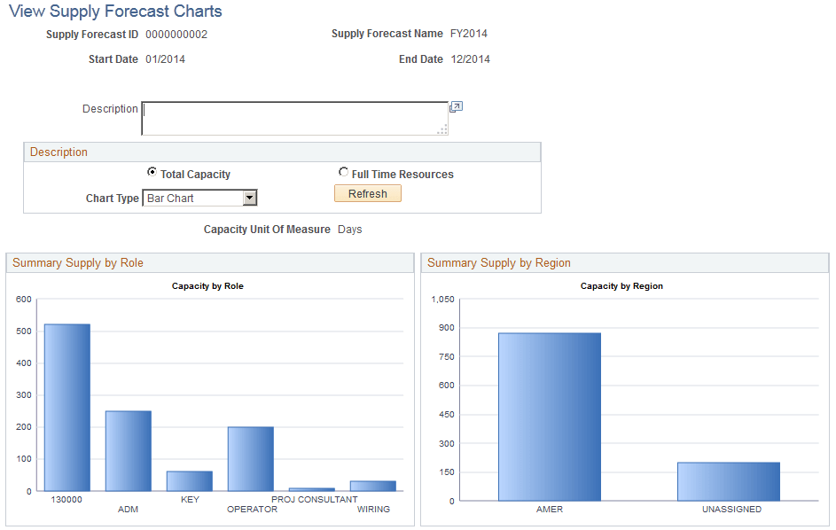

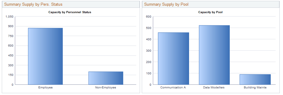

View Supply Forecast Charts Page
RS_SUP_CHARTS
View graphical summarized capacity information by supply category.

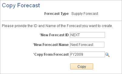

Copy Forecast Page
RS_FR_COPY
Create copies of existing forecasts with same date range as the original forecast. Use this page to copy supply or demand.

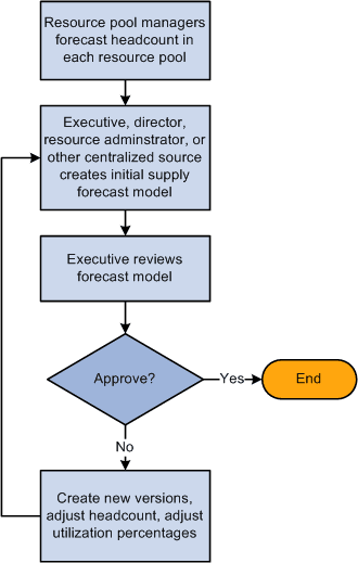

This flowchart shows the supply forecast model process:
Supply Forecast Model process flow
You use the Supply Forecast component (RS_FR_SUPPLY) to create, view, and modify supply forecasts.

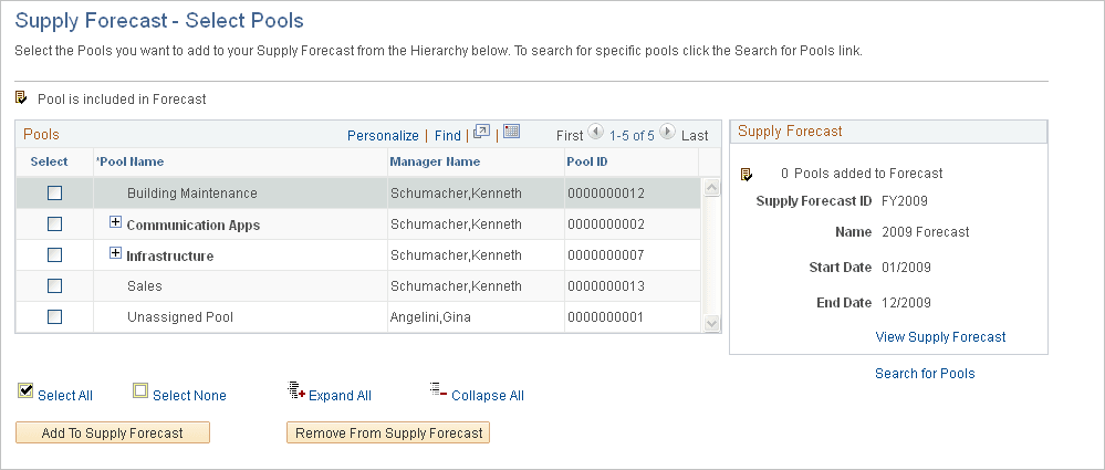

Supply Forecast - Select Pools Page
Use the Supply Forecast - Select Pools page (RS_FR_SUP_SEL_POOL) to add a new supply forecast and select the pools to add to the supply forecast.
Navigation:
Resource Management, and then Strategic Capacity Planning, and then Capacity Plan Supply Forecast
Click the Continue Selecting Pools link in an existing supply forecast.
This example illustrates the fields and controls on the Supply Forecast - Select Pools page. You can find definitions for the fields and controls later on this page.
Field or Control Description
Select
Select this check box to designate that a pool is selected for the forecast. When you select a pool that has child pools, all the child pools should be selected as well. You can clear a parent pool without clearing the associated child pools.
Pool Name
Displays the description of the available pools from which to select.
Manager Name
Displays the name of the pool manager.
Add To Supply Forecast
Click this button to add the selected pools to the supply forecast.
Remove From Supply Forecast
Click this button to remove the selected pools from the supply forecast.
Search for Pools
Click this link to access the Search for Pools page where you can provide pool name, pool manager name, and pool ID criteria to limit the search and selection of specific pools.
Click this link to view the summarized information for a supply forecast.
Selected Pool Icon
The Selected Pool icon appears after you select a resource pool and click the Add To Supply Forecast button to add the pool to the supply forecast.

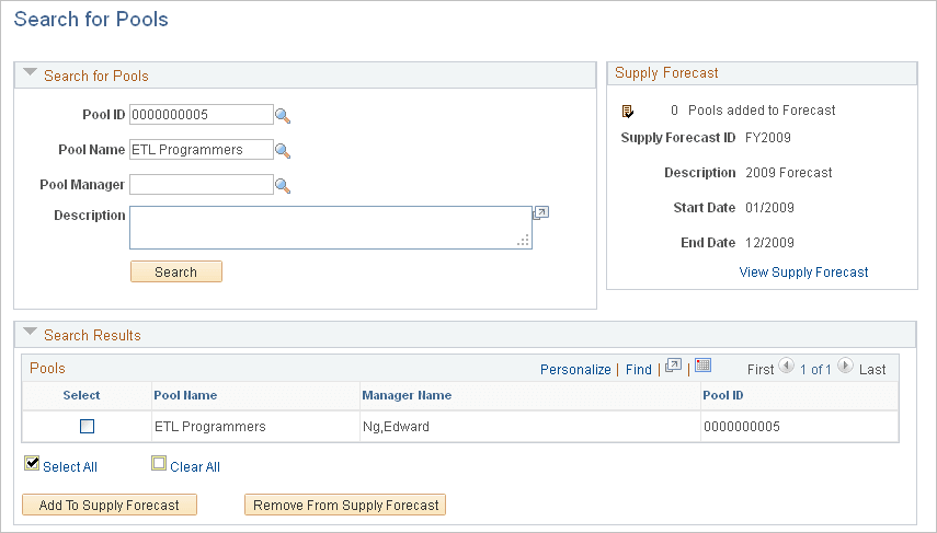

Search for Pools Page
Use the Search for Pools page (RS_FR_POOL_SRCH) to search for pools by pool name, pool manager, or pool ID to be added to the supply forecast.
Navigation:
Click the Search for Pools link on the Supply Forecast - Select Pools page.
This example illustrates the fields and controls on the Search for Pools page. You can find definitions for the fields and controls later on this page.
Select
After you enter search criteria in the Search for Pools group box and view results in the Search Results group box, select the pools that you want to add to the forecast.
Click this button to add the selected pools to the forecast. When you click this button, the Selected Pool icon appears next to the pool name. Click the Return to Select Pools link to return to the Supply Forecast - Select Pools page.

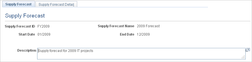

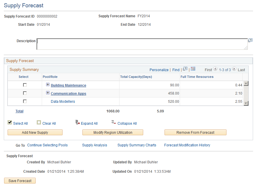

Supply Forecast Page
Use the Supply Forecast page (RS_FR_SUP_SUMMARY) to view the summarized information for a supply forecast.
The page contains links to all the other supply forecast functions. After you select the pools that you want to include in the supply forecast, you can view the calculated capacity for all the resources (generic and named resources) that are in the selected resource pools. The data is summarized first by pool and then by role.
Navigation:
  • Resource Management, and then Strategic Capacity Planning, and then Supply Forecast, and then Supply Forecast
  • Click the View Supply Forecast link on the Supply Forecast - Select pools page.
This example illustrates the fields and controls on the Supply Forecast page (1 of 2). You can find definitions for the fields and controls later on this page.
This example illustrates the fields and controls on the Supply Forecast page (2 of 2). You can find definitions for the fields and controls later on this page.
Description
Enter a description for this supply forecast.
Pool/Role
Displays the pool name and associated roles for the pool. Click a pool link in this column to view all the calculated capacity in detail for that role within the specific pool. You can remove an entire pool from the supply forecast by selecting the adjacent check box and clicking the Remove From Forecast button.
Total Capacity(Hours) or Total Capacity(Days)
Based on your installation choice, this column displays the total calculated resource capacity in the pool for the date range specified for the supply forecast displays in hours or days. The data is summarized first by pool and then by role.
Full Time Resources
Displays the total number of full-time resources in the pool for the date range specified for the forecast. The common denominator for the calculation is the number of months included in the forecast.
Total
Displays the total capacity and full-time resources. Click this link to view supply details for all the pools in the supply forecast.
Add New Supply
Click to access the Add New Supply To Forecast page and select a date range within the forecast periods, pool, role, personnel status, region, and amount of capacity that you want to add to the supply forecast capacity.
Click to access the Modify Region Utilization page and adjust the region utilization percentage for the current supply forecast.
Click to remove selected pool data from the forecast.
Click to access the Supply Forecast - Select Pools page and refine the pool selection for this forecast.
Supply Analysis
Click to access the Supply Analysis page to view and analyze supply forecast data by the four supply categories with monthly views.
Supply Summary Charts
Click to access the View Supply Forecast Charts page and view charts based on the supply categories.
Click to access the Supply Forecast Modification History page and view each modification to the actual supply in the forecast.

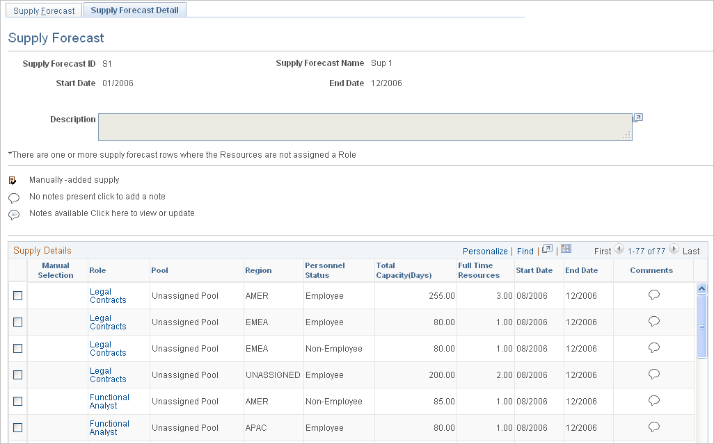

Supply Forecast Detail Page
Use the Supply Forecast Detail page (RS_FR_SUP_DTL) to view the supply details for all of the pools or one particular pool in the supply forecast.
Navigation:
  • Resource Management, and then Strategic Capacity Planning, and then Supply Forecast, and then Supply Forecast Detail
  • Click the View Supply Forecast link on the Supply Forecast - Select Pools page.
    Click the Total link on the Supply Forecast page.
  • Click a pool name in the Supply Summary grid on the Supply Forecast page.
This example illustrates the fields and controls on the Supply Forecast Detail page. You can find definitions for the fields and controls later on this page.
Description
Row Added
Indicates that the row was added to the forecast by using the Add New Supply page.
Comments Exist Icon and No Comments Exist Icon
Click this icon to enter comments about the supply row. If the icon contains lines, comments already exist for the row. If the icon does not contain lines, no comments exist for the row.
Supply Details
Role, Pool, Region, and Personnel Status
These are the supply categories for the resource capacity that appears on the row. Click the role to modify the capacity that appears in the row.
Total Capacity (Hours) or Total Capacity (Days)
Displays the resource capacity for the row. The value is based on the unit of measure—either days or hours—selected during installation.
Full Time Resources
Use the Modify Supply in Forecast page (RS_FR_SUP_MOD_SUP) to add or subtract the actual supply in the forecast to, for example, model different scenarios for a given calculated resource pool role row.
Navigation:
Click a link in the Role column on the Supply Forecast Detail page.
This example illustrates the fields and controls on the Modify Supply in Forecast page. You can find definitions for the fields and controls later on this page.
The page displays supply categories for the selected row—role, region, pool, and personnel status. You cannot change the supply categories of an existing row that was calculated from a resource pool.
Capacity
Select capacity Days or Hours, based on the unit of measure installation setting for capacity planning), or Resources. The capacity values appear that exist for the row. The values can be positive or negative numbers. Enter a value in one of the boxes. The system calculates the corresponding value (capacity in days or hours, or full-time resources) in the Supply Details grid after you click OK. The new calculation does not appear on the Modify Supply in Forecast page until you reenter that page from the Supply Forecast Detail page.
Changes made to either the Days or Resources fields are not saved unless the respective option is selected.
Use the Add New Supply To Forecast page (RS_FR_SUP_ADD_SUP) to add additional supply to a forecast.
Navigation:
Click the Add New Supply button on the Supply Forecast page.
This example illustrates the fields and controls on the Add New Supply to Forecast page. You can find definitions for the fields and controls later on this page.
You can enter the same supply categories as an existing row, including the same date ranges.
Role SetID and Role
Enter a SetID and any valid role. You can enter roles that are not yet in the forecast.
Pool
Enter a pool ID. If you later remove a pool from the forecast, any new supply rows that you added for that pool are removed from the forecast as well.
Region Code
Enter any valid region. You can enter regions that are not yet in the forecast.
Personnel Status
Select Employee or Non-Employee.
Capacity
Select Hours or Days, based on the installation settings, and enter the number of hours or days to add to the supply forecast. Alternatively, select Resources and enter the number of full-time resources to add to the supply forecast.
Start Date and End Date
Enter the date range over which you want to add this supply in the model. The dates must be within or equal to the supply forecast date ranges. The forecast start and end dates appear by default.
Comment
Click this link to add comments about this new supply.
Use the Modify Region Utilization page (RS_FR_SUP_UTIL) to change the utilization percentage for a forecast.
Navigation:
Click the Modify Region Utilization button on the Supply Forecast page.
This example illustrates the fields and controls on the Modify Region Utilization page. You can find definitions for the fields and controls later on this page.
The utilization values only apply to the particular forecast and do not override the system region utilization percent.
Description
Enter a description of the modifications.
Region and Utilization % (utilization percent)
Displays all the regions that are set up in the system and the utilization percent for the forecast.
Utilization % for this forecast
Enter a different utilization percent. The default value is equal to the Utilization % value. The system uses the value you enter to recalculate the supply in the current supply forecast.
The value that you enter here remains with this forecast whenever you access it. All supply will be based on the value that you specify in this field.
Use the Supply Forecast Modification History page (RS_FR_SUP_MOD) to view details of modifications made to supply forecasts.
Navigation:
Click the Forecast Modification History link on the Supply Forecast page.
This example illustrates the fields and controls on the Supply Forecast Modification History page. You can find definitions for the fields and controls later on this page.
Action
Possible actions are:
Add: Indicates that you added a supply using the Add New Supply To Forecast page.
Update: Indicates that you added or removed an existing supply row that originally came from resource pools.
Delete: Indicates that you selected a row clicked the Remove from Forecast button.
Capacity (Hours) or Capacity (Days) and Full Time Resource
Displays the difference between the original supply details value and what you changed in the Add New Supply To Forecast or Supply Forecast Modification pages.
For example, you update an existing row that was calculated based on the resource pools, and not by adding new supply row. You change the total capacity from 500 days to 250 days, and consequently the full-time resources change from 3 to 1.5. The action is Update, the capacity (hours) value in the Supply Forecast Modification History is −250, and the full-time resource value is −1.5.
Use the View Supply Forecast Charts page (RS_SUP_CHARTS) to view graphical summarized capacity information by supply category.
Navigation:
Click the Supply Summary Charts link on the Supply Forecast page or Supply Forecast Detail page.
This example illustrates the fields and controls on the View Supply Forecast Charts page (1 of 2). You can find definitions for the fields and controls later on this page.
This example illustrates the fields and controls on the View Supply Forecast Charts page (2 of 2). You can find definitions for the fields and controls later on this page.
Total Capacity and Full Time Resources
View the supply information by selecting Total Capacity (in the capacity planning installation level unit of measure of hours or days), or Full Time Resources.
Chart Type
Select to view a bar or pie chart.
Refresh
Click to update the charts after you select different chart options.
Copy Forecast Page
Use the Copy Forecast page (RS_FR_COPY) to create copies of existing forecasts with same date range as the original forecast.
Navigation:
Resource Management, and then Strategic Capacity Planning, and then Strategic Capacity Home, and then Strategic Capacity Planning Home
Click the Copy Forecast link in the Supply Forecast group box or the Demand Forecast group box.
This example illustrates the fields and controls on the Copy Forecast page. You can find definitions for the fields and controls later on this page.
Copy Forecast page
Forecast Type
Displays the forecast type that you select from the Strategic Capacity Planning Home page. If you select Copy Supply Forecast from the home page, the value is Supply. If you select Copy Demand Forecast from the home page, the value is Demand.
Note: You can create copies of existing supply forecasts. The newly created copy has the same date range as the original. The main purpose is to enable you to create multiple supply forecasts quickly for the same period to model multiple supply scenarios. For example, one forecast might be for increasing contractor supply, another for moving some supply offshore, and another for modeling zero supply change.
New Forecast ID
Enter the ID for the new supply or demand forecast. The forecast ID can be auto-numbered or assigned manually. If you assign the forecast ID manually, enter up to 15 characters. Auto-numbered forecast IDs are 10 characters long.
New Forecast Name
Enter the name of the new forecast.
Copy from Forecast
Select the forecast that you want to copy.
Copy
Click to access the Supply Forecast page or Demand Forecast Summary page. The system populates the new forecast ID and forecast name on the page.
You do not need to click the Save Forecast button, as the forecast is already saved as a result of the Copy Forecast Application Engine process (RS_COPY_FRST).
