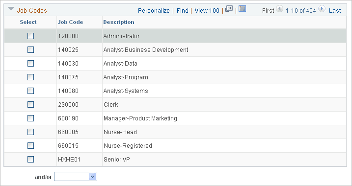

Job Codes
Use this collapsible grid to select employees and non-employees by job code.
This example illustrates the fields and controls on the Job Codes collapsible grid on the Create Resources Program page. You can find definitions for the fields and controls later on this page.
Field or Control Description
Select
Select one or more job codes for PeopleSoft Resource Management to use to generate the list of employees and non-employees to establish as resources.
and/or
Select and to narrow the list. The system includes only employees and non-employees that meet these criteria and the criteria that is in the next grid.
Select or to include employees and non-employees that meet any of the criteria that is selected in the grids.
If you leave this field blank, the system includes employees and non-employees that meet any of the criteria that is selected in the grids.

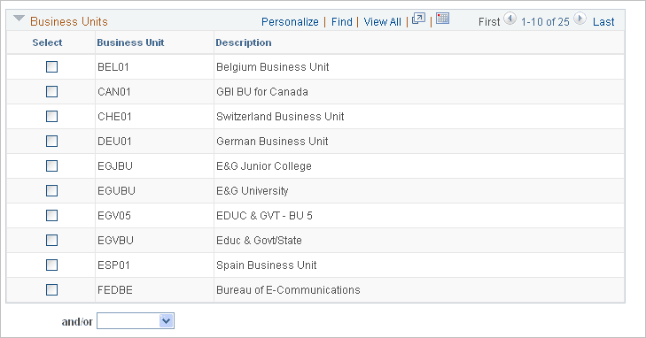

Business Units
Use this collapsible grid to select employees and non-employees by business unit.
This example illustrates the fields and controls on the Business Units collapsible grid on the Create Resources Program page. You can find definitions for the fields and controls later on this page.
Select
Select one or more business units for PeopleSoft Resource Management to use to generate the list of employees or non-employees to establish as resources.

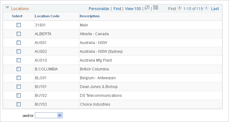

Locations
Use this collapsible grid to select employees and non-employees by location.
This example illustrates the fields and controls on the Locations collapsible grid on the Create Resources Program page. You can find definitions for the fields and controls later on this page.
Select
Select one or more locations for PeopleSoft Resource Management to use to generate the list of employees or non-employees to establish as resources.

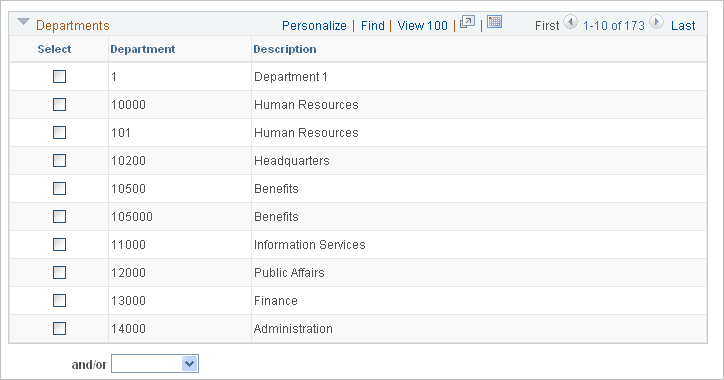

Departments
Use this collapsible grid to select employees and non-employees by department.
This example illustrates the fields and controls on the Departments collapsible grid on the Create Resources Program page. You can find definitions for the fields and controls later on this page.
Select
Select one or more departments for PeopleSoft Resource Management to use to generate the list of employees or non-employees to establish as resources.

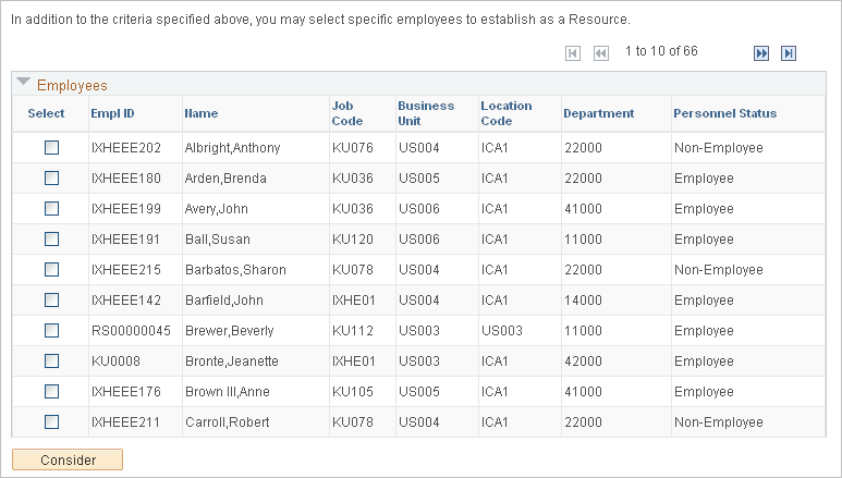

Employees
Use this collapsible grid to select individual employees and non-employees to include in addition to the criteria that is specified in the Job Codes, Business Units, Locations, and Departments grids.
This example illustrates the fields and controls on the Employees collapsible grid on the Create Resources Program page. You can find definitions for the fields and controls later on this page.
Select
Select the employee ID for each employee or non-employee to establish as a resource in addition to those that meet the criteria that is specified by job code, location, or department.
Consider
After you select employees for creating resources, click this button to add these employees added to the Considering group box and remove them from the Employees group box.

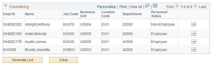

Considering
This group box displays a list of employees that you selected for creating resources.
This example illustrates the fields and controls on the Considering collapsible grid on the Create Resources Program page. You can find definitions for the fields and controls later on this page.
You can delete employees from this group box, at which time the system automatically adds the deleted employees back to the Employees grid.
Generate List
Click this button to view a list of the selections. All employees meeting the selection criteria appear in the Resources To Be Established group box to be established as resources when you click the Establish Resource button.
Clear
Click this button to clear your selections in all grids on the page.

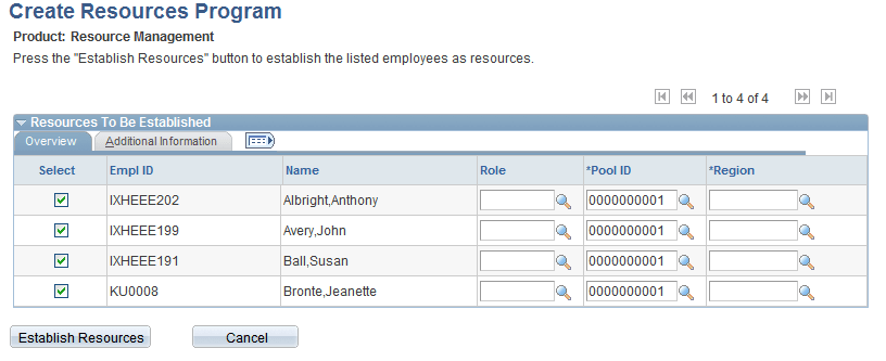

Create Resources Program (list) Page
Use the Create Resources Program (list) page (RS_CW_2) to review the employees and non-employees to be established as resources and execute the Create Resources Application Engine process (RS_CW).
Navigation:
Click the Generate List button on the Create Resources Program page.
This example illustrates the fields and controls on the Create Resources Program (list) page. You can find definitions for the fields and controls later on this page.
Select
The system automatically selects all check boxes for employees and non-employees appearing on the list so that they will be created as resources. Deselect the check box of any employee and non-employee that you do not want to create as assignable resources.
Role
Enter a project role for the resource. This field is optional; however, entering a role for all resources enhances the capacity planning functionality in PeopleSoft Resource Management.
Pool ID
Enter a resource pool ID for the resource. You must enter a resource pool when you establish a resource.
Region
Enter a region code for the resource. You must enter a region when you establish a resource.
Establish Resources
Click to run the Create Resources process to convert the list of selected employees and non-employees into assignable resources.
This process does not affect PeopleSoft HCM employee records. The process establishes a new row of data in the Worker table (RS_WORKER_TBL) and Worker Effective Date table (RS_WRKR_EFFDT) for each resource.
New resources are established as eligible for staffing in PeopleSoft Resource Management, which means that they are included in Resource Matching and can be placed on assignments. Use the Resource Eligibility Management page to change the resource's eligibility.
Cancel
Clears the list and returns to the preceding page.

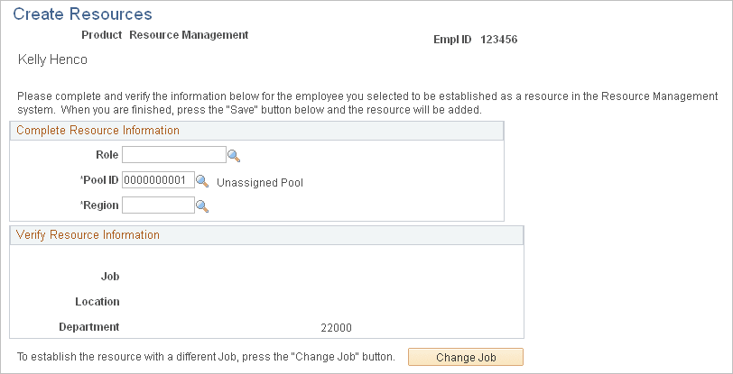

Create Resources Page
Use the Create Resources page (RS_WRKR_CREATE) to enter supply categories and establish an individual employee or non-employee as a resource.
Navigation:
Resource Management, and then Establish Resources, and then Create Resources, and then Create Resources
This example illustrates the fields and controls on the Create Resources page. You can find definitions for the fields and controls later on this page.
Non-employees do not appear for selection on the Establish Employee as Resource - Add an Employee as Resource search page if you cannot establish non-employees as resources.
Complete Resource Information
These fields comprise supply category information.
Role
Pool
Enter the resource's pool ID. You must enter a resource pool when you establish a resource.
Region
Verify Resource Information
Job, Location, and Department
Verify the information for this employee. If the values that appear on this page are incorrect, access the employee source database to make corrections.
Save
Click to establish the employee as a resource with the values that appear on the page.
Change Job
If you integrate with PeopleSoft HCM and use the multijob feature, click Change Job to establish the resource with a different job.
