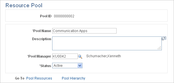

Resource Pool Page
Use the Resource Pool page (RS_RES_POOL) to add or modify resource pools.
Navigation:
Setup Financials/Supply Chain, and then Product Related, and then Resource Management, and then Resource Pools, and then Setup RM Resource Pools
This example illustrates the fields and controls on the Resource Pool page. You can find definitions for the fields and controls later on this page.
Resource Pool page
Field or Control Description
Pool ID
Displays the system-generated pool identifier. This key field is assigned sequentially when you add a pool.
Pool Name
Enter a name for the pool, which you can modify when necessary.
Pool Manager
Enter the pool manager. You can select any employee in the system, even if the employee is not established as a resource in PeopleSoft Resource Management. Pool managers can receive workflow to approve assignments or allocations for resources in their respective pools.
Status
Select Active or Inactive. Pool managers can change the status of their own pools and any child pools. You can change inactive pools to an active status at any time. Only active pools appear in the pool hierarchy.
Pool Resources
Click to access the Pool Resources - Manage Pool Resources page to view and modify the resources of the selected pool.
Pool Hierarchy
Click to access the Pool Hierarchy page to establish the pool organization and relationships.

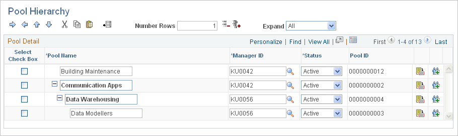

Pool Hierarchy Page
Use the Pool Hierarchy page (RS_POOL_HRCHY) to establish the resource pool hierarchy.
Navigation:
Resource Management, and then Manage Resource Pools, and then Resource Pool Hierarchy, and then Pool Hierarchy
This example illustrates the fields and controls on the Pool Hierarchy page. You can find definitions for the fields and controls later on this page.
Pool Hierarchy page
Select the check box in the first column of the grid to identify the row that you want to modify. You can indent or outdent the selected row, move the selected row up or down in the hierarchy, or add rows below the selected row.
Pool Indent Icon
Click the Indent icon to indent a row. This action makes the previous row a parent pool. You can not indent on the first pool in the list, and you can not indent more than one level from its parent row. Indenting a summary pool also indents all of its child pools.
Pool Outdent Icon
Click the Outdent icon to outdent a pool, which moves the selected row down one level. You cannot outdent a row that is already at the most outdented level. Outdenting a summary pool also outdents all of its children. Outdenting a row with siblings makes the selected row the parent of its siblings; the selected pool becomes a parent pool.
Move Up Icon
Click the Move Up icon to move a row above the previous row. If the selected row is a parent pool, all of its child pools also move up. The pool that you move up inherits the more indented hierarchy level of the pool above and below the moved pool.
Move Down Icon
Click the Move Down icon to move a pool below the following row. If the selected row is a parent pool, all of its child pools also move down. The pool that you move down inherits the higher hierarchy level of the pool above and below the moved pool.
Number Rows
Enter the number of rows that you want to insert below the selected row and click the Add icon to add the rows. The default number of rows is 1.
Pool Name
Enter the pool name. Only a pool administrator and the pool manager can modify this field. Pool names are indented or outdented based on their relative hierarchical position.
Manager ID
Enter the pool manager's employee ID. Only a pool administrator can modify this field.
Status
Select Active or Inactive as the pool status.
Note: When you inactivate a pool, the system checks to see if any open resource requests specify the pool that you want to inactivate. Inactivating the pool triggers the system to remove the pool from all resource requests with a status of Open that specify the pool.
View Details Icon
Click the View Pool Details icon to access the Resource Pool page and modify pool details. Only the pool manager, the administrator, or a pool manager from a higher pool in that branch of the hierarchy can access and modify this page.
Pool Resources Icon
Click the View Pool Resources icon to access the Pool Resources - Manage Pool Resources page to view and update the selected pool's resources. Only the pool manager, the administrator, or a pool manager from a higher pool in that branch of the hierarchy can access and modify this page.
