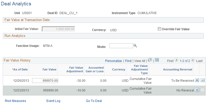

Deal Analytics Page
Use the Deal Analytics page (MTM_DEALVAL_PNL) to set up analytics for the deal.
Navigation:
Risk Management, and then Reevaluate Deals, and then Deal Analytics, and then Deal Analytics
This example illustrates the fields and controls on the Deal Analytics page, using an instrument type to calculate cumulative MTM.
Deal Analytics page
Analytic functions based on the instrument type can also be set on a specific deal to track the effects of various types of market risk against the deal's fair value.
Field or Control Description
Initial Fair Value
Displays the deal value as defined on the Deal Detail page (Deal Management, and then Capture Deals, and then Deals).
Override Fair Value
Select to override the initial fair value amount.
Function Usage
Displays the function usage, which is limited to a Mark to Market Adjustment. In the future, this field can be enabled to process function usages from third-party systems.
Mode
Represents a more granular method by which to establish diverse analytics function usages.
Risk Measures
Click this link to display values of risk measures calculated by analytic functions.
Event Log
Click this link to open the Event Log page, where you can review the details of events recorded on the deal.
Fair Value History
When you manually add a row to the Fair Value History grid, you should always click the Add button for the maximum As of Date row.
As of Date
Enter a date for the fair value.
Fair Value
Enter the market value as of the indicated date.
Fair Value Adjustment
Displays the system-calculated fair value adjustment.
Accounted Gain or Loss
Displays the accounted value that has been updated by the Treasury Accounting process.
Currency
Displays the currency used in the deal.
Fair Value Adjustment Type
Displays the fair value adjustment type associated with the deal, as defined on the Instrument Analytics page.
Accounting Reversal
Displays the status of the accounting reversal.
Delete Row icon
Click the Delete Row icon to delete a mark to market adjustment only for the maximum dated row. If an accounting entry has already been created for that row, then the system schedules a reversal of the accounting entry at the end upon saving. You can delete only one row at a time.

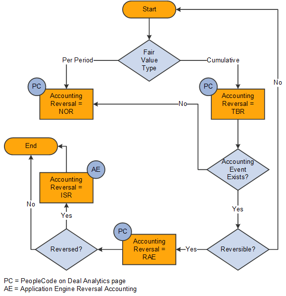

The diagram here illustrates the Mark to Market (MTM) Accounting process on the Deal Analytics page.
This diagram shows how the system updates the accounting reversal flag for mark to market adjustments.
Mark to Market Accounting Process for Deal Analytics
The system populates the Accounting Reversal field programmatically through code associated with the Deal Analytics component and the Reversal Accounting process. The following values in the Accounting Reversal field identify fair value adjustment rows that should be reversed or not:
  • No Reversal: The system uses NOR to identify all fair value adjustment rows that do not require reversal or no accounting event.
  • To Be Reversed: The system uses TBR to identify all cumulative fair value adjustment rows that will be reversed in future.
  • Reverse Accounting Entry: The system uses RAE to identify all cumulative fair value adjustment rows that have to be reversed in the next Reversal cycle.
  • Is Reversed: The system uses ISR to identify all cumulative fair value adjustment rows that have already been reversed.
