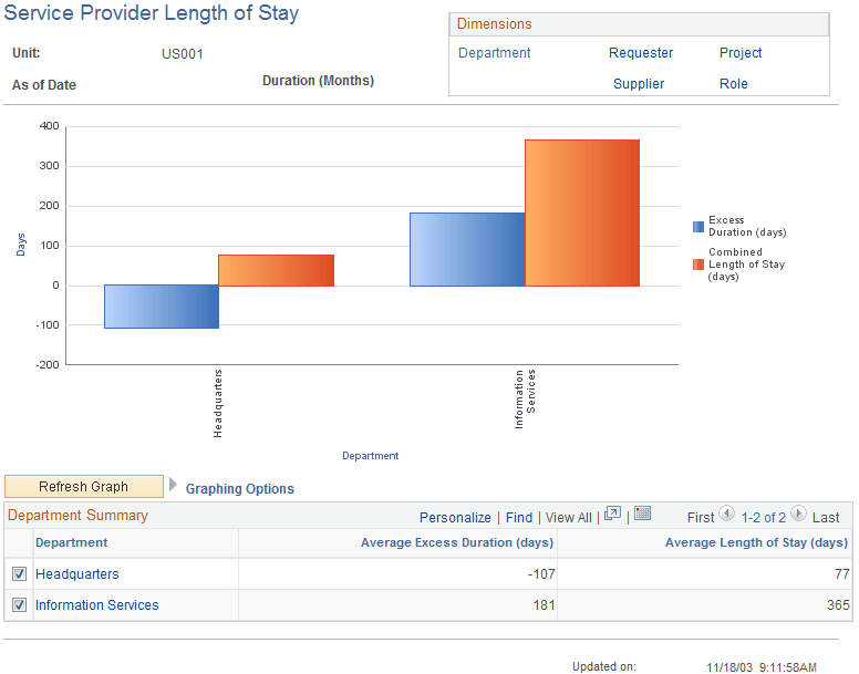

Service Provider Length of Stay (summary) Page
Use the Service Provider Length of Stay (summary) page (SPR_CONLOS_DASH_PG) to view service provider length-of-stay summary graphs and data.
Navigation:
Services Procurement, and then Interactive Reports, and then Define Length of Provider Stay
This example illustrates the fields and controls on the Service Provider Length of Stay (summary) page. You can find definitions for the fields and controls later on this page.

Department, Manager, Purchase Order, and Supplier
Click the link at the top of the page to have the system display the service provider length-of-stay graph and data by department, manager, purchase order, or supplier.
Graphing Options
Select the options in the collapsible Graphing Options group box to define the parameters that are used for the graph. You must select parameters of like measurements. For example, you cannot select one measurement based on time and another based on count.
The system displays an error message if you select parameters of different measurement types.
Refresh Graph
Click to display the graph by using the selected graphing options and data points.
Note: Each row of data with a selected check box that appears on the bottom of the page is used as a data point for the graph.
By default, the system graphs the first five selected data rows that appear in the grid. You can select more than five rows, but the information appears smaller on the graph.
