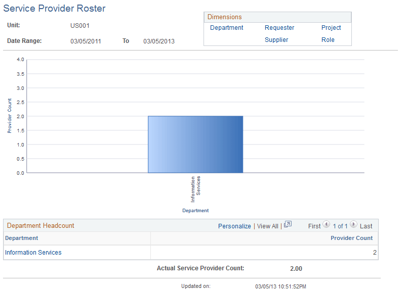

Service Provider Roster (summary) Page
Use the Service Provider Roster (summary) page (SPR_CONROS_DASH_PG) to view service provider roster summary graphs and data.
Navigation:
Services Procurement, and then Interactive Reports, and then Provider Roster
This example illustrates the fields and controls on the Service Provider Roster (summary) page. You can find definitions for the fields and controls later on this page.
Field or Control Description
Department, Manager, Purchase Order, and Supplier
Click the link at the top of the page to have the system display the service provider roster graph and data by department, manager, purchase order, or supplier.
Provider Count
Displays for each department the total number of service providers.
