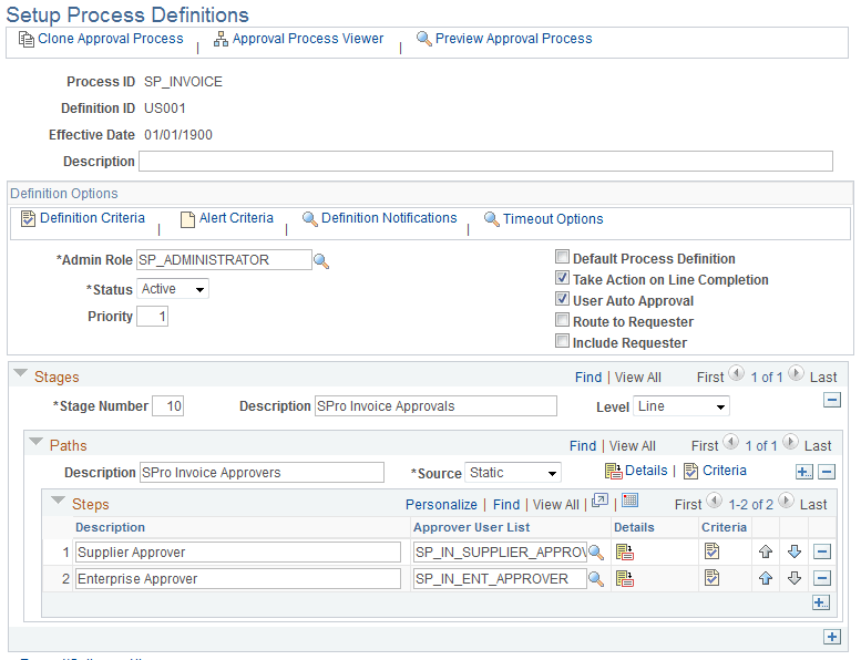

You can include suppliers in the workflow based on your arrangement with each individual supplier. In such cases, Approval Process has to include two steps (one for the Supplier Approver and the other for the Enterprise Approver). Approval will be routed to the Supplier approver first. Once approved, it will then be routed to the Enterprise Invoice approver. The screen shots below illustrate an example on how to setup Approval Process when Supplier is included in the Invoice Approvals. In such a case, the following minimum steps can be supplemented with your own additional setup to meet your organization’s workflow requirements. Also, note that the system routes a submitted invoice to the supplier invoice approver only if Include Supplier in Invoice Approval check box is selected on the Services Supplier Info page.
Approval Process Setup for Invoices
This example illustrates the fields and controls on the Setup Process Definitions page.

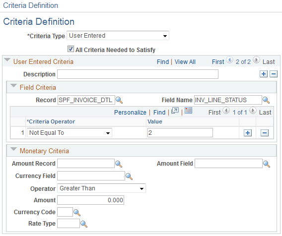

Path Criteria Setup
This example illustrates the fields and controls on the Criteria Definition Page.
Criteria Definition page
Important! In all cases (even when Supplier Approvals are Off), the Approval Criteria definition has to be Setup for a value of Invoice Line Status not equal to '2' in order to restrict already approved Lines being resubmitted for Approvals.

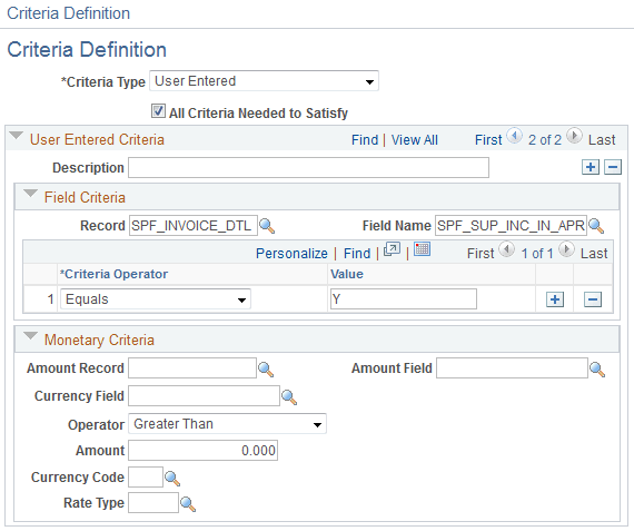

Step Criteria Setup for Supplier Approval
This example illustrates the fields and controls on the Criteria Definition for Supplier Approval page.
