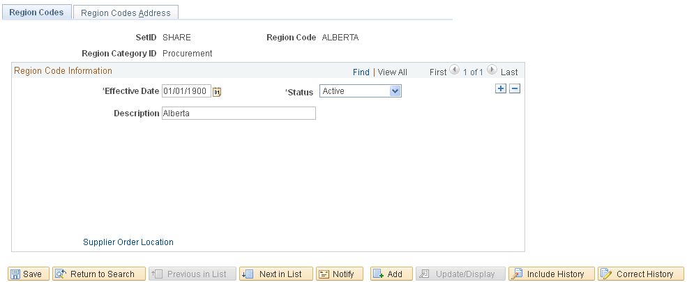

Region Codes Page
Use the Region Codes page (REGION_CD) to Define Services Procurement region codes.
Navigation:
  • Services Procurement, and then Define Services Procurement, and then General Setup, and then System-Wide Definitions, and then Service Region Code
  • Set Up Financials/Supply Chain, and then Product Related, and then Services Procurement, and then Service Regions/Ratesheets, and then Define Region and Rates
This example illustrates the fields and controls on the Region Codes page. You can find definitions for the fields and controls later on this page.
Region Codes page
After you enter information on the Region Codes page, you can select the Region Codes Address tab to enter related information on the Region Codes Address page.
Only regions with a category of procurement are used in PeopleSoft Services Procurement. Regions added from the link on the Define Services Procurement page are automatically created with a category of procurement.

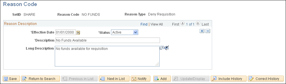

Reason Code Page
Use the Reason Code page (SPB_REASON_CD) to define reason codes related to each reason type.
Navigation:
  • Services Procurement, and then Define Services Procurement, and then General Setup, and then System-Wide Definitions, and then Service Reason Code
  • Set Up Financials/Supply Chain, and then Product Related, and then Services Procurement, and then Define sPro Reason Codes
This example illustrates the fields and controls on the Reason Code page. You can find definitions for the fields and controls later on this page.
Reason Code page
