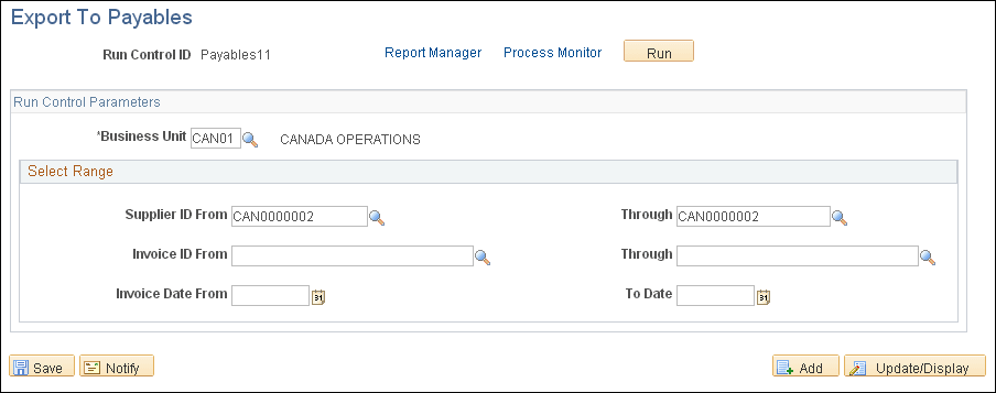

This example illustrates the fields and controls on the Export To Payables page.
Enter the run control parameters for exporting invoicing data.
