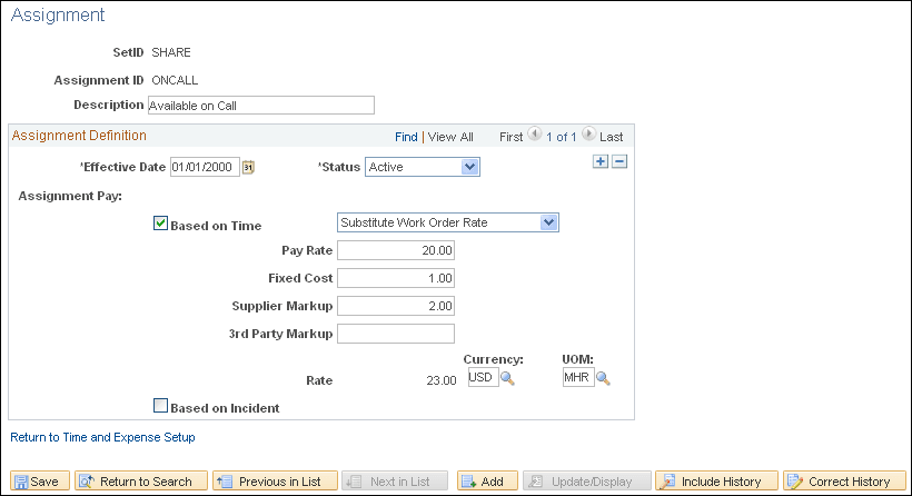

Assignment Page
SPB_ASSIGNMENT
Define assignments to be used on timesheets.
This page appears only if the Enable Assignments check box is selected on the Services Procurement Business Unit Definition page.

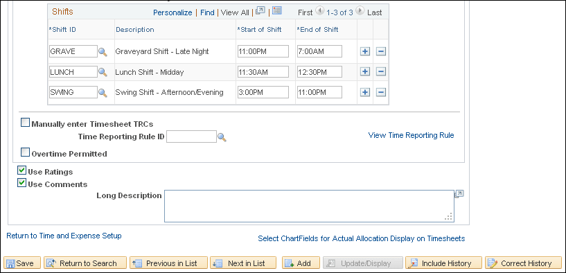

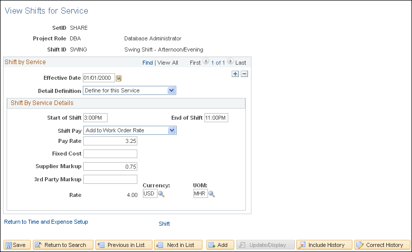

Shifts by Service Page
SPB_SHFT_BY_SRV
View and modify valid shifts that are associated with a specific service.

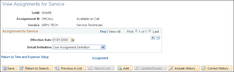

Assignments by Service Page
SPB_ASGN_BY_SRV
View or modify assignments that are associated with a specific service.
Service by Assignment

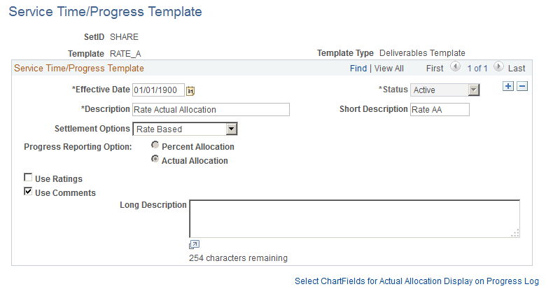

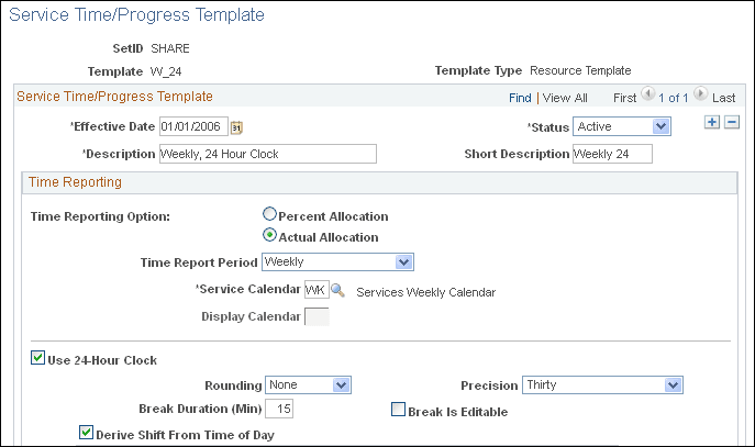

Service Time/Progress Template Page
SPA_TIME_TMPL_PG
Create services templates. Enter or modify options used in a timesheet to enter time and expense information and progress information.

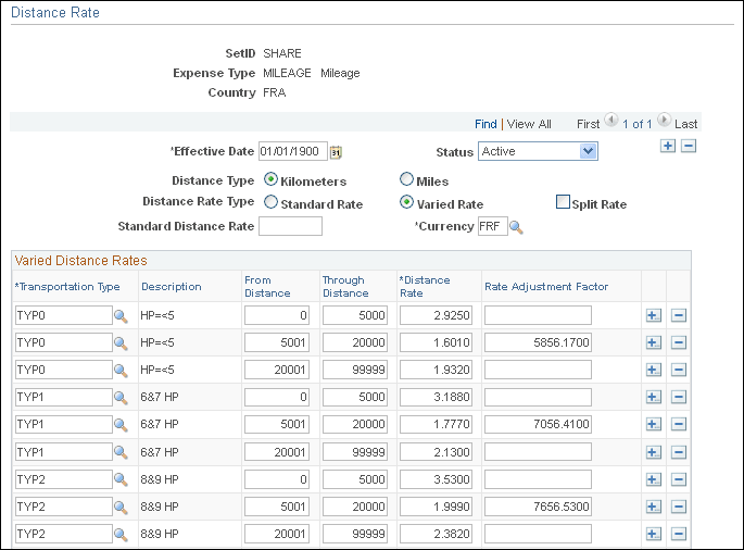

Distance Rate Page
EX_AUTO_RT_TBL
Define expense distance rates.

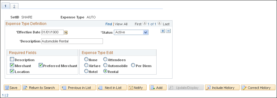

Expense Types1 Page
SPA_EXPENSE_TYPES1
Define expense types.

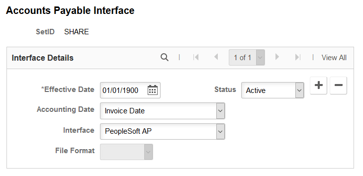

Accounts Payable Interface Page
SPA_AP_INTRFACE
Define accounts payable application interface information.

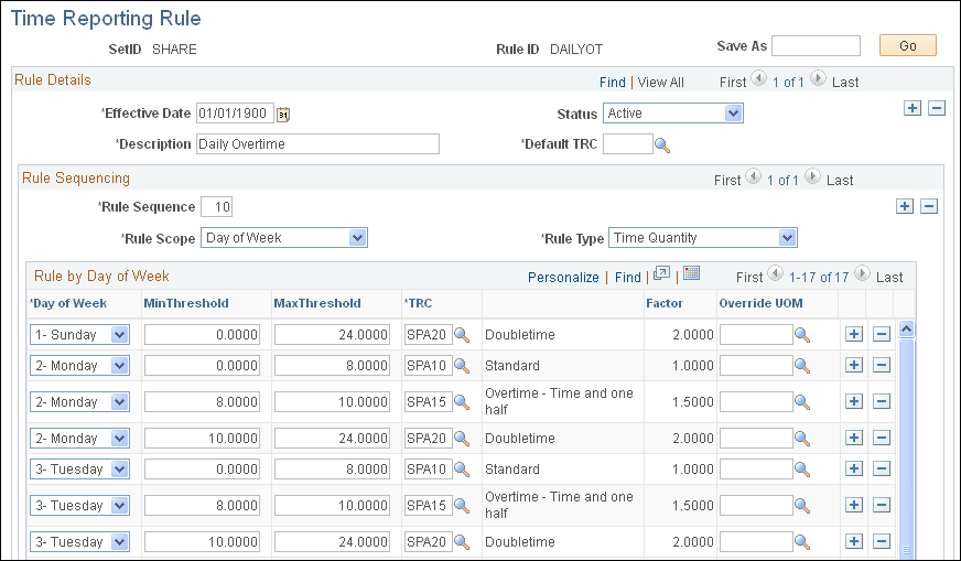

Time Reporting Rule Page
Use the Time Reporting Rule page (SPA_TIMERPT_RUL) to define rules for reporting time.
Navigation:
  • Services Procurement, and then Define Services Procurement, and then Settlement Setup, and then Time and Expense Setup, and then Time Reporting Rule
  • Set Up Financials/Supply Chain, and then Product Related, and then Services Procurement, and then Time and Expense, and then Time Reporting Rule
This example illustrates the fields and controls on the Time Reporting Rule page.
Rule Details
Field or Control Description
Description
Enter a long description to identify the time reporting rule.
Default TRC (default time reporting code)
Select a default TRC to use when the time reporting rule does not meet the rule criteria.
Rule Sequence
Rule Sequence
Enter a rule sequence number. This value is used to determine the order the system validates and applies the rule criteria to a timesheet. Since the rule sequence numbers are incremental, be sure to prioritize the rule in the order in which you want the system to evaluate and validate the TRC codes to use for time reporting.
Note: Always identify the most important rules at the lowest rule sequence to ensure that the system picks up those rules first. If you define a priority rule at higher sequence number and the system validates another rule that qualifies at a lower sequence number, the system uses the lowest rule sequence to populate the timesheet.
For example, if you create a rule with specific capture dates (as in the case of holidays), always be sure to define those dates first. The system starts at the most current rule sequence and works its way down the list. Also, if you want to be sure that there is always a valid rule in place, identify the "catch-all" rule as the last rule in the sequence. That way, you are always sure that there is a valid rule in the sequence.
Rule Scope
Select the time scope that this rule sequence covers.
Values include Date, Day of the Week, and Time Period.
Rule Type
Select the type for this rule sequence.
Values include Time Quantity and TRC List.
Rules by Date
Date
Enter the date for which this rule applies.
Min Threshold (minimum threshold)
Enter minimum quantity of hours for this rule.
Max Threshold (maximum threshold)
Enter the maximum quantity of hours fro this rule.
TRC (time reporting code)
Select a value to use with this time reporting rule.
Override UOM (override unit of measure)
Select an alternative UOM to use as an override on the work order. Use this UOM to calculate a different rate on the work order.
Blackout
Select to prevent time from being entered for the specified day.
Note: This option is only available for the rule type of TRC List.
Rules by Day of the Week
Day of Week
Enter a day of the week to create a time reporting rule.
Values include:
  • Sunday
  • Monday
  • Tuesday
  • Wednesday
  • Thursday
  • Friday
  • Saturday
Rules by Time Period
Time Period
Enter a time period to create a time reporting rule.
Values include Bi-Monthly, Daily, Monthly, Semi-Monthly, and Weekly.

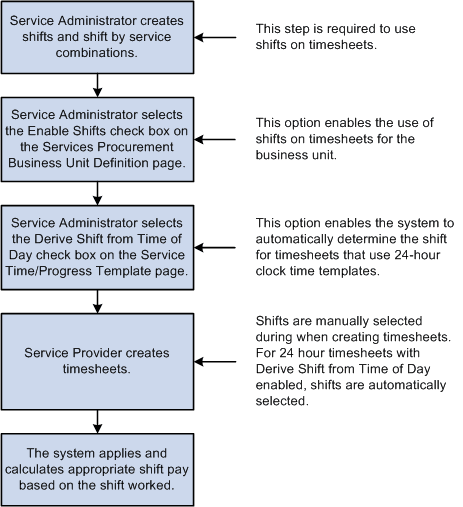

Using Shifts on Timesheets
The following diagram illustrates the steps involved in defining shifts that can be used on timesheets:
Steps to define shifts that can be used on timesheets

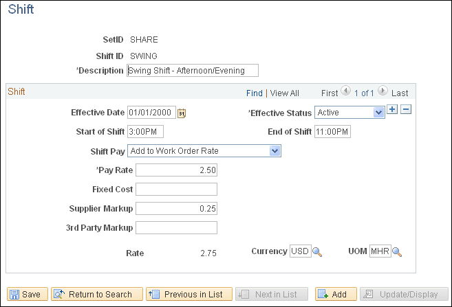

Shifts Definition
Shift Page
Use the Shift page (SPB_SHIFT) to define shifts to be used on timesheets.
Navigation:
Services Procurement, and then Define Services Procurement, and then Settlement Setup, and then Time and Expense Setup, and then Shifts
This example illustrates the fields and controls on the Shift page.
Shift page
These settings are defined at the SetID level.
The fields that appear on this page depend upon the value selected for the Shift Pay field.
The Document Service and Service Type labels will differ if Enterprise Human Capital Management is installed.
SetID
Select the SetID that will be able to use this shift.
Shift ID
Enter a name for the shift.
Description
Enter a description for the shift. This is a required field.
Effective Date
Enter the date that the shift will become effective. The current date is the default value. This is a required field.
Add effective-dated rows for each Shift Pay type as required.
Effective Status
Select Active (default) or Inactive. This determines if this shift will be available for use on timesheets. Only shifts with a status of Active will be available for use. This is a required field.
Note: If you change an Active shift to Inactive, the system will issue a warning message if there are any existing shift and service combinations for the effective-dated shift.
Shift Start Time and Shift End Time
(Optional) Enter the start and end times for the shift. Shift pay is paid for work performed during this time period. You can leave this blank and the system will automatically select the shift based on the start and end times entered on the timesheet.
Note: Start and stop times are for informational purposes only. If the 24-hour clock time template is used and the Derive Shift Based From Time of Day option is selected, then the system automatically populates the default time values in this fields. However, these start and stop times can still be modified at the template definition level.
Shift Pay
Select a value to indicate the basis for the shift pay calculation:
  • Add to Work Order Rate: Shift pay is added to the work order rate for this shift.
  • Add % of Work Order Rate: Shift pay is defined as a percentage of the work order rate.
    You must enter percentage rate in the Shift Percent field.
  • Substitute Work Order Rate: Shift pay rate will replace the work order rate for this shift.
Shift Pay Rate Percentage
Enter a negative or positive percent value for the shift pay rate. This is a required field and is used with the Add % of Work Order Rate value.
Shift Pay Rate Amount
Enter a negative or positive amount. If pay types are not selected, then this is a single rate. If pay types are selected, this rate must be broken out into the Pay Rate, Fixed Cost, Supplier Markup, and Third-Party Markup fields that appear. This is a required field and is used with the Add to Work Order Rate or Substitute Work Order Rate values.
Shift Pay Rate Currency
Enter the currency code for this shift pay rate. This field works with the Add to Work Order Rate or Substitute Work Order Rate values.
Shift Pay Rate UOM (unit of measure)
Enter the unit of measure for this shift pay rate. This field works with the Add to Work Order Rate or Substitute Work Order Rate values.
Use the Shifts by Service page (SPB_SHFT_BY_SRV) to view and modify valid shifts that are associated with a specific service.
Navigation:
Services Procurement, and then Define Services Procurement, and then Settlement Setup, and then Time and Expense Setup, and then Shifts by Service
This example illustrates the fields and controls on the Shifts for Service page.
This page identifies the shifts that are valid for a particular service. Only shifts associated to the service can be associated to time reported against a work order for that service. In addition, for 24-hour clock time entry, only shifts that are associated to the time template can be associated to the time reported.
Shift by Service Details
Project Role
Select a value for this service (job) code.
Shift ID
Select the shift to be associated with this service.
Effective Date
Enter the effective date for this service. This is a required field.
Detail Definition
Select a method to use for defining details of the shift. Values are:
  • Define for Service: Indicates that the shift is available for use with this service as of the effective date.
    The service and shift combination will have specific times and rates defined.
    Note: The Description group box appears when you select this option.
  • No Longer Valid for Service: Indicates that the shift is no longer available for use as of the effective date.
  • Use Shift Definition: Indicates that the shift is available for use with the service as of the effective date.
    The shift times and rates from the Shift Definition will be used for this service.
Description
Start of Shift and End of Shift
(Optional) Enter the beginning and ending times for the shift.
Note: Start and stop times are for informational purposes only. If the 24-hour clock time plate is used and the Derive Shift Based From Time of Day option is selected, then the system automatically places default time values on this fields. However, these start and stop times can still be modified at the template definition level.
Shift Pay
The default values come from the Shift definition page but you can modify it here. Values are:
  • Add to Work Order Rate: Shift pay rate will be added to the work order rate for this shift by service.
  • Substitute Work Order Rate: Shift pay rate is substituted for the work order rate.
    If you select this option, can only enter a positive amount in the Pay Rate field.
Pay Rate
This required field is available if you select Add to Work Order Rate or Substitute Work Order Rate.If you selected the Add to Work Order Rate, you must enter a positive or a negative amount in this field, If you selected the Substitute Work Order Rate value, you must enter a positive amount.
Shift Percent
You must enter a positive or a negative percent in this field if you selected the Add % of Work Order Rate value. This is a required field.
Currency
You must enter a value in this field if you selected the Add to Work Order Rate or Substitute Work Order Rate option.
This field is available if you select the Add to Work Order Rate or Substitute Work Order Rate value. This is a required field.
Shift
Click this link to access the Shift definition page for this specific shift.

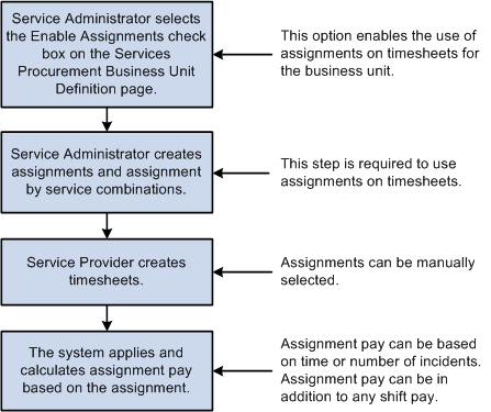

Using Assignments on Timesheets
The following diagram illustrates the steps involved to define assignments that can be used on timesheets:
Define assignments that can be used on timesheets
Assignments Definition
Assignment Page
Use the Assignment page (SPB_ASSIGNMENT) to define assignments to be used on timesheets.
Navigation:
Services Procurement, and then Define Services Procurement, and then Settlement Setup, and then Time and Expense Setup, and then Assignments
This example illustrates the fields and controls on the Assignment page.
Assignment page
The fields that appear on this page depend upon the value selected for the Assignment Pay field.
SetID
Select the SetID that will be able to use this assignment.
Assignment ID
Enter a name for the assignment.
Description
Enter a description for the assignment.
Assignment Definition
Effective Date
Enter the date that the assignment will become effective. The current date is the default value. This is a required field.
Add effective-dated rows for each Assignment Pay type as required.
Status
Select Active (default) or Inactive. This determines if this assignment will be available for use on timesheets. Only assignments with a status of Active will be available to associate with services or on timesheets. This is a required field.
Note: If you change an Active assignment to Inactive, the system will issue a warning message if there are any existing assignment and service combinations for the effective-dated assignment.
Assignment Pay
Select the value on which the assignment pay calculation should be based. Values are Based on Time or Based on Incident.
  • Based on Time: This option indicates that some or all of the assignment rate is based on the time spent on the assignment.
  • Based on Incident: This option indicates that some or all of the assignment rate is based on the number of incidents for the assignment.
If you select Based on Time, select a value as the basis for time associated with the assignment:
  • Add to Work Order Rate: The assignment rate will be added to the work order rate.
    If you select this option, you must enter a negative or a positive value in the Pay Rate field that appears.
    Note: If pay types are not enabled, this is a single rate. If pay types are enabled, the Pay Rate must be broken out into the Pay Rate, Fixed Cost, Supplier Markup, and 3rd Party Markup fields that appear on the page.
  • Add % of Work Order Rate: The assignment rate is a percent of the work order rate.
    If you select this option, you must enter a negative or positive value in the Percent field.
  • Substitute Work Order Rate: The assignment rate will replace the work order rate.
    If you select this option, you must enter a positive value in the Pay Rate field.
Rate
This display-only field shows the total of the Pay Rate, Fixed Cost, Supplier Markup, and 3rd Party Markup fields.
Currency
Enter the currency associated with the assignment pay rate. This field is available if you select the Add to Work Order Rate or Substitute Work Order Rate option.
Enter the unit of measure associated with the assignment pay rate. This field is available if you select the Add to Work Order Rate or Substitute Work Order Rate option.
If you select Based on Incident, you must break down the assignment pay amount into these fields.
The total of these fields should add up to the total assignment pay amount.
  • Pay Rate
  • Fixed Cost
  • Supplier Markup
  • 3rd Party Markup
Rate
Currency
The value in this display-only field comes from the assignment currency.
Use the Assignments by Service page (SPB_ASGN_BY_SRV) to view or modify assignments that are associated with a specific service.
Navigation:
Services Procurement, and then Define Services Procurement, and then Settlement Setup, and then Time and Expense Setup, and then Assignments by Service
This example illustrates the fields and controls on the Assignments by Service page.
Assignment ID
Enter a description for this assignment by service.
Service
Enter the service code.
Assignment by Service
Effective Date
Detail Definition
Select a method to use for defining details of the assignment by service combination. Values are:
  • Define for Service: Indicates that the assignment is available for use with this service as of the effective date.
    The service and assignment combination will have specific times and rates defined.
  • No Longer Valid for Service: Indicates that the assignment is no longer available for use as of the effective date.
  • Use Assignment Definition: Indicates that the assignment is available for use with the service as of the effective date.
    The shift times and rates from the Assignment definition page will be used for this service.
Description
Assignment Pay
Select the method on which to base the assignment pay. Values are:
  • Based on Time: Assignment pay will be based on the beginning and end times of the assignment.
    You can select one of these values to calculate the assignment pay:
    • Add to Work Order Rate: Assignment pay rate will be added to the work order rate for this assignment by service combination.
    • Add % of Work Order Rate: Assignment pay is defined as a percentage of the work order rate.
    • Substitute Work Order Rate: Assignment pay rate is substituted for the work order rate.
  • Based on Incident: The assignment pay will be based on the number of incidents.
    If you select this option, you must enter values for the Pay Rate, Fixed Cost, Supplier Markup, and Third-Party Markup fields.
Pay Rate
This required field is available if you select Add to Work Order Rate or Substitute Work Order Rate. If you selected the Add to Work Order Rate, you must enter a positive or a negative amount in this field, If you selected Substitute Work Order Rate, you must enter a positive amount.
Percent
Currency
Assignment
Click this link to access the Assignment definition page for this specific assignment.
Use the Service Time/Progress Template page (SPA_TIME_TMPL_PG) to create services templates.
Navigation:
  • Services Procurement, and then Define Services Procurement, and then Settlement Setup, and then Time and Expense Setup, and then Service Time/Progress Template
  • Set Up Financials/Supply Chain, and then Product Related, and then Services Procurement, and then Time and Expense, and then Service Time/Progress Template
This example illustrates the fields and controls on the Service Time/Progress Template page.
Service Time/Progress Template page (1 of 2)
Service Time/Progress Template page (2 of 2)
If a timesheet has been created using a service time/progress template, the system displays a message on the template page. The message indicates that the template has been used in the creation of a timesheet and that some fields for effective-dated rows have been disabled. The system also makes the Status and Time Reporting Option fields unavailable on the page when a work order has been created against the time template.
Time Reporting
Use this option to determine whether a resource based work order requires the service provider to report time against specific ChartFields, or whether the total time is entered and distribution percentages automatically split time or progress according to the ChartField distribution defined for the work order. Values are:
  • Actual Allocation: Select to enable the service provider to report actual time against each ChartField distribution line defined on the work order.
  • Percent Allocation: Select to enable the service provider or service provider contact to report total time or progress against a work order.
    The distribution percentage is used to automatically allocate time or progress across the predefined ChartField distribution lines.
Time Reporting Period
Select a period that indicates how often service providers enter their work hours. The default value is Weekly. Other values are Daily, Bi-Weekly, Semi-Monthly, and Monthly.
Note: When you select a the monthly time reporting option, the Display Calendar field is editable. You must select a display calendar to chunk monthly reporting properly.
Service Calendar
Select a service calendar for the time reporting period. Use this calendar as a detail for how the organization reports time during the calendar year. Values are:
  • Bi-Weekly
  • Daily
  • Monthly
  • Semi-Monthly
  • Weekly
Display Calendar
Select an appropriate calendar display option.
Use this option to determine how the calendar is displayed for the time reporting period. For example, if you select Monthly as the time reporting option, you may want to display the calendar on a weekly basis.
Use 24-Hour Clock
Select this option if you want time logged using the 24-hour clock. You select this check box if you want to pay providers shift differential using shifts.
If you select to use a 24-hour clock, the system disables other entry fields.
Rounding
Select whether you want to round up or down to the hour. Select None if you do not want to round the minutes.
Precision
Select the number of precise minutes for rounding. Values are Six, Twelve, Fifteen, Twenty, and Thirty.
Break Duration (Mins) (break duration - minutes)
Enter the break duration in number of minutes. The break duration is subtracted from the total time difference between the start and end dates. For example, if you have a start time of 8:00 a.m. and end time of 5:00 p.m. with a 30-minute break duration, 8.5 hours are recorded for the day.
Break is Editable
Select to indicate that the break is not mandatory.
Derive Shift From Time of Day
Select this option if you want the system to automatically derive the shift depending upon the time of day. This option is used with 24-hour clocks only. You use the Derive Shift From Time of Day check box in conjunction with the shift and assignments functionality.
Shifts
This group box appears when you select Derive Shift From Time of Day. Use this group box to associate specific shifts with this time service template.
These default values come from the Shift definition page, but you can override the values here. These are required fields.
Note: Start and end times cannot fall within the ranges for another shift for the sample template.
Allow for more than 24 hours
Select if a service provider is enabled to enter more than 24 hours for a single project, work order, activity, and day. You can use this option for team reporting instead of individual reporting.
Note: When you select this option, the Rounding, Default Start Time, Default Stop Time, Break Duration, Precision, and Break is Editable fields are available.
Manually enter TimeSheet TRCs(manually enter timesheet time reporting codes)
Select this check box to indicate that you want to manually enter TRCs for timesheets. The check box controls whether time reporting codes are assigned manually by the service provider during time entry or automatically assigned by the system based on predefined rules. You cannot assign a time-reporting rule to a template if this check box is selected. The Derive Shift From Time of Day check box is available if you do not select to manually enter timesheet TRCs. If you select to manually enter timesheet TRCs, the check box is not available.
Note: When editing an existing time template, you cannot change the setting of the Manually enter Timesheet TRCs check box if there are already timesheets associated to the template. When a template is already in use, the system low-lights entry fields.
Time Reporting Rule ID
Select a time reporting rule to use for calculating different payouts. This field is not available if you select the Manually enter Timesheet TRCs check box.
Note: To use this feature, you must first define the time reporting rules on the Time Reporting Rules page.
View Time Reporting Rules
Click to view the time reporting rule associated with this service template.
Overtime Permitted
Select to indicate if a requisition allows overtime.
This is an informational field only.
Use Ratings
Select if the performance of a service provider during the time period is to be rated.
Note: This check box is only accessible if the Use Ratings check box on the Services Procurement Business Unit Definition page is selected.
Use Comments
Select to enable service providers and provider contacts to enter comments or concerns on the timesheet and progress log.
Select ChartFields for Actual Allocation Display on Timesheets
Select the ChartFields to display on the timesheet.
The values from the selected ChartFields will be used to allocate time on distribution lines.
Note: This option is only available when you select Actual Allocation as the time reporting option.
This example illustrates the fields and controls on the Service Time/Progress Template page. You can find definitions for the fields and controls later on this page.
Settlement Options
View the settlement method for a work order, which is based on the service selected. Progress will be recorded based on the method defined. Values include:
  • Fixed Amount: Progress payments are made against milestone activities where the supplier enters the amount to be paid on the progress logs.
    You can record progress multiple times against the same milestone for work order to allow payment upon partial completion of a activity.
  • Milestone: Payments are made when agreed upon milestones are met.
    For example, you could agree to pay the construction company 25 percent of the total fee when the foundation is complete. The supplier can only select each milestone activity once for completion.
  • Percentage: Payments are made based on the percentage of completion for the total work order amount entered on the progress log.
  • Rate Based: Payments are based on an agreed upon rate for service activities.
    For example, you could agree to pay a contractor pouring concrete a specific rate per cubic foot. For this example, the actual cubic feet poured is entered in the progress log and the payment is based on that agreed rate.
    Note: This field applies to deliverable-based work orders only.
Progress Reporting Option
Use this option to associate the reporting options (Percentage/Actual) with Progress templates for each Settlement Option . This field is available only for Deliverable template type.
The reporting options selected here controls the Template you select in a Work order.
Distance Rate Page
Use the Distance Rate page (EX_AUTO_RT_TBL) to define expense distance rates.
Navigation:
  • Services Procurement, and then Define Services Procurement, and then Settlement Setup, and then Time and Expense Setup, and then Expense Distance Rate
  • Set Up Financials/Supply Chain, and then Product Related, and then Expenses, and then Management, and then Establish Mileage Rate
This example illustrates the fields and controls on the Distance Rate page.
Distance Rate page
You can set up standard and varied distance rates in different base currencies with each combination tied to an expense type. When service providers use their automobiles for business purposes, you can reimburse them based on how far they must drive.
Distance Rate Type
Select Standard Rate to indicate a uniform reimbursement rate regardless of transportation type.
Select Varied Rate to indicate reimbursement rates that depend on the transportation type.
Standard Distance Rate
Enter the monetary amount that is to be reimbursed per unit driven, if you selected Standard Rate.
Varied Distance Rates
Transportation Type and Distance Rate
If you selected Varied Rate, enter a distance rate to define the monetary amount that is reimbursed for the transportation type per unit driven.
Rate Adjustment Factor
Enter an adjustment factor that the system applies for the transportation type.
Expense Types1 Page
Use the Expense Types - Expense Types1 page (SPA_EXPENSE_TYPES1) to define expense types.
Navigation:
  • Services Procurement, and then Define Services Procurement, and then Settlement Setup, and then Time and Expense Setup, and then Expense Type
  • Set Up Financials/Supply Chain, and then Product Related, and then Services Procurement, and then Time and Expense, and then Define Expense Types
This example illustrates the fields and controls on the Expense Types1 page.
Expense Types1 page
Required Fields
Description, Merchant, Preferred Merchant, and Location
Select each option to appear as a required field on the expense sheet that a service provider completes for the expense type.
To define an expense location amount for this expense type, select the Location check box to make it a required field on the expense sheet.
Use the Accounts Payables Interface page (SPA_AP_INTRFACE) to define accounts payable application interface information.
Navigation:
  • Services Procurement, and then Define Services Procurement, and then Settlement Setup, and then Invoicing Setup, and then Accounts Payables Interface
  • Set Up Financials/Supply Chain, and then Product Related, and then Services Procurement, and then AP Interface
This example illustrates the fields and controls on the Accounts Payable Interface page. You can find definitions for the fields and controls later on this page.
Accounting Date
Select an Accounting Date.
  • Invoice Date: If you select this option, the Accounting Date displayed on the voucher will be the date on which the invoice was created.
  • Approval Date: If you select this option, the Accounting Date displayed on the voucher will be the date on which the invoice was approved.
Interface
Select Other to indicate a third-party application. Select PeopleSoft AP to indicate that you use PeopleSoft Payables.
File Format
PeopleSoft Services Procurement uses comma-separated values as its only file format. If you select Other as the interface, the system exports invoice data to a flat file using this format, which you can use to export to your accounts payable system for invoice voucher generation.
If you select PeopleSoft AP as the interface, this field is disabled, because it is not applicable.
