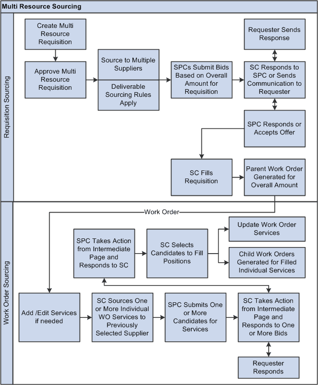

The next diagram illustrates how a multi-resource requisition flows through sourcing or can be associated with a work order for sourcing:
How a multi-resource requisition flows through sourcing or can be associated with a work order for sourcing
Sourcing multi-resource requisitions
A multi-resource requisition flows through sourcing and can be associated with a work order for sourcing. During requisition sourcing, the system fills the parent requisition line before the services are sourced to the supplier. Similar to a deliverables-based requisition, additional details about the services are under the parent line. The service coordinator has to source the parent line to suppliers first. Suppliers are setup based on the parent service type. Supplier selection rules are the same for the requisition as a deliverables-based requisition.
After the parent requisition is filled or closed, the service coordinator can then source the requisition service lines one at time or in combination. Sourcing parameters such as, notification and submittal limits, are brought in as default values from the parent line. Service coordinators can access individual services to modify the parameters for a service line.
