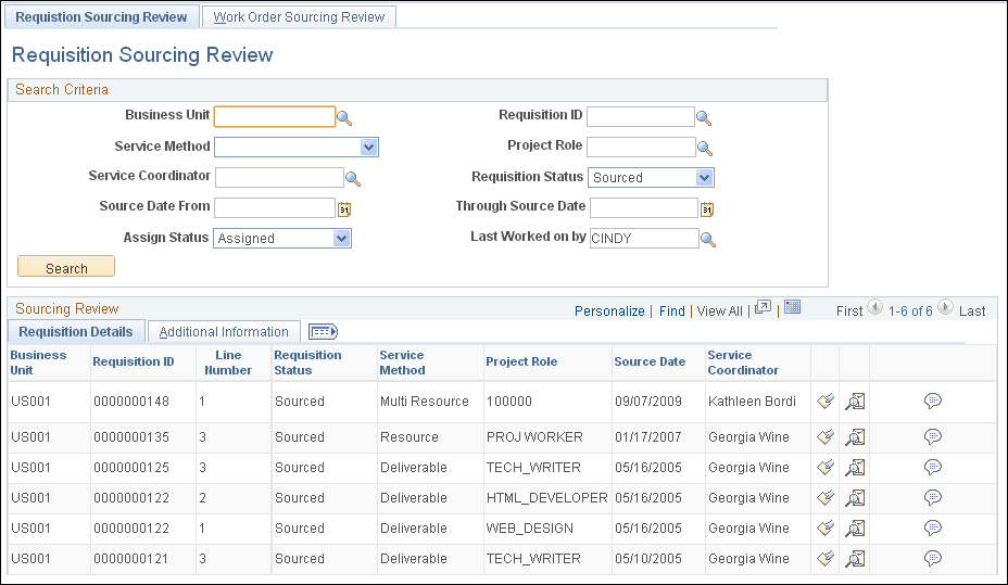

Requisition Sourcing Review Page
Use the Requisition Sourcing Review page (SPF_SOUR_REVIEW_SP) to review requisitions sourced to the supplier.
Navigation:
Services Procurement, and then Submit Bids
This example illustrates the fields and controls on the Requisition Sourcing Review page. You can find definitions for the fields and controls later on this page.
Use the Search Criteria group box at the top of the page to enter specific search criteria for requisitions that have been sourced to the supplier. You can search by business unit, requisition ID, service coordinator, as well as various other search criteria. After you enter the specific search criteria, click the Search button to view the results.
This page displays only the main top-line (parent) requisition line if you are viewing a multi-resource requisition. Information about the related child requisition lines is available on the bid page when you click the Submit Bid button.
Use the Sourcing Review section in the bottom portion of the page to view requisitions that were sourced to suppliers. Select the Additional Information tab to review more details about the requisition. These details include the number of positions, positions available, and those filled. The details also include the number of times that a bid has been submitted against the requisition and the maximum number of bids allowed for the requisition.

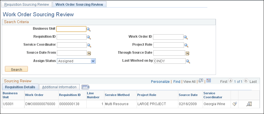

Work Order Sourcing Review Page
Use the Work Order Sourcing Review page (SPF_SOUR_RVW_WO_SP) to review work orders sourced to the supplier.
Navigation:
Select the Work Order Sourcing Review tab on the Requisition Sourcing Review page.
This example illustrates the fields and controls on the Work Order Sourcing Review Page. You can find definitions for the fields and controls later on this page.
Work Orders Sourcing Review page
Use the Search Criteria group box at the top of the page to enter specific search criteria. You can search by business unit, work order ID, requisition ID, or service coordinator, as well as various other search criteria. After you enter specific search criteria, click the Search button to view the results.
Use the Sourcing Review section in the bottom portion of the page to view work orders that have been sourced to suppliers by service coordinators. Select the Additional Information tab to review more details about the work order. These details include the number of positions, positions available, and those filled. The details also include the number of times that a bid has been submitted against the work order and the maximum number of bids allowed for the work order.
