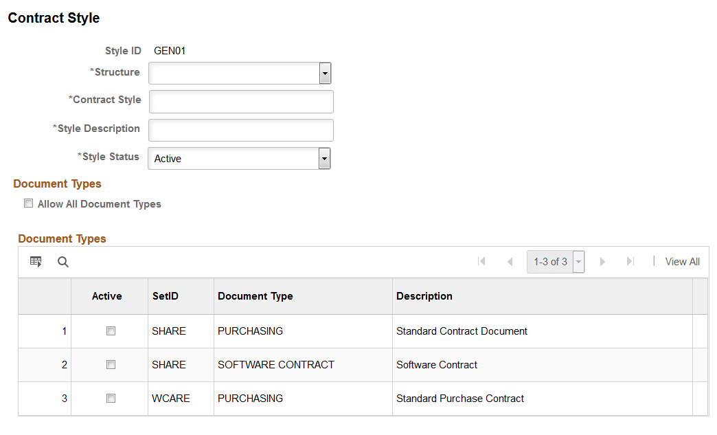

Contract Style page
Use the Contract Style page (CNTRCT_STYLE) to manage user access to contract fields.
Navigation:
Set Up Financials , and then Product Related, and then Procurement Options , and then Purchasing, and then Contract Style
This example illustrates the fields and controls on the Contract Style page. You can find definitions for the fields and controls later on this page.
Contract Style page (1 of 2)
Contract Style page (2 of 2)
Field or Control Description
Style ID
Displays the style ID you entered for the contract.
This ID can accommodate up to 10 characters.

Contract Style
Enter a name for your contract style.
This name can accommodate up to 30 characters.
Note: The Style ID and Contract Style are interchangeable, when you are on the procurement pages. Contract Style appears as the field name, but in some cases the Style ID appears in the selected prompt search result. The Contract Style is used as the title for the fluid page and also appears on the procurement contract and supplier contracts pages.
Style Description
Displays the style description used for the contract.
Process Option
For procurement contracts this displays the process option that corresponds to the structure type.
Style Status
You can choose to inactivate or activate the status.
This field is Active by default.
Once a contract style is inactivated you will still be able to maintain contracts using this contract style but you will not be able to create new contracts or documents using this style.
Document Types
This section appears when Supplier Contracts is installed and you are using Document Types. Select the Allow All Document Types option to enable this contract style to work with all Supplier Contract Document Types.
If you do not select the Allow All Document Types option, the system displays the available document types and you can activate the ones you want to work with this contract style. If a Document Type is activated, and then later inactivated, it will prevent any new documents from being created using that combination of contract style and Document Type. You must have at least 1 active Document Type selected if the Allow All Document Types is checked
Once a Contract Style has been used on a document, the Document Type used for that document cannot be removed from the Contract Style.

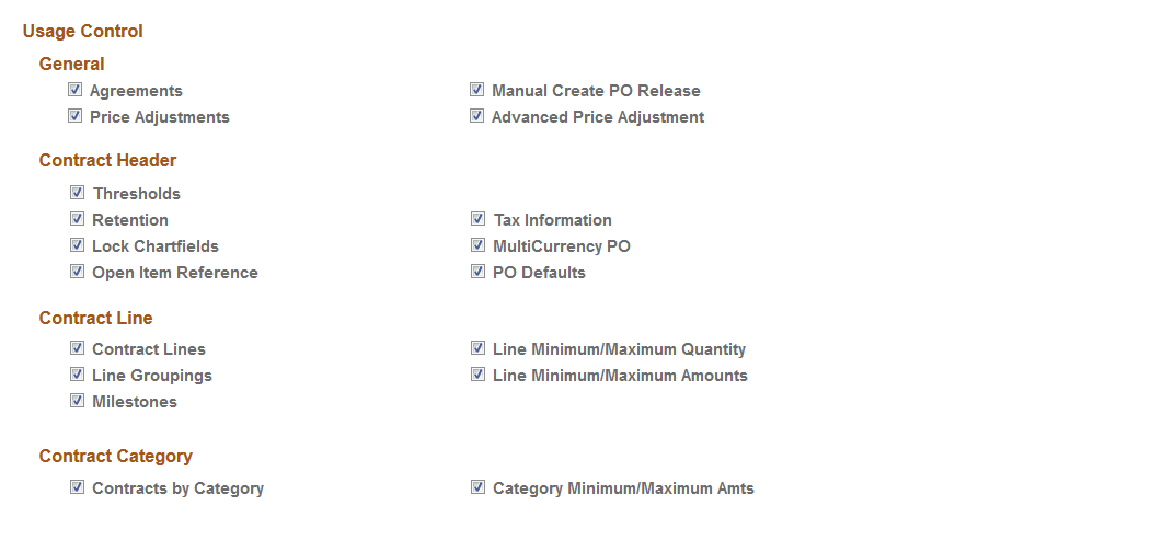

Usage Control
Use this group box to manage user access to contract fields using the available field-control options.
PeopleSoft provides the following field-control options:
  • Agreements
  • Price Adjustments
  • Manual Create PO Release
  • Advanced Price Adjustment
  • Notifications
  • Retention
  • Lock Chartfields
  • Open Item Reference
  • Tax Information
  • MultiCurrency PO
  • PO Defaults
  • Contract Lines
  • Line Groupings
  • Milestones
  • Line Minimum/Maximum Quantity
  • Line Minimum/Maximum Amounts
  • Contracts by Category
  • Category Minimum/Maximum Amts
These options correspond to specific fields on the contract.
Select an option to include the corresponding fields on the contract. Deselect an option to exclude the corresponding fields on the contract.
The structure type determines the field-control options available to you. Some structure types do not include all field-control options.
