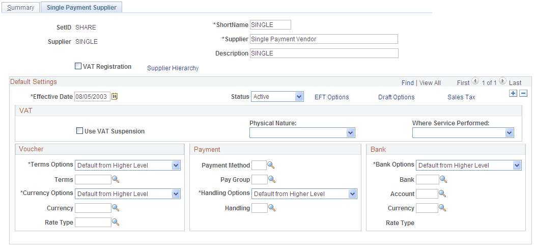

Single Payment Supplier Page
Use the Single Payment Supplier page (VNDR_DEFL_MASTER) to create a single payment supplier master to be used as the default supplier for creating single payment vouchers.
Navigation:
Suppliers, and then Supplier Information, and then Add/Update, and then Supplier, and then Single Payment Supplier
Select Single Payment Supplier in the Persistence field on the Supplier Information search page.
This example illustrates the fields and controls on the Single Payment Supplier page. You can find definitions for the fields and controls later on this page.
Enter a short name, name, and description.
Field or Control Description
VAT Registration
Select if the supplier master should be enabled for VAT.
Details
Click to open the VAT Registration Details page, where you can enter the VAT registration information for the supplier.
VAT Service Treatment Setup
If you are using services VAT treatment, click to open the Services VAT Treatment Defaults Setup component, to review and, as applicable, enter services VAT treatment settings for the supplier.
Note: You must save the supplier before you can access the Services VAT Treatment Defaults Setup component for the supplier.
VAT Default
Click to open the VAT Defaults Setup component, to review and, as applicable, enter VAT settings for the supplier.
Note: You must save the supplier before you can access the VAT Defaults Setup component for the supplier.
EFT Options
Click to open the EFT Payment Options page, where you can define the EFT information for the single payment supplier.
Draft Options
Click to open the Draft Options page, where you can define the draft processing information for the single payment supplier.
Sales Tax
Click to open the Tax Options page, where you can define the sales and use tax options for the single payment supplier.
Voucher
Terms Options and Terms
Select Default if you want the payment terms on vouchers to default from higher in the PeopleSoft Payables control hierarchy. Select Specify if you want the voucher to inherit the payment terms you enter here in the Terms field.
Currency Options, Currency, and Rate Type
Select Default if you want the currency code and rate type on vouchers to default from higher in the PeopleSoft Payables control hierarchy. Select Specify if you want the voucher to inherit the currency code and rate type you enter here in the Currency and Rate Typefields.
Payment
Payment Method
Specify a payment method:
  • Automated Clearing House.
  • Draft - Customer EFT.
  • Draft - Customer Initiated.
  • System Check.
  • Direct Debit.
  • Draft - Supplier Initiated.
  • Electronic Funds Transfer.
  • Giro - EFT.
  • Giro - Manual.
  • Letter of Credit.
  • Manual Check.
  • Wire Transfer.
Pay Group
Specify a supplier pay group.
Handling Options
Select Default if you want the payment handling code on vouchers to default from higher in the PeopleSoft Payables control hierarchy. Select Specify if you want the voucher to inherit the payment handling code that you enter here in the Handling field.
Bank
Bank Options
Select Default if you want the bank account information on vouchers to default from higher in the PeopleSoft Payables control hierarchy. Select Specify if you want the voucher to inherit the bank account information you enter here. This is the bank account from which you want to make payments when using this single payment supplier master ID.
Currency
Select the code for the currency in which you want to pay the supplier when this single payment supplier is used.
Since you can specify more than one currency for each bank account, you can select which one you want to use on the payment.
Rate Type
Displays the default exchange rate type defined for the currency and bank account that you selected.
