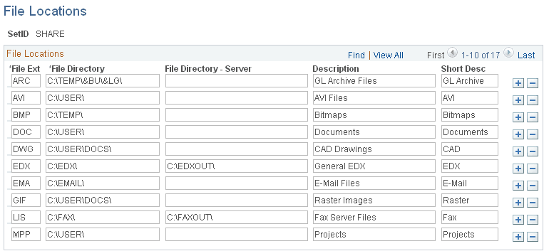

File Locations Page
Use the File Locations page (FILE_DIR_FS) to define file locations by specifying the file extensions that you want the system to recognize.
As part of defining file extensions, you can specify the file directory locations that the system searches to find attachments for the purchase orders, contracts, and so on. You can also specify file extensions that designate the email output, fax output, and fax control files. As part of defining these file extensions, you can define the file server directories where various dispatch processes create output files. Depending on the context of use, these file extensions are not necessarily conventional file extensions such as .DOC and .BMP, but can be any 3-character code that you use to recognize a file type.
Navigation:
Set Up Financials/Supply Chain, and then Common Definitions, and then File Locations and Images, and then File Locations, and then File Locations
This example illustrates the fields and controls on the File Locations page. You can find definitions for the fields and controls later on this page.
File Locations page
Throughout PeopleSoft applications, you can append various documents and other items–such as Microsoft Excel spreadsheets, ASCII files, or blueprints–as attachments. You can also route output from certain background processes, such as dispatching purchase orders, to a supplier using email, fax, or EDX. Please note that an external file–for example, a Microsoft Word document–that is attached to a purchase order is not included in the output file when that purchase order is dispatched or printed.
To use attachments, you must define the default locations, or file directories, for the documents that you use within the PeopleSoft system. You must also specify a server's location to route process output to the correct server.
You must set up a file location for each type of file that resides on a particular server. By categorizing file types and storing them in the same file directory, the system can easily locate the different types of files used as multimedia attachments or for server processing.
The file extensions that you define here are used for retrieving file directory information for the defined file types. This information is not used by PeopleSoft Purchasing dispatch processes to determine the file extensions of the output files that they create.
The actual extensions of the output files created by the dispatch processes are based on the output format that you specify for the dispatch on the Process Scheduler Request page. For example, if you select an output format of HP, LP, PS, or OTHER, the system creates the output file with a .LIS file extension.
Field or Control Description
File Ext (file extension)
Specify the file extension for each type of attachment. Depending on the context of use, these file extensions are not necessarily conventional file extensions such as .DOC and .BMP, but can be any 3-character code that you use to recognize a file type. For example, enter DOC for Microsoft Word document files and BMP to designate bitmap files. You can also enter FAX to designate fax output files or CTL to designate fax control files. This value serves as the primary key.
The actual file extensions for output files for faxes and emails are ultimately determined by the format that you select for the dispatch on the Process Scheduler Request page.
File Directory
Enter the location path to be used by PeopleSoft Purchasing online page PeopleCode to determine where to retrieve file attachments. This is the directory where the file attachments for purchase orders, contracts, and so on are stored.
Use this syntax to define the file directories: http://host_name/folder_name/. Be sure to include the last slash (/). The actual file directory that http://host_name is translated into is determined by the web server that you install along with its configuration.
For example, for a Microsoft IIS web server, http://host_name is translated into C:\Inetpub\wwwroot\ by default.
For an Apache web server, the translation of http://host_name is determined by the content of the httpd.conf file. If there is no Alias directive specified in this file, then the entry for DocumentRoot is used, which is normally C:\Program Files\Apache Group\Apache\htdocs\. If there is an Alias directive specified, then the translation is based on the entry for the corresponding Alias entry. For example, with Alias /image/ftp/pub/image, a request for http://host_name/image/pslogo.gif causes the server to return the file /ftp/pub/image/pslogo.gif.
The folders specified as file locations need to be designated as shared folders in order for them to be accessible to users over a browser.
For network (LAN) file directories, directory formats include:
  • file:\\psh-storwks-01\SRMsupport\customers\
  • file:\\\psh-storwks-01\SRMsupport\customers\
  • file://c:/user/attachments
  • file:///c:/user/attachments
File Directory - Server
Enter a location path to a file server directory where you want dispatch processes to save the output files that they create. This is the file server directory where the POPO005.SQR (PO Dispatch), POCNT100.SQR (Contract Dispatch), PORFQ01.SQR (RFQ Dispatch), and PORT001.SQR (RTV Dispatch) SQR dispatch programs create output files. The value in this field is used primarily by PeopleSoft Purchasing dispatch processes.
Use this syntax to define these file server directories for the Microsoft Windows environment: \\server_name\folder_name\. Be sure to include the last slash (\).
If the PeopleSoft Process Scheduler server and output directory are on the same computer, use this syntax to define the file server directories: c:\folder_name\. Be sure to include the last slash (\).
The folders specified as file locations need to be designated as shared folders in order for them to be accessible to users by browser.
The fax control file is always written to the same file location as the fax output file. Although you can specify a different file location for the fax control file, it will be ignored. You can specify the file extension for the fax control file on the Fax Location page.

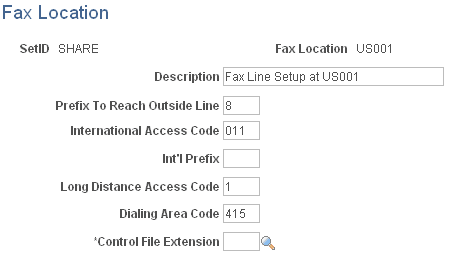

Fax Location Page
Use the Fax Location page (FAX_LOCATION) to set up fax locations by defining business-unit-level information that enables dispatch processes to construct appropriate dispatch fax numbers.
The information defined on this page also enables dispatch processes to assign proper extensions to the fax control files that they produce.
Navigation:
Set Up Financials/Supply Chain, and then Common Definitions, and then Location, and then Fax Location, and then Fax Location
This example illustrates the fields and controls on the Fax Location page. You can find definitions for the fields and controls later on this page.
Fax Location page
You can fax documents directly from within PeopleSoft applications. You can also route output from certain background processes, such as dispatching purchase orders, to a supplier by way of fax.
To fax documents, you must define the business-unit-level information that enables dispatch processes to construct appropriate dispatch fax numbers, and assign proper extensions to the fax control files that they produce.
When you send a fax to a supplier, the system compares the location information with the supplier's telephone information, to determine which parts of the fax number to ignore and which additional numbers to dial. You enter supplier fax information on the Phone Information page in the Supplier Information component.
Control File Extension
Designate the file extension to be used for the fax control files. The directory for the fax control file is based on the directory defined for the fax output file. The fax control file is always created in the same file directory in which the fax output file is created. The output directory for the fax file is defined on the Dispatch Configuration page.
A fax control file contains the information necessary to send a fax, such as which files to send, dialing instructions, and telephone numbers to dial. The file extension that you enter must have first been defined on the File Locations page.
