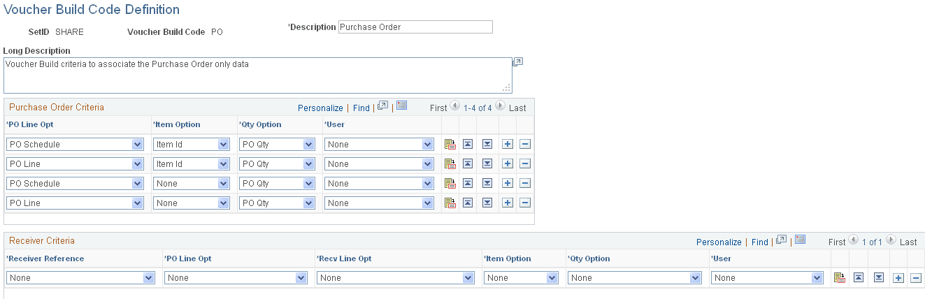

Voucher Build Code Definition Page
Use the Voucher Build Code Definition page (VCHR_BLD_DEFN) to define criteria that determine how the Voucher Build process creates voucher records from purchase orders and receivers.

This example illustrates the fields and controls on the Voucher Build Code Definition page. You can find definitions for the fields and controls later on this page.
To access the Voucher PO User Page, select the User or View Only option in the User field for a purchase order criteria row on the Voucher Build Code Definition page, and then click the User Criteria link in that row.
To access the Override Session Default (purchase order) Page click the Build Clause button in the purchase order criteria row on the Voucher Build Code Definition page.
To access the Voucher Receiver User Page, select the User or View Only option in the User field for a receiver criteria row on the Voucher Build Code Definition page, and then click the User Criteria link in that row.
To access the Override Session Default (receiver) Page, click the Build Clause button in the receiver criteria row on the Voucher Build Code Definition page.
The Voucher Build process first attempts to build the voucher using the receiver criteria you define. If the process does not find an association based upon the receiver information, then the logic proceeds to the purchase order criteria.
The more specific the criteria you define, the better the system performs. If the voucher build criteria return multiple matches per voucher line, then the Voucher Build process may select and build a voucher line record from an incorrect receiver or purchase order.
Purchase Order Criteria
The Voucher Build process uses the criteria that you define in this grid to find purchase orders for building voucher records. You can define multiple rows. The system looks for purchase orders using the criteria specified in the first line. If no purchase orders are found, the system uses the criteria defined on the second line, and so forth. You can use the up and down arrows in each row to change the line order.
A purchase order schedule can be associated with only one voucher line during a single Voucher Build process instance.

To define a SQL statement for finding purchase orders, select User or View Only. The User Criteria link appears. Click this link to access the Voucher PO User page, where you can enter the SQL clause for the condition you are adding.
Select None if you do not want to add a user-defined SQL clause.
Detail icon
Click this button for any row to access the Override Session Default page, where you can view the complete SQL statement for that row, including any that you added.

To define a SQL statement for finding receivers, select User or View Only. The User Criteria link appears. Click this link to access the Voucher Receiver User page, where you can enter the SQL clause for the condition you are adding.
Detail icon
Click the Build Criteria button for any row to access the Invoice Details page, where you can view the complete SQL statement for that row, including any that you added.
