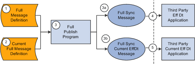

This diagram illustrates the Full Table Publish of Currently Effective Data process:
Process flow for full-data publish of currently effective data suppliers
