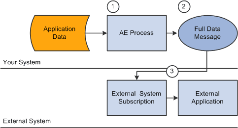

This diagram illustrates the Full Table Publish process:
Process flow for full-data publish suppliers

Once you have defined the rules for a full-data publish, you must use the Full Data Publish page to run a PeopleSoft Application Engine process to generate a full-data message that is published to the external systems.
