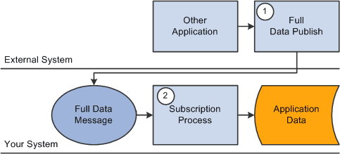

This diagram illustrates the Full Data Subscribe process:
Process flow for full-data subscription suppliers
