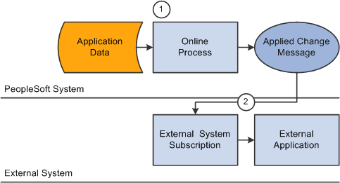

This diagram illustrates the Incremental Publish process:
Process flow for incremental publish suppliers
Incremental Publication Process for the VENDOR_SYNC Message
