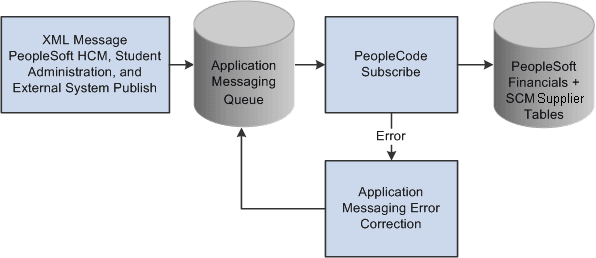

This example illustrates the Incremental Subscribe process:
PeopleSoft Supplier
Incremental Subscription Process for the VENDOR_SYNC Message
The supplier subscription code uses a component interface that encapsulates the supplier online component to handle default values and edits of the supplier data received in the subscribed message:
Declare Function supplier_intfc PeopleCode FUNCLIB_APEIP.VENDOR_ID FieldFormula;
Local Message _amp_ MSG;
_amp_ MSG = GetMessage();
supplier_intfc(_amp_ MSG);
The same default values and validation that occur online occur through the VNDR_ID component interface.
Not all the data elements in the supplier-related records are exposed in the message. The subscription process assigns the unexposed data elements a default value that is consistent with the PeopleSoft record definition.
