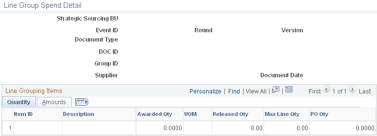

Line Group Spend Details Page
Use the Line Group Spend Details page (PO_LN_GRP_SPND_DTL) to view contract line group spend details.
Navigation:
Click the View Contract Line Spend link for the line group on the Line Group Spend Inquiry page.
This example illustrates the fields and controls on the Line Group Spending page. You can find definitions for the fields and controls later on this page.
Line Group Spend Detail page
This page displays quantities and amounts for items that belong to the line group defined in the Line Group ID field. The use of line groups is controlled through PeopleSoft Strategic Sourcing business unit setup.
Field or Control Description
Event Business Unit
Displays the business unit in which the event was created and awarded.
Event ID
Identifies a specific event that contains line groups.
Round
Displays the awarded event round. You can create multi-round events to negotiate with bidders when you need to make changes to a posted event.
Version
Displays the version of the awarded event. If a new round is created for the event, the system resets the version number to 1. After a new version is created, you cannot delete lines or bid factors because bids to the previous version would include those lines and bid factors.
Document Type
Displays the type of document. Values include Requisition, Purchase Order, RTV, RFQ, Receipt, Work Order, MSR, and Contract.
Document ID
Displays the system identifier and short description for the document.
Line Group ID
Displays the line group to which the line group items belong. A line group is a bundle of items that buyers use in PeopleSoft Sourcing to obtain better pricing for items. The relationship between the item and the contract is maintained through auction award records. Items that belong to this group are listed in the Line Group Items section.
Supplier ID
Displays the supplier who has responded with an offer for items contained in the line group. The system applies the line group price to the requisition or purchase order.
Contract Expire Date
Displays the date on which the contract expires for this line group.
Item ID
Displays the item that is a part of the line group.
Quantity Awarded
Displays the quantity of the item that has been awarded to a supplier.
UOM (unit of measure)
Displays the item's unit of measure.
Quantity Released
Displays the quantity of the item that has been released to the supplier.
Quantity Remaining
Displays the quantity of the item that is remaining for release.
Amounts Tab
Select the Amounts tab.
You use this page to view amounts for line group items. Amount values include the amount, amount released, and maximum line amount.
