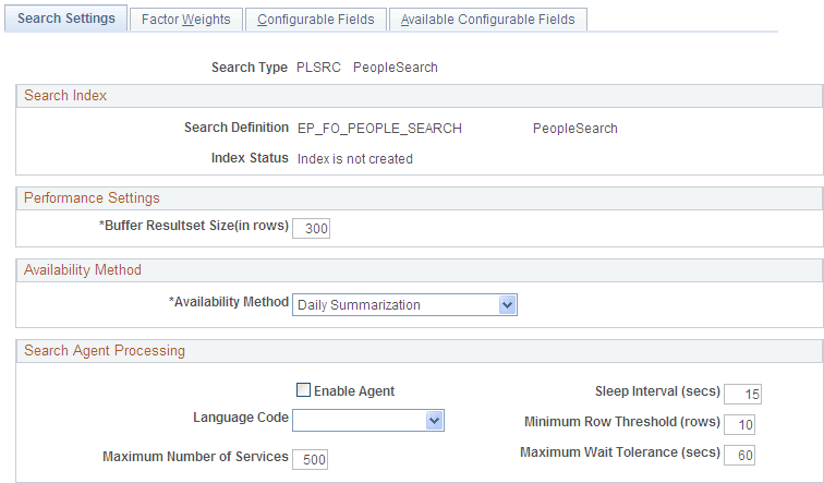

Search Settings Page
Use the Search Settings page (RS_SEARCH_CONFIG) to configure parameters for the Search Framework.
Navigation:
Set Up Financials/Supply Chain, and then Common Definitions, and then Resource Search, and then Setup Resource Search Config
This example illustrates the fields and controls on the Search Settings page. You can find definitions for the fields and controls later on this page.
Field or Control Description
Search Type
Displays the type of search:
  • CNTSR: Contact Search
  • CSTSR: Customer Search
  • ORDSR: Order Search
  • PLSRC: PeopleSearch
  • PMSRC: PeopleMatch
The resume attachment feature for applicants and employees allows applicants to attach their own resumes to PeopleSoft Staffing Front Office. Depending on the setup in the Administer File Attachments page, the attachment process can use FTP, SFTP, or the database (DB) to move the resumes from the users' own workstations into a centralized storage location.
The applicant and employee components capture resumes both in the form of electronic document attachments and in an ACSII text field. Entering resumes in the ASCII text field provides faster indexing performance while adding resume attachments provides them to customers in their original form. You can even do both and the system will index the text version.
Search Index
Search Definition
Displays the PeopleTools search definition.
Index Status
Displays the status of the index, which determines if the indexes have been built for the search definition.
Performance Settings
Define the size of your result set by entering a value in the Buffer Resultset Size (in rows) field. You must also set the Maximum Number of Results in the Oracle Search Framework Administration Console. It should be larger than the maximum search result set desired on the search pages and greater than the largest Buffer Resultset Size in the Search Configuration component. See PeopleSoft PeopleTools, Search Technology, "Working with PeopleSoft Search" documentation.
Availability Method
Enter the method that the system will use to calculate availability scores in the search results: Daily Summarization or No Availability Calculation.
This group box appears only if you select the PeopleSearch (PLSRC) or PeopleMatch (PMSRC) search type. When Daily Summarization is selected, the system calculates the percentage of time that a resource will be available between the start and end dates specified in the Order or in the PeopleSearch component. When No Availability Calculation is selected, the system does not calculate availability scores, and users may have to rely on other information, such as the count of active assignments, to infer whether a resource is available.
Search Agent Processing
The search agent:
  • Minimizes the number of times the program runs (to reduce overhead and, more importantly, fragmentation).
  • Minimizes the time required for a change to be reflected in the collection.
Enable Agent
Select this check box to enable search agent processing.
Language Code
Select the language to run the agent against.
Note: If a specific language is chosen, all other languages will remain outdated until the next time those languages are selected for updating.
Maximum Number of Services
Specify how many times the application engine will go through the sleep time before rescheduling itself and ending.
Sleep Interval (secs)(sleep interval [seconds])
Specify how often the agent will check the log for updates.
Minimum Row Threshold (rows)
Specify how many rows are needed for the application to start.
Maximum Wait Tolerance (secs)(maximum wait tolerance [seconds])
Specify the maximum times a row of data can wait before it is updated in the search collection.

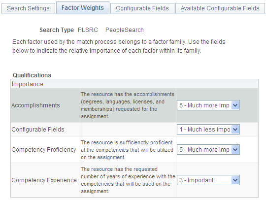

Factor Weights Page
Use the Factor Weights page (RS_SRCH_FACT_WGHT) to define the relative importance of each factor within its family.
Navigation:
Set Up Financials/Supply Chain, and then Common Definitions, and then Resource Search, and then Search Configuration, and then Factor Weights
This example illustrates the fields and controls on the Factor Weights Page. You can find definitions for the fields and controls later on this page.
Factor Weights page
Qualifications
The Staffing Front Office search components present the results with their associated search score. The score is a weighted average of several factors. For each factor family grouping, enter the relative importance of each factor, such as Accomplishments, Competency Proficiency, or Resume. Values are 0 - Not at all important, 1 - Much less important, 2 - Less important, 3 - Important, 4 - More important, or 5 - Much more important.

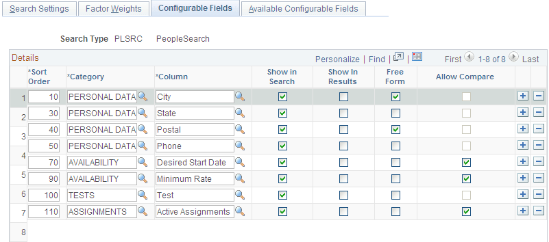

Configurable Fields Page
Use the Configurable Fields page (RS_SRCH_CONFIG_FLD) to define fields to be used in searches.
Navigation:
Set Up Financials/Supply Chain, and then Common Definitions, and then Resource Search, and then Search Configuration, and then Configurable Fields
This example illustrates the fields and controls on the Configurable Fields page. You can find definitions for the fields and controls later on this page.
Sort Order
Enter a number to change the order of the fields on the page. This field controls in which order the fields are listed on the actual search page.
Category
Enter the category to which you want to group fields.
Note: You can define views to join multiple records and use that view for the Search Framework index creation. You can also create views with complex joins or outer joins, but this is considered a specific customer customization. Note that complex joins, outer joins and joins with multiple tables and views may significantly decrease the performance of the Search Framework index creation process. If you are adding new tables, views, or fields not delivered on the Available Configurable Fields page, you must also create the queries to extract the new data, assign the queries to its parent connected query, and update the search definition. For additional information, see PeopleTools: Search Technology.
Column
Enter the name of the field as you want it to appear in searches.
Show in Search
Select to indicate which fields appear on the search page. Selecting a check box causes the system to include that field as a search field. If an existing row is not selected, the system includes the field when creating indexes. However, the field is not displayed on the search page.
Show in Results
Select to indicate that the system should display this field in the search result set.
Free Form
Select to make the system treat the field as a free-form search—that is, a search with no field edits. Generally, a free-form search is used for text searching (for example, searching for a description).
Allow Compare
Select to enable the use of comparison operators (such as <, <=, >, >=, and =) when searching. This field is disabled for text fields because Search Framework supports comparison only on numeric and date fields. For text fields, wildcard searches can be used instead.
Note: Searching on a field using comparative search results may lower system performance.

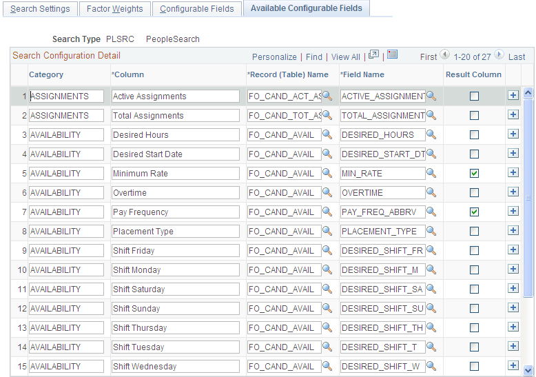

Available Configurable Fields Page
Use the Available Configurable Fields page (RS_SRCH_REC_FLD) to define search fields to create search index files.
Navigation:
Set Up Financials/Supply Chain, and then Common Definitions, and then Resource Search, and then Search Configuration, and then Available Configurable Fields.
This example illustrates the fields and controls on the Available Configurable Fields page. You can find definitions for the fields and controls later on this page.
Category
Enter the name of the category into which you want to group fields.
Column
Record (Table) Name
Enter the actual record name.
Field Name
Enter the actual field name.
Result Column
Select the check box to indicate that the system should use the field to display results.

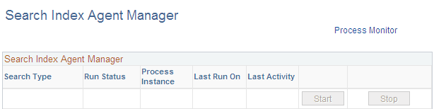

Search Index Agent Manager Page
Use the Search Index Agent Manager page (FO_AGENT_MGR) to view the searches where the search agent is enabled.
Navigation:
Set Up Financials/Supply Chain, and then Common Definitions, and then Resource Search, and then Search Index Agent Manager
This example illustrates the fields and controls on the Search Index Agent Manager Page. You can find definitions for the fields and controls later on this page.
This page lists the searches that have the agent enabled.
Search Type
Displays the search type.
Run Status
Displays the status of the agent for each search type.
Process Instance
Displays the process of instance of the agent.
Last Run On
Displays the date and time the agent was last run.
Last Activity
Displays the date and time of the last activity. This field is used in conjunction with the Run Status field.
Start
Click this button to manually start the search agent.
Stop
Click this button to manually stop the search agent.
Refresh
Click this button to refresh the information in the grid.

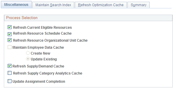

Cache Administration – Miscellaneous Page
Use the Cache Administration – Miscellaneous page (RS_CACHE_MISC) to specify processes to refresh cache tables and create search collections.
Navigation:
Set Up Financials/Supply Chain, and then Common Definitions, and then Resource Search, and then Setup RM Cache Administration
This example illustrates the fields and controls on the Miscellaneous page. You can find definitions for the fields and controls later on this page.
Miscellaneous page
Refresh Current Eligible Resources
Select this check box to update the Eligible Resource Cache table (RS_ELGBL_WRKR) with current eligible resource information. In addition to tracking the current, eligible resources, the table stores the resource's job-related information, such as job code and location. The program is required when routine changes are made to a resource's job-related information.
Run this program nightly and as required.
Refresh Resource Schedule Cache
Select to update the Resource Schedule Cache table (RS_DF_WRKR_DATE) that is used to track a resource's schedule. The program purges old availability data and ineligible resource data. It is required when:
  • Implementation takes place.
  • Standard hours or default days change in the Scheduling Options group box on the Common Installation Options page.
  • New holidays are added to the holiday schedule and loaded using the Holiday Load Application Engine process (RS_HOLIDAY).
This program runs automatically for a resource when the resource's schedule changes. Run the program manually for all resources as required.
SelectCreate New orUpdate Existing.
Refresh Resource Organizational Unit Cache
Select to update the Resource Organizational Unit Cache table (RS_WORKER_ORG) that stores organization information from the specified organization tree. The program is required when:
  • Implementation occurs.
  • Resources are created individually using the Establish Employee As Resource component (RS_WRKR_CREATE).
  • A node or detail value changes on the organization tree.
  • A new organization tree is implemented.
  • A resource's organization unit value changes, such as the resource's department.
Run this program nightly.
Maintain Employee Data Cache
Select this check box to update the FO_CANDIDATE_W table.
Refresh Supply/Demand Cache
Select this check box to update the cache tables for both supply and demand.
Note: This field is used by PeopleSoft Resource Management.
Refresh Supply Category Analytics Cache
Select this check box to update the cache tables for supply category analytics.

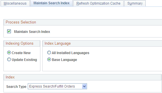

Maintain Search Index Page
Use the Maintain Search Index page (RS_SRCH_INDEX) to capture the parameters needed to create the search index files.
Navigation:
Set Up Financials/Supply Chain, and then Common Definitions, and then Resource Search, and then Cache Administration, and then Maintain Search Index
This example illustrates the fields and controls on the Maintain Search Index page. You can find definitions for the fields and controls later on this page.
Process Selection
Select the Maintain Search Index check box to create the search index as part of this Cache Administration run control.
Indexing Options
Select Create New to delete the existing index and create a new one. Use this option to replace the search index.
Select Update Existing to update the existing index without deleting it by inserting new documents and updating those that have changed since the last time the update process ran.
Index Language
Specify whether the index should be created for all installed languages or a single language.
  • Select All Installed Languages to create a collection for each installed language.
  • Select Base Language to specify the installed base language.
Index
Specify a Search Type for the index creation.
When you update this page and submit the process, Cache Administration runs the Build Search Index process provided in the Search Framework. You may also run this process directly from the Schedule Search Index page (PeopleTools, and then Search Framework, and then Administration, and then Schedule Search Index). However, PeopleSoft recommends that you use the Cache Administration process so that the cache tables and search indexes are synchronized at all times.
The Optimize Indexes feature has been removed from the Maintain Search Index page. It is now maintained centrally within the Search Framework. See the Oracle Secure Enterprise Search Administrator’s Guide.

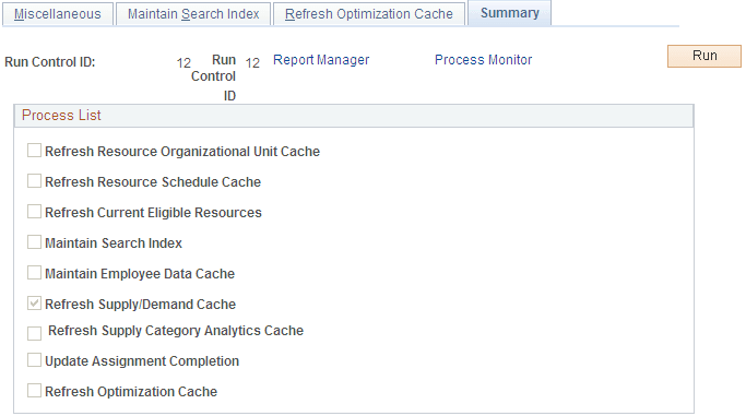

Cache Administration - Summary Page
Use the Cache Administration - Summary page (RS_CACHE_SUMMARY) to confirm the list of processes that you want to run or schedule for the future.
Navigation:
Set Up Financials/Supply Chain, and then Common Definitions, and then Resource Search, and then Cache Administration, and then Summary
This example illustrates the fields and controls on the Cache Administration - Summary Page. You can find definitions for the fields and controls later on this page.
These check boxes will be selected or deselected according to the options selected on the previous pages:
  • Refresh Resource Organizational Unit Cache
  • Refresh Resource Schedule Cache
  • Refresh Current Eligible Resources
  • Maintain Search Index
  • Maintain Employee Data Cache
  • Refresh Supply/Demand Cache
  • Refresh Supply Category Cache
Run
Click this button to run the cache administration program.
Process Monitor
Click this link to review the status of the process scheduler job you initiated when you clicked the Run button.
