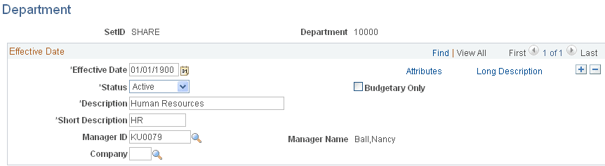

Department Page
Use the Department page (DEPARTMENT) to create a departmental reporting structure.
Navigation:
Set Up Financials/Supply Chain, and then Common Definitions, and then Design ChartFields, and then Define Values, and then ChartField Values, and then Department
This example illustrates the fields and controls on the Department page. You can find definitions for the fields and controls later on this page.
Department page
Field or Control Description
Status
Select the current status of the department. Values are Active or Inactive.
Description and Short Description
Enter a description and short description. These fields appear on pages and in reports.
Manager ID and Manager Name
Enter the manager ID and name for this department.
Company
Select the payroll company into which the department reports. The system uses the payroll company to calculate workers' compensation. The system also uses the department on the order in conjunction with the state to look up the appropriate workers' compensation rate.
Note: If PeopleSoft Staffing Front Office is installed with PeopleSoft Pay/Bill Management, this table will be populated by either the HCM or core Financials users (thus PeopleSoft Staffing Front Office users do not need to configure it).
