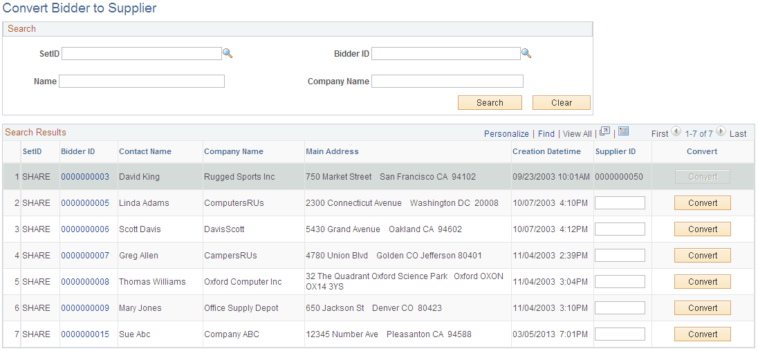

This example illustrates the fields and controls on the Convert Bidder to Supplier page.
Enter search criteria in the Search fields and click the Search button to populate the results grid.

Bidder ID
Click the link for each bidder to view bidder details in the Maintain Bidder component (AUC_BIDDER).
Supplier ID
Enter a value in the Supplier ID field or convert first to automatically create an ID.
Convert
Click this button to create a supplier record for this bidder. This process creates a Supplier ID if one has not been specified. A confirmation message indicates the supplier has been created successfully.
