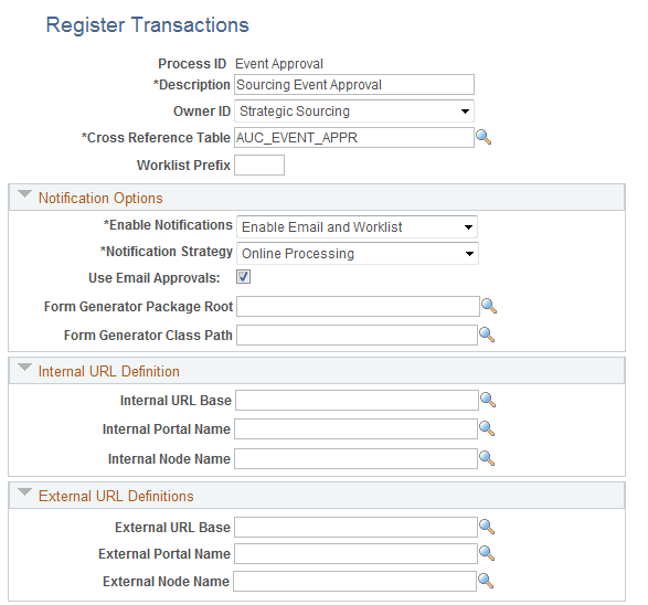

Register Transactions Page
Use the Register Transactions page (EOAW_TXN) to define a workflow approval process.
Navigation:
Enterprise Components, and then Approvals, and then Approvals, and then Approval Registry
This example illustrates the fields and controls on the Register Transactions page (1 of 2). You can find definitions for the fields and controls later on this page.
This example illustrates the fields and controls on the Register Transactions page (2 of 2). You can find definitions for the fields and controls later on this page.
This page is the central record for all approvals for a specific workflow process.
Important:
Only the Enable Notifications and Notification Strategy options should be changed on this page. Other changes will require significant technical modifications to the application code.
Field or Control Description
Approval Process ID and Description
Enter the name and description for the workflow approval process. The description is a required field.
Object Owner ID
Select Strategic Sourcing.

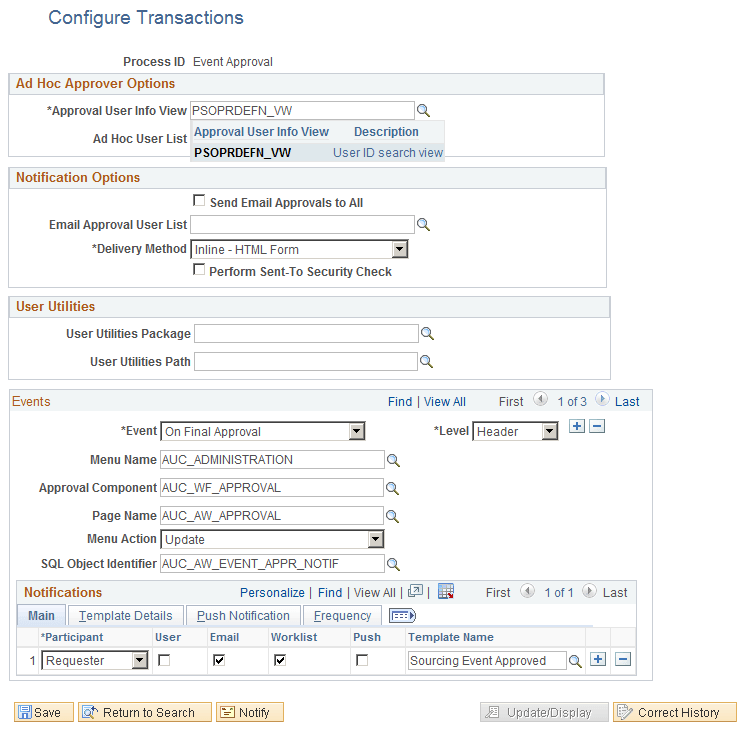

Configure Transactions Page
Use the Configure Transactions page (EOAW_TXN_NOTIFY) to add configuration options to the workflow process.
Navigation:
Enterprise Components, and then Approvals, and then Approvals, and then Approval Setup
This example illustrates the fields and controls on the Configuration Transactions page. You can find definitions for the fields and controls later on this page.
Important:
The only options that should be changed on this page are the Ad Hoc Approver Options. If necessary, you can change the (email template) template name directly in the system on the Generic Template Definition page (PeopleTools, and then Workflow, and then Notifications, and then Generic Templates). Bind variables for this template can be controlled by defining a SQL object for the SQL Object Identifier setting.
Supply Chain Management Approval Workflow documentation should be reviewed before changing any of these settings.
See PeopleSoft 9.1 PeopleBook: Approval Framework.
Template Name
(Optional) Select a specific email template to use with this workflow.
