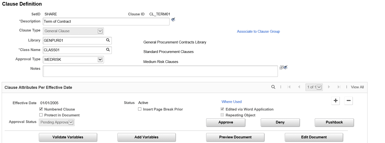

Accessing Clauses for Approval Using the Clause Definition Page
Use the Clause Definition page (CS_CLAUSE_DEFN) to access clauses for approval.
Navigation:
Click the Worklist link on the Home page and select Approval Routing in the Work List Filters field.
Use this page to perform approval tasks for clauses. The Approval Status field displays the approval status and is disabled if a clause is required to go through approval framework for approval processing. The system automatically updates the field, depending on the approval progress. If installation options have been set to require clause approval, the Preview Approvals and Submit for Approval buttons also appear on this page. For more information about approving clauses using approval workflow: See Approving Clauses Using the Clause Definition Page.
If the Approval Status field is available, then you have permission to update the approval status using this page. You can manually set the status to reflect the current state for the approval. Statuses are:
Approved: Select to indicate that the clause has been approved for use. You can still modify any effective-dated row that has been approved. If you make changes, the system sets the approval status from Approved back to Initial. Then, you must select Approved to update the status.
Also, if you do not set clauses for approval using installation options, you can set up automatic approvals for clause librarians. You use user preferences to define the librarians who have automatic approval authority. When automatic approval is set to Approved in user preferences, and the librarian creates a clause, the approval default value for the clause is Approved. If the librarian checks out an approved clause and makes changes, the system does not set the status back to Initial. Rather it leaves the clause at the Approved status.
See Understanding User Preferences.
Although a clause may not be in an Approved status, you can still use it as part of a section or configurator. Its availability for use in an actual document depends on the clause's status.
Initial: Select to indicate the status of the clause is in the initial state of creation. This is the default value when you access the Clause Definition page after you create the clause. When a clause is in this status, you can maintain elements of the clause. You can use the clause in other content structures, such as sections and configurators. Functions, such as previewing documents, display the clause with a "***Pending Approval***" statement at the beginning of the clause. Document generation does not include clauses that are in the Initial status.
Pending: Select if the clause is in the process of being approved, but has passed the initial creation stage. The system processes clauses that are in this status similar to clauses that are in the Initial status. Document generation does not include clauses that are in the Pending status.
If the clause is set up for approval framework processing and the clause is pending the approval of an approver, the Clause Definition page displays the Approve, Deny, or Pushback buttons for the approver to select from.

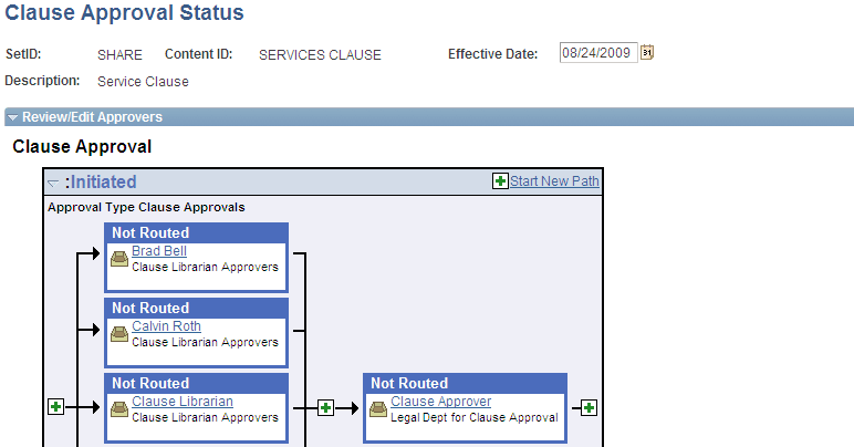

Previewing and Submitting Clauses for Approval Using the Clause Approval Status Page
Use the Clause Approval Status page (CS_CLS_APPROVAL) to preview and submit clauses for approval. This feature is only available when installation options require that clauses must be approved.
Navigation:
Click the Preview Approval button on the Clause Definition page.
Click the Submit for Approval button on the Clause Definition page.
This example illustrates the fields and controls on the Clause Approval Status page (1 of 2).
This example illustrates the fields and controls on the Clause Approval Status page (2 of 2).
Use the Preview Approval button on the Clause Definition page to review the approvers in the process. The system displays a message if clause approvals are not required. After reviewing the approval stages and paths, you can submit the clause for approval. The Clause Approval Status page is similar to the page used to view and edit the document approval status.
Click the Return to Clause Definition link to return to the Clause Definition page.

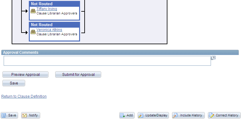

Updating and Submitting Clauses for Approval Using the Clause Approval Status Page
Navigation:
When you click the Submit for Approval button on the Clause Definition page, you can submit a clause for approval and, if needed, update the approvers and reviewers in the clause approval process. This feature is different than previewing and submitting a clause for approval in that you can add reviewers and approvers using this page.
When you submit a clause for approval and approvals are required, the system routes the approval notifications and sets the contract approval status to Pending.
If you submit a clause that does not require approvals, the system displays this page which indicates that approvals are not needed and that approval criteria was not met. It also displays a message indicating that the clause has been approved. Then, the system sets the clause approval status to Approved and the clause status to Active.
If approvals are needed and the approval criteria has been met, the system sets the clause approval status to Pending, and can send email, worklist routings, or both to approvers in the first relevant steps based on approval configuration. The Clause Approval Status page displays again showing the updated approval status. If the status is not Initial, the Preview Approval and Submit for Approval buttons are not available.
Navigation:
This example illustrates the fields and controls on the Clause Definition page (1 of 2).
This example illustrates the fields and controls on the Clause Definition page (2 of 2).
Approvers receive notifications through their email or worklist systems. The system provides a link that enables approvers to go directly to the Clause Definition page. If you are an approver of a clause and the clause is pending your approval, the Clause Definition page displays the Approve, Deny, Pushback buttons.
To approve a clause:
Click the Approve button.
The Clause Approval Status page displays the clause approval path and approvers. You can also click the Deny button to reject the clause. If you deny a clause, the entire workflow process is stopped and the clause status is set to Initial. If you click the Pushback button, the clause is pushed back to the previous approver. The previous approver can review the clause and resubmit it for approval.
Enter any comments you have concerning the clause.
The system returns to the Clause Definition page.
Click the Approval Details link.
You can use this link anytime to review your comments and check the progress of the clause as it goes through approvers.
