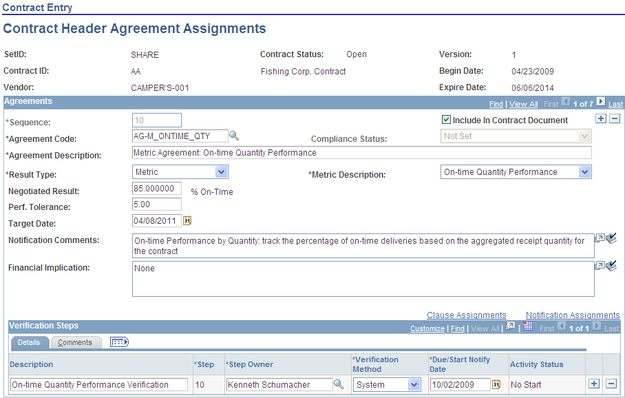

Contract Header Agreement Assignments Page
Use the Contract Header Agreement Assignments page (CS_AGREE_CNT) to assign contract header agreements.
Navigation:
Supplier Contracts, and then Create Contracts and Documents, and then Contract Entry. Click the Contract Agreement link on the Contract Entry page.
This example illustrates the fields and controls on the Contract Header Agreement Assignments page.
Contract Header Agreement Assignments page: Details tab
Use this page to assign agreements to a contract. You can select from an existing list of agreements, manually add agreement information, or modify information that was converted from a Strategic Sourcing event. The page initially displays with the basic information about the contract, including the contract ID, status, supplier, and version number.
If you use a predefined agreement code, the information from the agreement appears as default information on this page. You can change the information, but changes to predefined information affect only the specific contract. The changes are not made to the original agreement. The information that you define for the agreement exists only for the life of the contract.
Only active agreements that are effective as of the begin date of the contract can be selected.
If agreement terms and verification steps are unique to a particular contract, you can define those terms and steps for the contract without first defining them as an agreement code. In this case, the information is available only for the life of the contract. While agreement information is also copied to another contract, when you use the copy function to create a new contract, the agreement information will not be a part of the agreement library. As with predefined agreement codes, you can add clauses and notifications.
You can also predefine agreement information on a contract if the contract was generated from a PeopleSoft Strategic Sourcing event. You can associate agreement codes with Strategic Sourcing bid factors that are subsequently used with Strategic Sourcing events. When you award a buy auction to a bidder and create a contract, the system converts the bidder's responses from bid factor questions to the agreement information on the contract.
The page contains agreement details and comments as well as the verifications steps and owners who are required to determine if the agreement is compliant. A contract can have multiple agreements with each one having a different set of verification steps. You can also assign clauses and notification information to each individual agreement.
When you complete this page, you can create the document for the agreement and its clauses. If a document already exists for the agreement, you need to refresh or re-create the document to incorporate any changes you make to the agreement information.

Agreements
Refer to Common Elements Used When Managing Contract Agreements for common field definitions. Those that are not common are defined below.
Field or Control Description
Sequence
Displays the agreement sequence code. If you are initially adding agreements to a contract, the default sequence number is 10, but you can change it. When adding additional agreements, you should leave a gap between sequence numbers in case you want to insert an additional agreement between two existing ones. To insert an additional agreement, click the + button and assign the sequence number based on where the agreement should appear.
The sequence number controls the order in which associated clauses are added to the document. Clauses for the first agreement are added first, clauses for the next agreement are added second, and so on.
If the system automatically adds agreements when it converts the PeopleSoft Strategic Sourcing event to a contract, the agreements are added with sequence numbers in increments of 10.
Agreement Code
Select a predefined code or enter an ad hoc code. If you select a predefined code, the system populates the agreement with the information defined for that code. If you are entering an ad hoc agreement, you must complete all required fields. If the contract was created from a PeopleSoft Strategic Sourcing event, the system converts bid factor responses to the agreement information.

Verification Steps - Details
Use this section to define the steps required to validate the agreement. If you selected a predefined agreement code, the system automatically populates the steps that can be changed, added to, or deleted. If you are adding an ad hoc agreement, or if the agreement information originated from a PeopleSoft Strategic Sourcing event, you can add steps. You can also establish verification methods and verification step owners. To update header agreement statuses, use the Monitor and Update Agreements component to access the Update Agreement Statuses page where you can view and manage verification processes.
Description
Enter a description for the verification step. An example would be, what document or inspections are required to complete the step. If a verification step is added to the agreement, this field is required.
Due/Start Notify Date
For nonmetric agreements steps, this value indicates the date that this verification step must be completed. The due date defaults to the target date of the agreement, or is a calculated date based on the contract start or end date.
For metric-related steps, this date indicates when you want to start evaluating metric-agreement performance. See Understanding Agreement Metrics
For system verification methods, the value in the Due/Start Notify Date field represents the date to start notification to users for any error or warning conditions related to the metric. The system uses this value in conjunction with the value that you enter in the As of Date field on the Process Notification run control page. If the Due/Start Notify Date field value is less than or equal to the As of Date field value on the run control, the system checks this metric to determine if notifications need to be sent.
