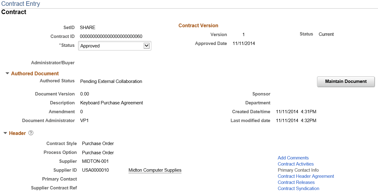

Contract Entry - Contract Page (Syndicated)
Use the Contract Entry - Contract page (CNTRCT_HDR) to enter syndication details.
Navigation:
Supplier Contracts, and then Create Contracts and Documents, and then Contract Entry. Click the Add button on the search page.
This example illustrates the fields and controls on the Contract Entry - Contract page showing the Contract Syndication link in the Header section.
Contract Entry - Contract page for a Syndicated Contract
Use this page to enter contract data and review syndication details for contracts that have been syndicated. This topic discusses the fields used in the syndication. A message appears next to the Status field that indicates if the contract has been syndicated.
The Contract Releases link only appears when the Process Option is not Purchase Order and the contract is syndicated. The system prevents releases from the parent system against contracts that use the other contract process options.
The parent system controls the syndication process. Changes to the content of the contract must be made in the parent system, and syndicated to the remote system. You can make limited changes to the syndicated contract in the remote system, but the system warns you when the changes might be overwritten by the parent system. You cannot insert new line items, but you can modify existing line items such as line comments, distributions, and agreements.
Because a contract can have releases in syndication, but not in the parent, you cannot delete the line in the parent after the contract is syndicated.

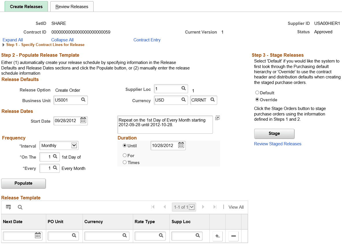

Create Releases Page
Use the Create Releases page (CNTRCT_SCHEDULE) to create releases against syndicated contracts.
Navigation:
Supplier Contracts, and then Create Contracts and Documents, and then Contract Entry. Click the Contract Releases link on the Contract Entry - Contract page.
This example illustrates the fields and controls on the Create Releases page.
Create Releases Page for a Syndicated Contract
Use this page to create releases against syndicated purchase orders and nonsyndicated contracts. This page provides a means to specify the interval between purchase orders, generate a schedule for the series of purchase orders, and create the releases of the orders. The releases and available options are based on the specified business unit.
Since you can only create releases in the remote system for syndicated contracts that are not Purchase Order process option contracts, the Contract Releases link is not available for other contract process options.
To further prevent the release of contract quantities, the system prevents you from selecting or copying a general contract ID that has been syndicated. You can copy a syndicated general contract to a new syndicated general contract, but this does not create a release.
Field or Control Description
Stage
Click to stage qualifying purchase orders. You can stage a release for approved contracts only. When you click the button, the system populates the release tables from which the contract Purchase Order process option retrieves data.

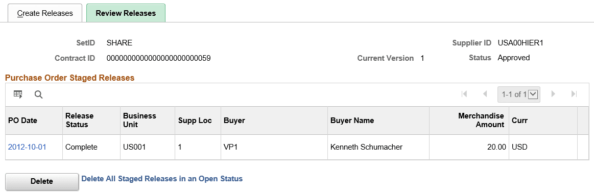

Review Releases Page
Use the Review Releases page (CNTRCT_RLS_HIST) to view staged releases for syndicated contracts.
Navigation:
Select the Review Releases tab on the Create Releases page.
This example illustrates the fields and controls on the Review Releases page.
Review Releases page for a Syndicated Contract
Use this page to view staged releases against a syndicated purchase order and a nonsyndicated contract.
Use the PO Date (purchase order date) link to access item descriptions and add comments about the staged releases.

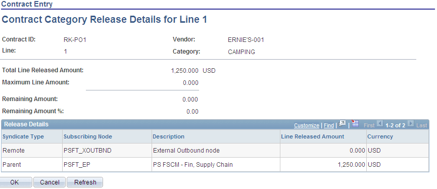

Contract Category Release Details for Line Page
Use the Contract Category Release Details for Line page (CS_CAT_RLSD_SEC) to view syndicated category line released details.
Navigation:
Supplier Contracts, and then Create Contracts and Documents, and then Contract Entry. Select the Release Amounts tab in the Contract Categories Lines grid on the Contract page. Click the Release Details link.
This example illustrates the fields and controls on the Contract Category Release Details for Line page.
If the contract process option type is Purchase Order and the contract has been syndicated, use this page to view details about the released amount and quantities, and view the category description. The system displays amount values in the currency unit of measure quantities in the inventory unit of measure.
Values on the page represent a single category line item on the contract that has been processed through syndication.
See Contract Item Release Details for Line Page.
