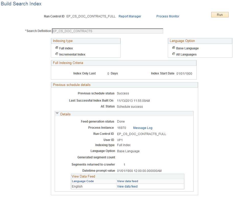

This example illustrates the fields and controls on the Build Search Index page.
Use this page to create and update the PeopleSoft Search Framework search indexes and collections to enable supplier contract content searches. The system initializes the page with values based on the index name that you select. You must create run control IDs for each search definition to build a full index and another run control ID for each search definition to build incremental indexes. It is suggested that you use the search definition name followed by _FULL or _INCR for each search definition. After you initially build your search indexes using the _FULL run controls, you should keep them updated to reflect changes that are being made in the contract library using the _INCR run controls. You should set up the _INCR processes to run as frequently as needed depending on how often changes are made to the library elements and authored documents.
If you use the AMC search configuration template, the run controls described above are created automatically by the system.
The system uses values defined on the configuration file, located on the application server, as the index file path default value.
Field or Control Description
Run Control ID
Displays the run control ID for either building or updating search indexes. You initially define the value for this field.
Search Definition
Select a search definition to build search indices.
For a list of Supplier Contract Management search definitions, see the Search Definition Page.
Indexing Type
Select one of these options:
  • Full Index indicates that all indexes are rebuilt.
  • Incremental Index indicates that only changed indexes are rebuilt.
Language Options
  • Base Language indicates that the base language specified on the International Preferences page is used when you create or build the index.
  • All Languages indicates that all activated languages on the Manage Installed Languages page are included when you create or build the index.
Full Indexing Criteria
Displays the information entered on the Search Definition - Advanced page if you entered a start date. For more information, see the PeopleTools: PeopleSoft Search Technology.
