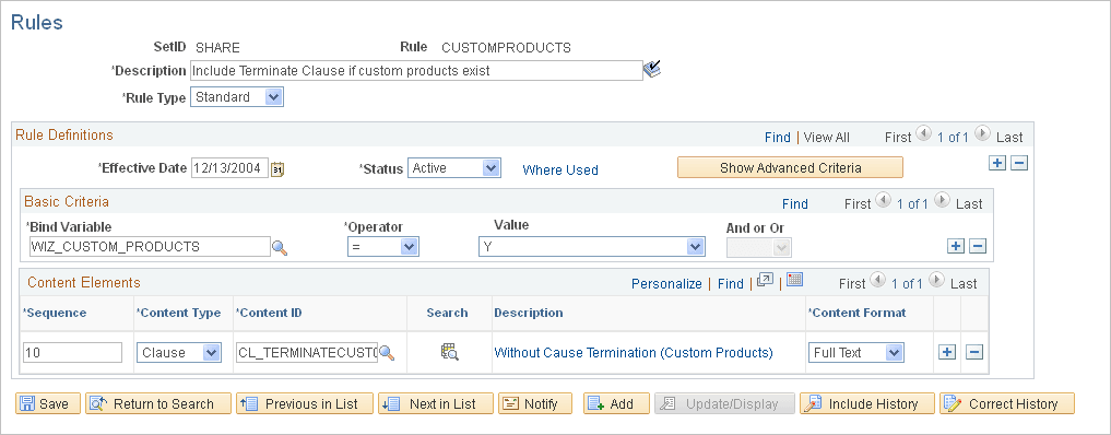

Rules Page
Use the Rules page (CS_RULES) to set up authored document rules.
Navigation:
Supplier Contracts, and then Manage Contract Library, and then Contract Library Rules
This example illustrates the fields and controls on the Rules page.
Rules page
Use this page to define rule definitions, criteria, and the content to include when the rule is true. A rule can be associated directly with a document configurator or associated with a section. Rules are a set of conditions that, when evaluated, render a true or false result. When a standard rule type is true, the system includes additional clauses or sections in the document configurator or within a section in the configurator. The system adds these to the Content Elements grid on the Document Configurator Definition Page and into the document when you use the configurator to generate an authored document.
When an alternate rule type is true, the system substitutes the alternate clause that is defined for the primary clause for which the alternate is a member. Use the Clause Definition Page to define the alternate clause. The system bases rules on the transactional-based or wizard-based bind variables that it resolves when a document is generated and refreshed.
You can define basic or advanced criteria for rules. The difference between basic and advanced criteria is that advanced rules enable you to place parentheses markers around statements and create combinations of query-type, statement, or both in the rule criteria.

Copy From
Click to access the Copy Information From page (CS_RULE_COPY_SP). The button is available when you are adding a new rule and enables you to copy an existing rule to create the new rule. When you click the button, the system provides a list of existing rules. After you make the copy, you can incorporate new values into the rule.
Rule Type
Select a value that determines how the system uses the rule. Values include:
Standard: Select to use this rule with any section or configurator. This is the default value for new rules.
Alternate: Select to use this rule with alternate clauses. The system links the rule to the alternate clause on the parent clause and not within the rule itself.
Show Advance Criteria and Show Basic Criteria
Click this toggle button to determine advanced criteria or define basic criteria.
Basic Criteria
Use this section to define basic selection criteria for a rule. This feature enables you to define basic queries to evaluate one or more transactional or wizard bind variables. When a document is generated or refreshed, the system renders a true or false result and takes the appropriate content action, such as including an additional clause or substituting an alternate clause.
Field or Control Description
And or Or
When more than one row of criteria exists within basic criteria, the system can evaluate all rows using and or or statements:
  • When using and, all rows of the criteria must evaluate as true for the rule to be true.
  • When using or, if any row of the evaluated criteria is true, then the rule is true.
Advanced Criteria
Use this section to define advanced criteria for a rule. Advanced criteria enable you to define more complex sets of criteria. You can use advanced criteria when the basic criteria for a rule is not sufficient. Advanced criteria enables you to place open and close parentheses around one or more criteria, and enables you to use the AND and OR constructions when needed.
Open
Select the open parenthesis character to signify the start of a group of criteria to enclose. For example, if you have three criteria, you can create a selection criteria of (A or B) and C by placing an open parenthesis on the line for A.
Bind Variable
Select a bind variable for retrieving field values from a record. The variable that you select determines the field type that you must use in the Value field.
Operator
Select a value that determines the action that the system applies to the criteria that you define from the bind variable record and the value in the Value field. For example, to place amounts that are equal to or greater than 100,000 from the transaction bind variable into the document, use the => operator and enter 100000 in the Value field. You should enter the correct form of the criteria to match the operation that you want the system to perform.
Values are:
<: Include values that are less than the value that you enter in the Criteria field.
<=: Include only values that are less than or equal to the Criteria field.
<>: Include values that are not equal to the value that you enter in the Criteria field.
=: Include only values that are equal to the Criteria field.
>=: Include values that are equal to or greater than the Criteria field.
>: Include values that are greater than the Criteria field.
Value
Enter the value to use when applying the operators. For example, if you select >= in the Operator field for an item description bind variable, you could enter 100000 as the value. The system will include only values that are equal to or above 100000.
Close
Select the close parenthesis character to signify the end of a group of criteria to enclose. For example, if you have three criteria, you can create a selection criteria of (A or B) and C by placing a close parenthesis on the line for B.
AND or OR
Select AND or OR. This field enables you to create or modify statements for the operators and criteria that you enter. Select AND to create additional criteria and apply a logical and between the rule criteria. Select OR to create a logical or between the rule criteria.
Question Mapping
Displays the wizard question if a bind variable exists in a wizard. When the system creates and refreshes the document, it populates the bind. If a variable is a transactional bind, the system displays the record, field, and level associated with the transactional bind. This column is displayed when viewing a rule from the Document Configurator page.
This field is not shown when adding a new rule.
Question Group
Displays the question group in which the rule is used. This column is displayed when viewing a rule from the Document Configurator page.
Source Transaction
Displays the source transactions that are applicable to this rule when the rule uses a wizard bind. This column is displayed when viewing a rule from the Document Configurator page.
Content Elements
Use this section to select document elements to which you want to attach standard type rules. This grid appears only for standard rules. Clauses in this section do not apply alternates.
Sequence
For standard rules, enter the sequence in which the system should add sections and clauses during document generation.
Content Type
Select Clause or Section.
Content ID
Select the clause or section ID.
Content Format
Select Full Text or Reference Text. This selection determines which content to include for a clause. For sections, the content format is always Full Text.
