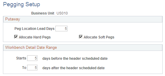

Pegging Setup Page
To set up pegging attributes at the inventory business-unit level, use the Setup Pegging by Business Unit (IN_PEG_SETUP_GBL) component.
Use the Pegging Setup page (IN_PEG_SETUP) to define pegging attributes for the PeopleSoft Inventory business unit.
Navigation:
Inventory, and then Order Pegging, and then Business Unit Setup
This example illustrates the fields and controls on the Pegging Setup page. You can find definitions for the fields and controls later on this page.
Pegging Setup page
Field or Control Description
Unit
Enter the Inventory business unit.
Peg Location Lead Days
Enter the number of lead days for pegged items in this inventory business unit. When the putaway processes receive pegged supply quantities, the peg location lead days are used to determine where to place the stock. The system adds the peg location lead days to today's date and compares the result to the scheduled ship date of the outgoing pegged demand order. If the order is within the lead days window, then the pegged supply quantity is received (putaway) into the pegged material storage location specified. If the order is not within the lead days window, the pegged supply quantity is received into the standard material storage location determined by the putaway processes.
Allocate Hard Pegs
Select to allocate any hard-pegged receipts to the outgoing demand line at the time of putaway. A hard allocation reserves stock at a specific material storage location within the inventory business unit to satisfy an outgoing order line.
Deselect this check box to reserve any hard-pegged receipts to the outgoing demand line at the time of putaway. A soft reservation reserves stock at the inventory business unit level to satisfy an outgoing order line. The specific material storage location for picking and shipping the stock is not reserved.
Allocate Soft Pegs
Select to allocate any soft-pegged receipts to the outgoing demand line at the time of putaway. A hard allocation reserves stock at a specific material storage location within the inventory business unit to satisfy an outgoing order line
Deselect this check box to reserve any soft-pegged receipts to the outgoing demand line at the time of putaway. A soft reservation reserves stock at the inventory business unit level to satisfy an outgoing order line. The specific material storage location for picking and shipping the stock is not reserved.
Workbench Detail Date Range
Enter values to determine the time window displayed on the Pegging Workbench; this is used to limit the number of rows returned in the workbench search. These values only apply to unpegged supply or demand transactions.
Starts
Enter the number of days prior to the demand line's scheduled shipment date or prior to the supply line's receipt date that should be displayed. The system subtracts the Start days from the demand or supply date and selects any supply/demand to be received/shipped within this window.
To
Enter the number of days past the demand line's scheduled shipment date or past the supply line's receipt date that should be displayed. The system adds the To days to the demand or supply date and selects any supply/demand to be received/shipped within this window.

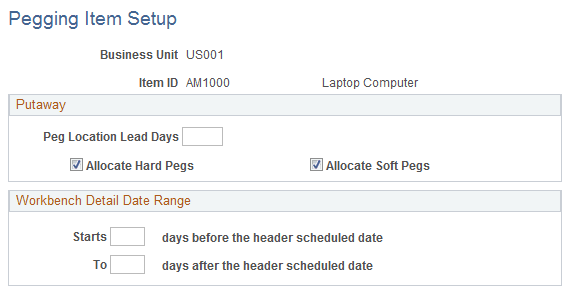

Pegging Item Setup Page
To set up pegging attributes at the item level, use the Pegging Attributes by Item (IN_PEG_IT_SETUP_GBL) component.
Use the Pegging Item Setup page (IN_PEG_IT_SETUP) to define pegging attributes for the item and business-unit combination.
This page only needs to be used if the item varies from the business-unit level setup.
Navigation:
Inventory, and then Order Pegging, and then Item Setup
This example illustrates the fields and controls on the Pegging Item Setup page.
Define pegging attributes for a particular item ID to override the same attributes at the business-unit level.
For field definitions, see the Defining Pegging Attributes for the Inventory Business Unit section above.
See Pegging Setup Page.

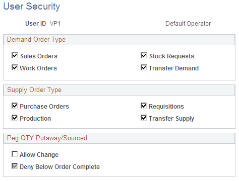

User Security Page
To set up user security for pegging, use the Pegging User Security (IN_PEG_USER_SEC_GBL) component.
Use the User Security page (IN_PEG_USER_SEC) to based on the User ID, select the type of supply and demand that the user can work with.
Navigation:
Inventory, and then Order Pegging, and then Pegging User Security
This example illustrates the fields and controls on the User Security page. You can find definitions for the fields and controls later on this page.
User Security page
This page enables you to set up pegging security by user. The user must be defined within the User Security page in order to peg demand or supply.
For each component where pegging is enabled, the system checks the user ID security setup. If the relevant order type is selected, then the system displays the link within that component. For example, if the user is in the Order Entry Form in PeopleSoft Order Management, the link Peg to Demand is available only if the Sales Orders check box has been selected for the user on the User Security page. In addition, once the link is taken, the Pegging Workbench filters the supply or demand based on the check boxes selected on the User Security page. For example, if a user can peg to all supply order types but production, then only purchase orders, requisitions, and interunit transfers would be available to peg to in the Pegging Workbench.
Demand Order Type
Select the demand side for pegging.
Sales Orders
Select to enable this user ID to peg sales orders from PeopleSoft Order Management.
Stock Requests
Select to enable this user ID to peg stock requests in PeopleSoft Inventory.
Work Orders
Select to enable this user ID to peg work orders from PeopleSoft Maintenance Management.
Transfer Demand
Select to enable this user ID to peg the outgoing interunit stock requests. Interunit stock requests in PeopleSoft Inventory are used to transfer stock from one inventory business unit to another.
Supply Order Type
Select the supply side for pegging.
Purchase Orders
Select to enable this user ID to peg to purchase orders in PeopleSoft Purchasing.
Requisitions
Select to enable this user ID to peg to requisitions in PeopleSoft Purchasing.
Production
Select to enable this user ID to peg to production IDs in PeopleSoft Manufacturing.
Transfer Supply
Select to enable this user ID to peg to interunit stock requests as incoming supply. Interunit stock requests in PeopleSoft Inventory are used to transfer stock from one inventory business unit to another.
Peg QTY Putaway/Sourced
System administrators determine which users can use the Pegging Workbench to correct input errors or reverse a peg completion. Use caution and limit the number of users who have this ability. For more information about correcting peg quantities, see the "Changing Peg Chains" section of this topic.
Allow Change
Select this check box to enable the user to change the Peg Qty Putaway/Sourced field on the Pegging Workbench.
Deny Below Order Complete
Select this check box to prevent the user from reducing the quantity in the Peg Putaway/Source field below the quantity that has already been completed on the supply transaction or demand transaction. This check box is only available if you have selected the Allow Change check box. This feature prevents the user from creating open pegged quantity that is linked to completed quantity, for example, opening peg quantity that is linked to quantity that has already been putaway.
See Changing Peg Chains.

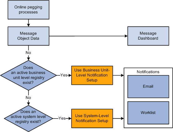

Pegging Notification Process Flow
The following diagram illustrates the process flow for notifications from online pegging processes. The online process creates a message, which is automatically sent to the Message Dashboard. If notifications are enabled in the message at the business-unit level registry or the system-level registry, then the system notifies the appropriate person using an email or a worklist entry where a link is provided to take the individual to the message detail page of the Message Dashboard:
Notifications from online pegging processes
See the product documentation for PeopleSoft Events and Notifications Framework
