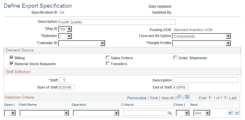

Defining Export Specifications Page
Use the Define Export Specifications page (FINT_EXP_SPEC) to define export specifications by setting up parameters for extracting demand data into files for integration to Demantra Demand Management.
Navigation:
SCM Integrations, and then Advanced Planning, and then Demantra, and then Define Export Specifications
This example illustrates the fields and controls on the Define Export Specification. You can find definitions for the fields and controls later on this page.
Use this page to define basic information about an export specification, select demand sources, and define selection criteria. Export specifications enable you define a set of data that you can export for use with the Oracle Value Chain Planning Process Integration Package (PIP).
Field or Control Description
Date Updated
Displays the last date the export specification was updated.
Updated By
Displays who updated the export specification.
Posting UOM(posting unit of measure)
Displays Standard Inventory UOM which indicates that the system uses the unit of measure defined for the item at the business unit level. Values are only retrieved for weight and volume.
Delimiter
Select the delimiter that the system uses during the integration
Values include:
  • + (plus sign).
  • –(minus sign).
  • .(period).
  • / (forward slash).
  • \ (backward slash).
  • | (slash).
Forecast Kit Option
Select whether you want to run the process using product kits. A product kit consists of a fixed set of components that are forecasted as a unit. The default value for the field is blank and will include components and product kits in the build process. The process creates a demand record for each product kit and for each component in the product kit.
Forecast kit options include:
Components: Select to include only the components in the build process. The process creates a demand record for each component in the product kit.
Product Kits: Select to include only product kits in the build process. The process creates a demand record for each product kit.
During inventory policy generation, PeopleSoft Inventory Policy Planning can react to the kits and explode product kit items into its components. The Policy Generation (DP_CALCPOLCY) process matches inventory policy items and attributes for use in the PeopleSoft Inventory system.
See PeopleSoft Inventory: Understanding Product Kits.
Calendar ID
Select a calendar to be exported and used by the integration.
See Understanding Calendars.
Weight Profile
Select the weight profile that you want to use for the export. The profile determines which dates are working and nonworking days. The system also associates weight profiles with a calendar, so the values that are available for this field depend on the calendar ID that you selected.
Demand Source
The check boxes that you select indicate that the system will include data from that source when it runs the export process.
Shift Definition
Enter shift information. This data is used to populate the Shift information text files required by the Process Integration Pack used for integrating to Demantra.
Selection Criteria
Use the grid to provide filter elements for the data subset. The feature makes it possible for you to control and filter ranges of data or types of data to be selected for export. You create the subset by establishing selection criteria for the field. For example, if you want to limit the number of items or only select data for a specific location, you can select a range of records to limit the Item Code or Location field.
Open ( (open parenthesis)
Select the open parenthesis character to signify the start of a group of criteria that you want to enclose. For example, if you have three criteria, you can create a selection criteria of (A or B) and C by placing an open parenthesis on the line for A.
Field Name
Select a field on which to filter. The system uses the field you define as the basis for further limiting data when you use the Criteria field. Fields that are available for selection are dependent on the function that you use.
Operator
Determines the action that the system applies to the criteria that you enter in the Criteria field. For example, suppose you want only item IDs that start with AA to be placed in the data file, use the = (like) operator. You should enter the correct form of the criteria to match the operation that you want the system to perform. Available operators depend on the page that you use.
Values include:
  • <: Include values that are less than the value that you enter in the Criteria field.
  • <>: Include values that are not equal to the value that you enter in the Criteria field.
  • =: Include only values that are equal to the criteria.
  • >=: Include values that are equal to or greater than the criteria.
  • BETWEEN: Include only values between the two values that you enter as criteria. This operation requires a list with values that are appropriate to the fields that are selected for string values. For example, a string might be A, B, C, and D. You enter A and D to include B and C values only. Values can include numeric strings.
  • IN: Include records that contain the criteria that you enter. This operation requires a list with values that are appropriate to the fields that are selected for string values. Values can include numeric strings.
  • LIKE: Include only values that match the value that you enter. The criteria must include at least one wildcard character. For example, you could use Apple%. This would select values starting with Apple while %Ap% would select values containing Ap.
  • NLIK: Include values that do not match this value. This option restricts values from the data subset. The value must include at least one wildcard character.
  • NOT BET: Include values that are not between the two values that you enter in the Criteria field.
  • NOT IN: Include values that are not in the range of values that you enter as selection criteria.
Criteria
Enter the value that you want the system to use when applying the operators. For example, if you select >= for an Item Code field and enter AA100 as the criteria, then the system includes only values that are equal to or greater than the criteria.
Close ) (close parenthesis)
Select the close parenthesis character to signify the end of a group of criteria that you want to enclose. For example, if you have three criteria, you can create a selection criteria of (A or B) and Cby placing an close parenthesis on the line for B.
Next
Provides a means of creating And or Or statements for the operators and criteria that you enter. Use the AND option to create additional criteria for the field. Use the OR option to create contrasting criteria.

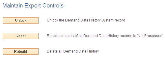

Maintaining Export Controls Page
Use the Maintain Export Controls page (FINT_DDH_CONTROL) to maintain export controls that define how the system should process demand data history.
Navigation:
SCM Integrations, and then Advanced Planning, and then Demantra, and then Maintain Export Controls
This example illustrates the fields and controls on the Maintain Export Controls page. You can find definitions for the fields and controls later on this page.
Use this page to define how the system should process demand history data when exporting data to Demantra.
Unlock
Select to unlock the demand data history record in the event of a failure or other problem. Do not use this option when the build or load processes are running.
Reset
Select to reset the status of all demand data history records to the status of not processed. You normally only use this option during system start up.
Note: This resets the status of all demand data history records to Not Processed.
Rebuild
Select to delete all demand data history records. You normally only use this option during system start up.
Note: Selecting this option deletes all demand history.

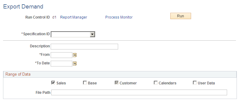

Export Demand Page
Use the Export Demand page (FINT_EXPORTDMD) to export demand to Demantra Demand Management.
Navigation:
SCM Integrations, and then Advanced Planning, and then Demantra, and then Export Demand
This example illustrates the fields and controls on the Export Demand page. You can find definitions for the fields and controls later on this page.
Export Demand page
Use this page to define run controls and initiate the Export Demand History (FINT_DMD_EXP) process.
Specification ID
Select an export specification. An export specification defines the demand history data set that you want to export for use with the integration to Demantra Demand Management.
Edit Export Specification
Click to access the export specification that you selected to use with this run control. Using the page, you can make updates to specifications to refine the demand history data to use with the export process.
From andTo Date
Select the date range from which to include demand history data for this export process.
Sales, Base, Customer,Calendars, and User Data
Select which data to export from PeopleSoft. Selecting any check box also creates a number of empty xml files required by the integration.
  • Select the Sales check box to create the SalesOrderHistory.txt file.
  • Select the Base check box to create the Base.xml file.
  • Select the Customer check box to create the Customer.xml file.
  • Select the Calendar check box to create the Calendar.txt file.
  • Select the User Data check box to create the ShiftInformation.txt, ShiftInformationDetails.txt, and StandardUOMConversions.txt files.
File Path
Enter the location where you want the export Integration files to be created.
