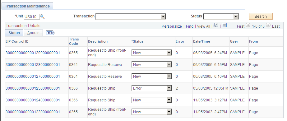

Transaction Maintenance Page
Use the Transaction Maintenance page (BCT_CTL_UPD) to view all electronic transactions in the transaction log and access the detail pages that enable you to correct transaction errors.
Navigation:
SCM Integrations, and then Transaction Error Handling, and then Maintain Transactions, and then Transaction Maintenance
This example illustrates the fields and controls on the Transaction Maintenance page. You can find definitions for the fields and controls later on this page.
All transactional-based information appears on this page. The system displays the transaction code, which identifies the transaction type, and the transaction description.
Field or Control Description
EIP Control ID
Click this link to view the transaction line details for the transaction. Detail pages for each transaction type, which are accessible from this page, provide error messages and transaction details that enable you to revise fields containing errors.
You can modify the transaction status here or in the Transaction Maintenance Detail pages. The rules for changing a transaction status are:
Current Status Change to Status
New
Complete (cancels all lines in the transaction).
Error
Reprocess.
Complete
Can't be changed.
In Process
Can't be changed.
Reprocess
Incomplete
Can't be changed.

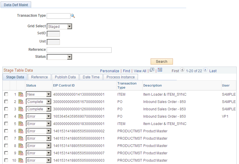

Data Def Maint Page
Use the Data Def Maint page (EO_EIP_CTL_MAINT) to view data detail or correct errors for inbound EIPs that contain data rather than transactions.
Navigation:
SCM Integrations, and then Transaction Error Handling, and then Maintain Data Definitions, and then Data Def Maint
This example illustrates the fields and controls on the Data Def Maint (page). You can find definitions for the fields and controls later on this page.
All data definition transactions appear on this page. Detail pages for each transaction type, which are accessible from this page, provide error messages and transaction details that allow you to revise fields containing errors.
If you want to retrieve records by transaction, select one of these transaction types:
Transaction Type Description
AP - 100
Retrieves supplier synchronization transactions that have been received. To receive supplier synchronization transactions, you must have PeopleSoft Payables installed.
AP - 200
Retrieves supplier edit transactions that have been received. To receive voucher edit transactions, you must have PeopleSoft Payables installed.
ASNIN
Retrieves advanced shipping receipt transactions that have been received. To receive Advanced Shipping Receipt transactions, you must have PeopleSoft Purchasing installed.
BOM
Retrieves bills of material transactions that have been received. To receive bills of material transactions, you must have PeopleSoft Manufacturing installed.
CONSUMER
Retrieves consumer sync transactions that have been received. To receive consumer sync transactions, you must have PeopleSoft Inventory installed.
ITEM
Retrieves item loader and item sync transactions that have been received. To receive item loader and item sync transactions, you must have PeopleSoft Inventory, PeopleSoft eProcurement, or PeopleSoft Purchasing installed.
ITM_MFGGPO
Retrieves manufacturer group purchasing organization (GPO) item price list transactions that have been received. To receive manufacturer GPO item price list transactions, you must have PeopleSoft Purchasing or PeopleSoft Inventory installed.
PO
Retrieves purchase order transactions that have been received. To receive inbound sales order (850) transactions, you must have PeopleSoft Order Management installed.
POACK
Retrieves purchase order acknowledgement transactions that have been received. To receive purchase order acknowledgement transactions, you must have PeopleSoft Purchasing installed.
POCHG
Retrieves purchase order change transactions that have been received. To receive sales order change (860) transactions, you must have PeopleSoft Order Management installed.
PROCARD
Retrieves procurement card transactions that have been received. To receive procurement card transactions, you must have PeopleSoft Purchasing or PeopleSoft eProcurement installed.
PRODUCTMST
Retrieves product master transactions that have been received. To receive product master transactions, you must have PeopleSoft Order Management installed.
REQLOAD
Retrieves requisition loader transactions that have been received. To receive requisition loader transactions, you must have PeopleSoft Purchasing or PeopleSoft eProcurement installed.
RFQ
Retrieves request for quotation (RFQ) transactions that have been received. To receive inbound request for quote (840) transactions, you must have PeopleSoft Order Management and PeopleSoft Purchasing installed.
RFQRESP
Retrieves RFQ response transactions that have been received. To receive RFQ response transactions, you must have PeopleSoft Purchasing installed.
RMALOAD
Retrieves inventory RMA transactions that have been received. To receive RMA load transactions, you must have PeopleSoft Inventory installed.
Grid Select
Some transactions are loaded into staging tables while others remain in the Integration Broker queue until they are successfully processed. Select Queue to view those residing in the Integration Broker queue and Staged to view those that are in a stage table.
Search
Click this button to display all the transactions that match the search criteria selected.
Note: To display all of the records in the transaction log, leave the search criteria fields blank.
Show Detail Entry icon
Click the Show Detail Entry button to access the detail pages. Detail pages for each transaction type, which are accessible from this page, provide error messages and transaction details that enable you to revise fields containing errors.
